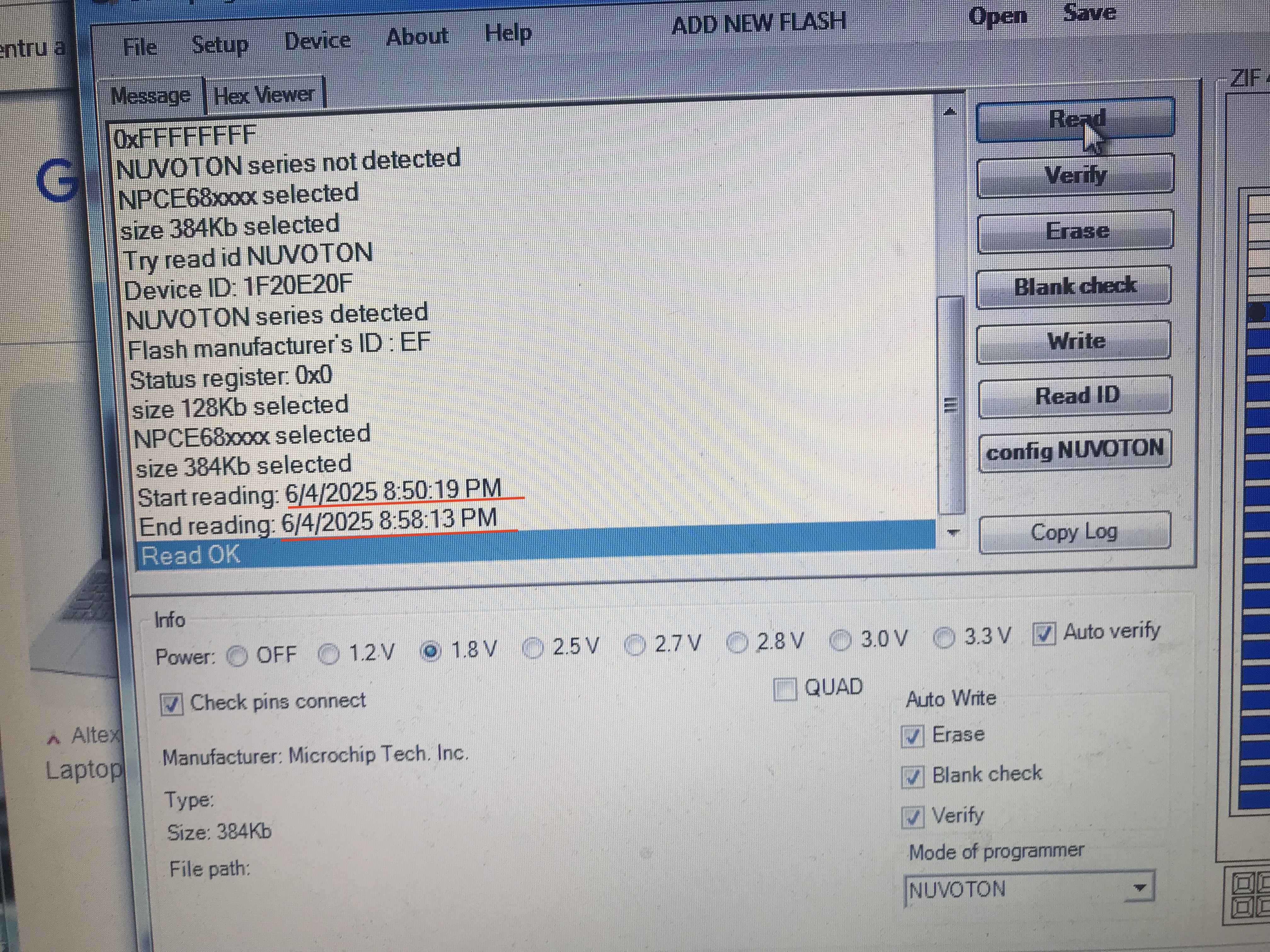

                          How did you solve the problem reading NPC?
                          • Stefan Steff
                            • Mar 2024
                            • 410
                            • Romania
                            #114
                            In my case re-seating the 32x0.5mm flat cable on the KBC connector side solved the problem...happened on many Lenovos (even if 1st pin is beeping right!!!)
                            Tried for at least 6-7 times until I get the real reading...took approx. 1 minute to read 254kb flash.
                            The writing part take no time...a blink of an eye and get programmed.
                            • volinakis
                              • Jan 2021
                              • 2876
                              • N/A
                              #115
                              thanks, I think for L14 gen2 is 384Kb (NPC68B) , mine took like 8 minutes to read 384Kb and all was "1F 1F"
