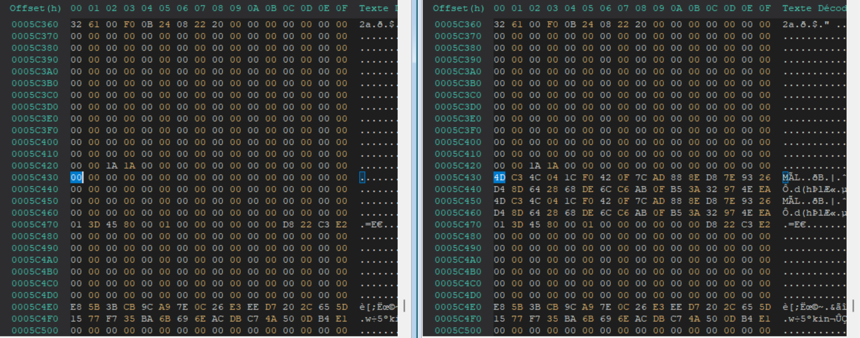

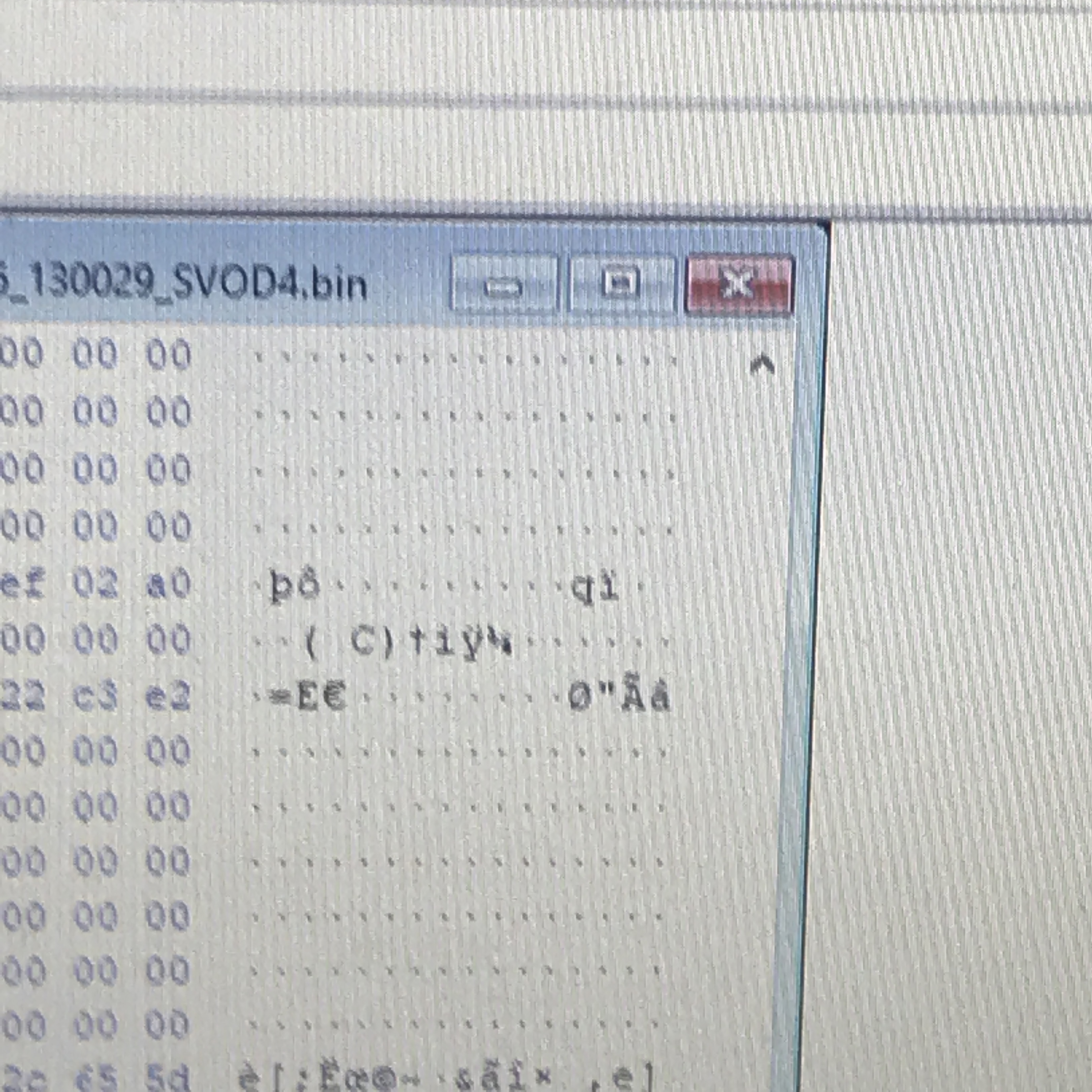

    Need unlock LENOVO L14 GEN 2 NUVOTON NPCE68 (read with SVDOD4)
    SN: PF-41D8TQ
    TYPE: 20X8-S1UF00​
    I read it in size 128. 256

      [QUOTE=adamgouadma;n3323486]Need unlock LENOVO L14 GEN 2 NUVOTON NPCE68 (read with SVDOD4)
      I read it in size 128. 256 [QUOTE]
      read 384Ko

          try

            t
            ry
            It didn't work
            The Lenovo sign comes on and then turns off

              #66
              [QUOTE=Maxpower3;n3323562][QUOTE=adamgouadma;n3323551]
              try
              I handled it this way, thank you

                #67
                Cliquez sur l'image pour la voir en taille r?elleà  Nom : 		image.pngà Affichages :	0à Taille :		539,1 Koà ID : 			3323677
                I forgot to clean 1A1A at 5C420, twice in the file​ another 5D420
                EC PWD eeprom location
                NCPE68B
                Dmi start from 0x5C120 and 0x5D120
                Pwd 0x5C420 - 0x5C56F and 0x5D420 - 0x5D56F replace with 00
                NCPE288/388
                Dmi start from 0x30000
                Pwd
                0x36000 - 0x3604F
                0x36080 - 0x360CF
                0x36100 - 0x3614F
                0x36180 - 0x361CF
                0x36200 - 0x3624F
                0x36280 - 0x362CF
                0x36300 - 0x3634F
                0x36380 - 0x363CF
                0x36400 - 0x3644F
                0x36480 - 0x364CF
                0x36500 - 0x3654F
                0x36580 - 0x365CF
                0x36600 - 0x3664F
                0x36680 - 0x366CF
                replace with 00
                Mec1663 Dmi start from 0x00
                Pwd 0x300 - 0x34F replace with FF
                search for this shape
                Click image for larger version Name:	ec pwd.png Views:	0 Size:	310.0 KB ID:	3237274
