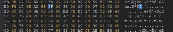

                          Thanks for response!
                          With this one I get boot but computrance is there [/QUOTE]
                          or retry with status invalid
                          for test
                          • gabo5x
                            • Dec 2022
                            • 18
                            • Brazil
                            #133
                            Originally posted by SMDFlea
                            try these
                            With this I get nothing... not even orange light
                            Sorry, can you explain how I do the 'invalid status' thing?
                            Thanks!
