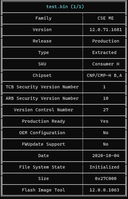

    Hi
    I programmed the bios with a dump to try to fix a keyboard problem (the problem was the keyboard ITE controller). Not being a bios problem, I wanted to use the original bios file instead of the dump by doing a clear me first but MEanalyzer returns an error "File does not contain an intel engine firmware". So I wanted to leave the non-original dump but since it had a startup delay I tried a clear me but the file read with a programmer returns the same error as the original. The dumps before being programmed are regularly read with meanalyzer.
    GX501GI from board = working bios read from motherboard
    GX501GI orignal = original bios dump
    GX501GI bios test = a working dump from internet

    Here's your Clean Bios, try it.
    The other 2 files have no ME Region nor Bios Region (only Flash Descriptor), I think your read the chip in a wrong way.
    I don't know if you have lost your Original Bios or there is still a chance.

      Seem like the bios chip is losing data, or your programmer is failing for some reason, the backups are corrupt,mostly all FF`s
