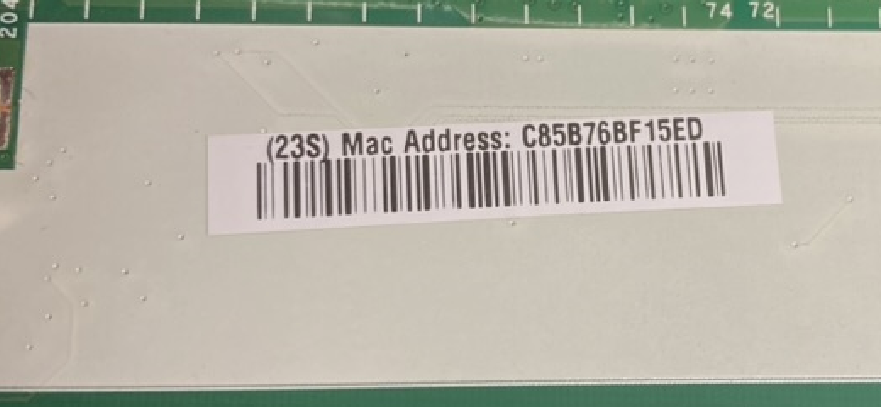

        Is there a sticker on the motherboard with the MAC address on it

              The sticker is under RAM1.

                Ok, assuming we have original MAC address, what could I try to fix the LAN issue?

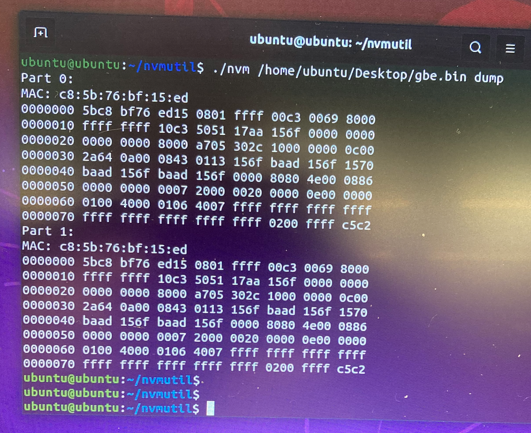

                Edit GBE_region.bin and replace whatever MAC in it with the machine's original one, then rebuild bios?

                                Both dumps have a ME 11 Corporate LP with Power Down Mitigation while the original dump from the threadowner and the updates from Lenovo have a NPDM ME.
                                The solution for the threadowner was the ME config from his own dump which had a different port for the GbePCIePortSelect- see attached pic (and a repaired bios region).
                                The mentioned differences may be OK if there was a change in mainboard config at a point, but since there's a wrong ME version, OEM ID removed from ME config that's clearly a file that's been fiddled with already..
                                Try the attached firmware, I took the FD and ME from threadowners cleaned image together with your 'own' GbE and bios region.
                                (GbE should have the correct MAC since it gets written into ME when initializing ME for the first time, so I don't know what might happen when ME is initialized with a wrong/different MAC address.)
                                EDIT: Seems there were some more L460 stuck in bios updates at the same point. Hope it's allowed to link to another forum, here's more detailed what was done: https://winraid.level1techs.com/t/le...mp-flash/92774

                                    P.S. Working fine with any MAC...On the sticker I have C8:5B:76:C8:E1:9F and the BIOS shows 50:7B:9D:EF:2C:02
                                    I wonder- did you really use the dump in 2.zip from #16 here or the dump from the winraid thread?

                                        OK, then it's consistent, that's simply the MAC from the GbE as it's supposed to be.
                                        You can replace the MAC in GbE (both at 0x1000 and 0x2000) with your own MAC from the sticker. There's a checksum in the GbE but afaik it doesn't need to be corrected for normal use.
