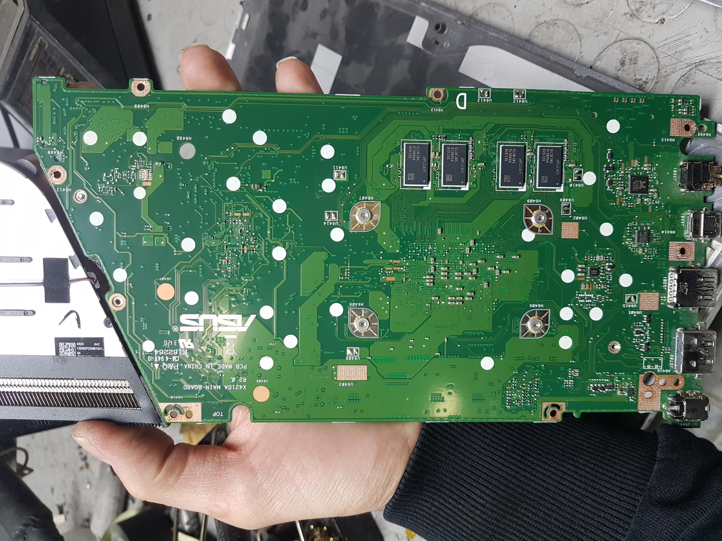

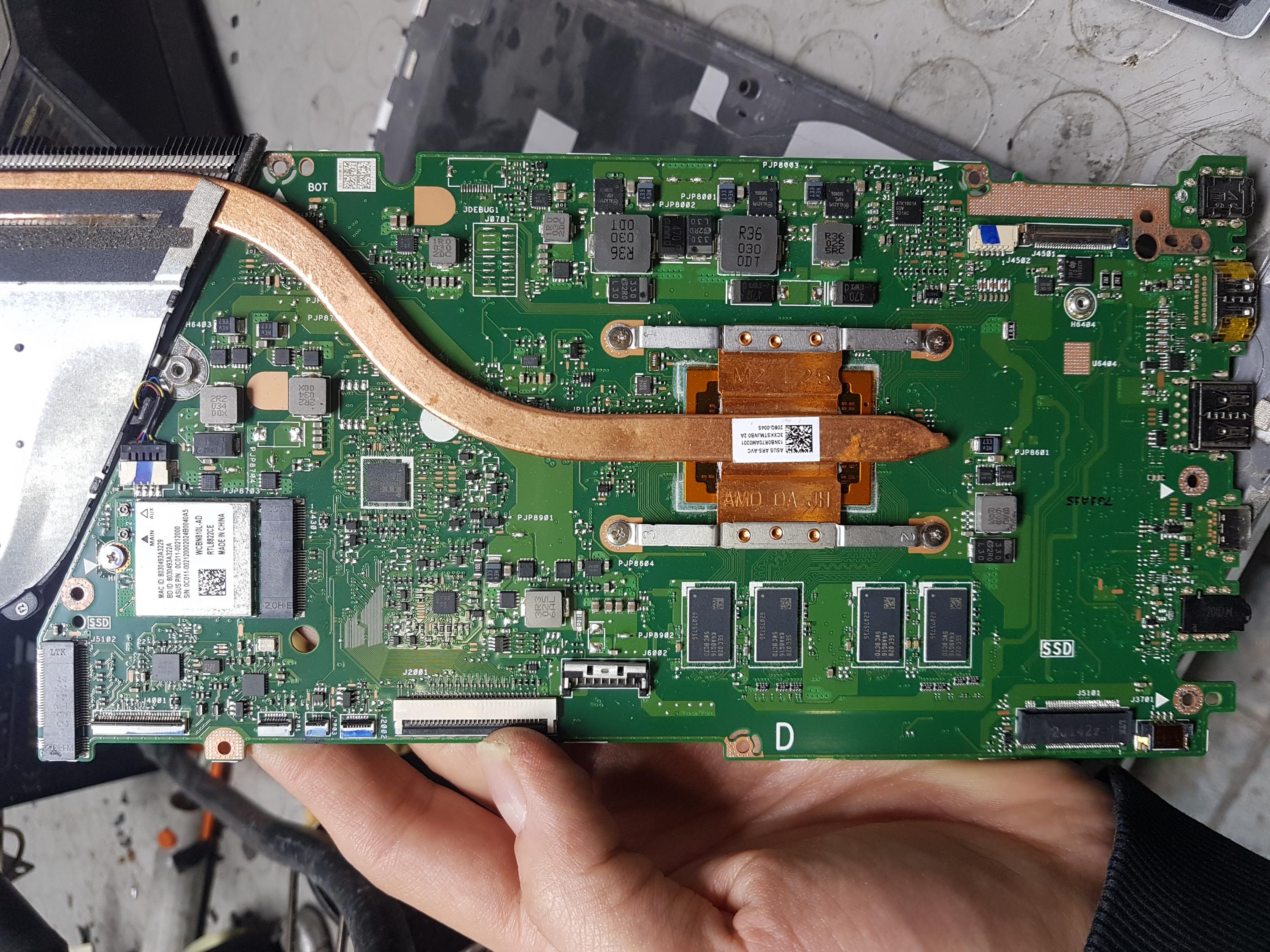

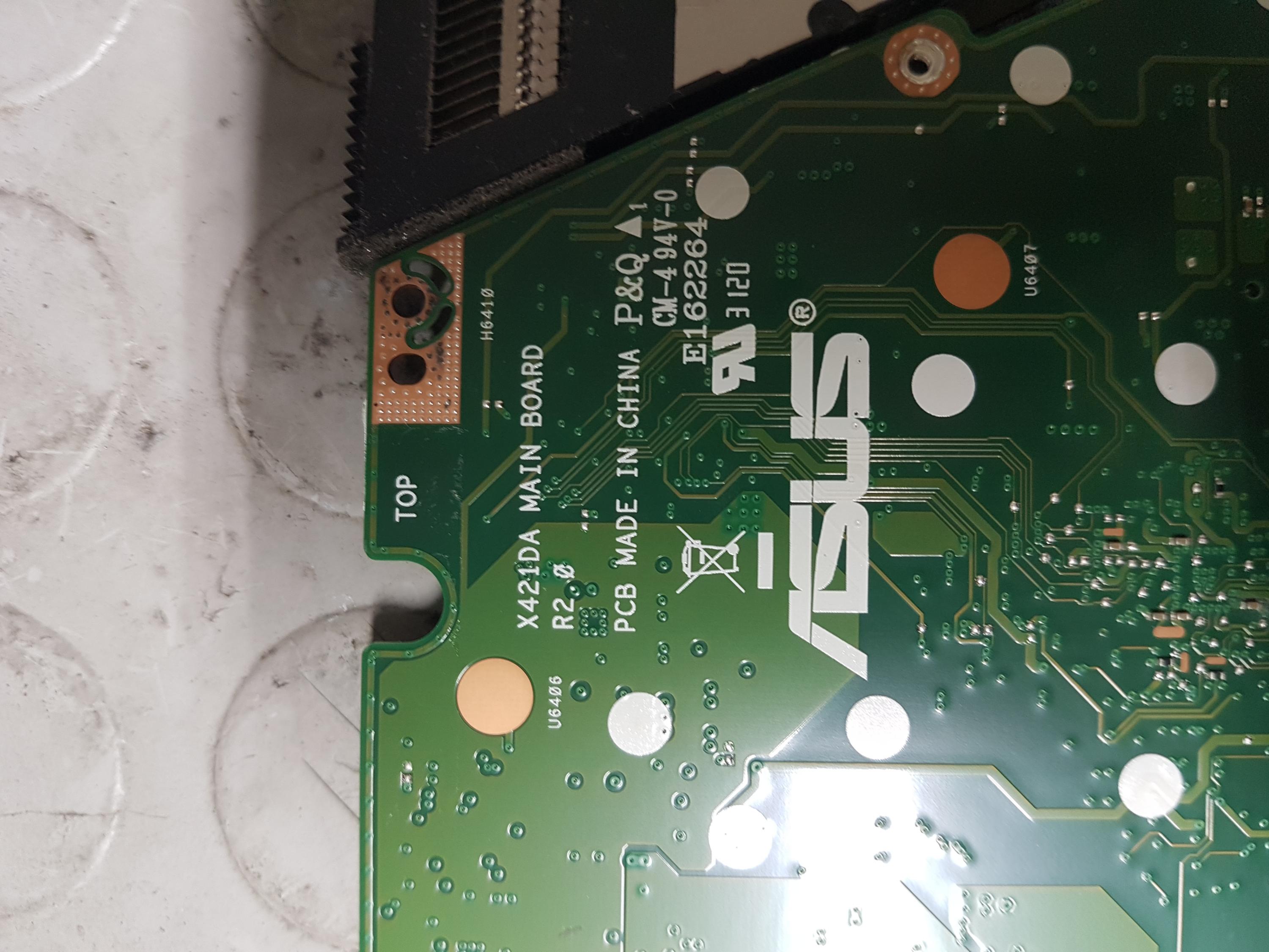

    Need asus m433d bios dump
    no screen.
    motherboard code x421da rev 2.0

    Re: Need asus m433d bios dump
    Originally posted by bilen
    no screen.
    old dump :
    Model Number: M433DA-HM247T.
    Serial Number: L9N0CX03J096377.
    If the previous information are identical with yours, you should have another Bios chip and you must upload it too. It could be 4M (32Mbit).
      no there is no other bios chip.
      device with a built-in amd gpu this is not possible.
      The serial number and other information are deleted from the bottom of the safe, I can't read it.

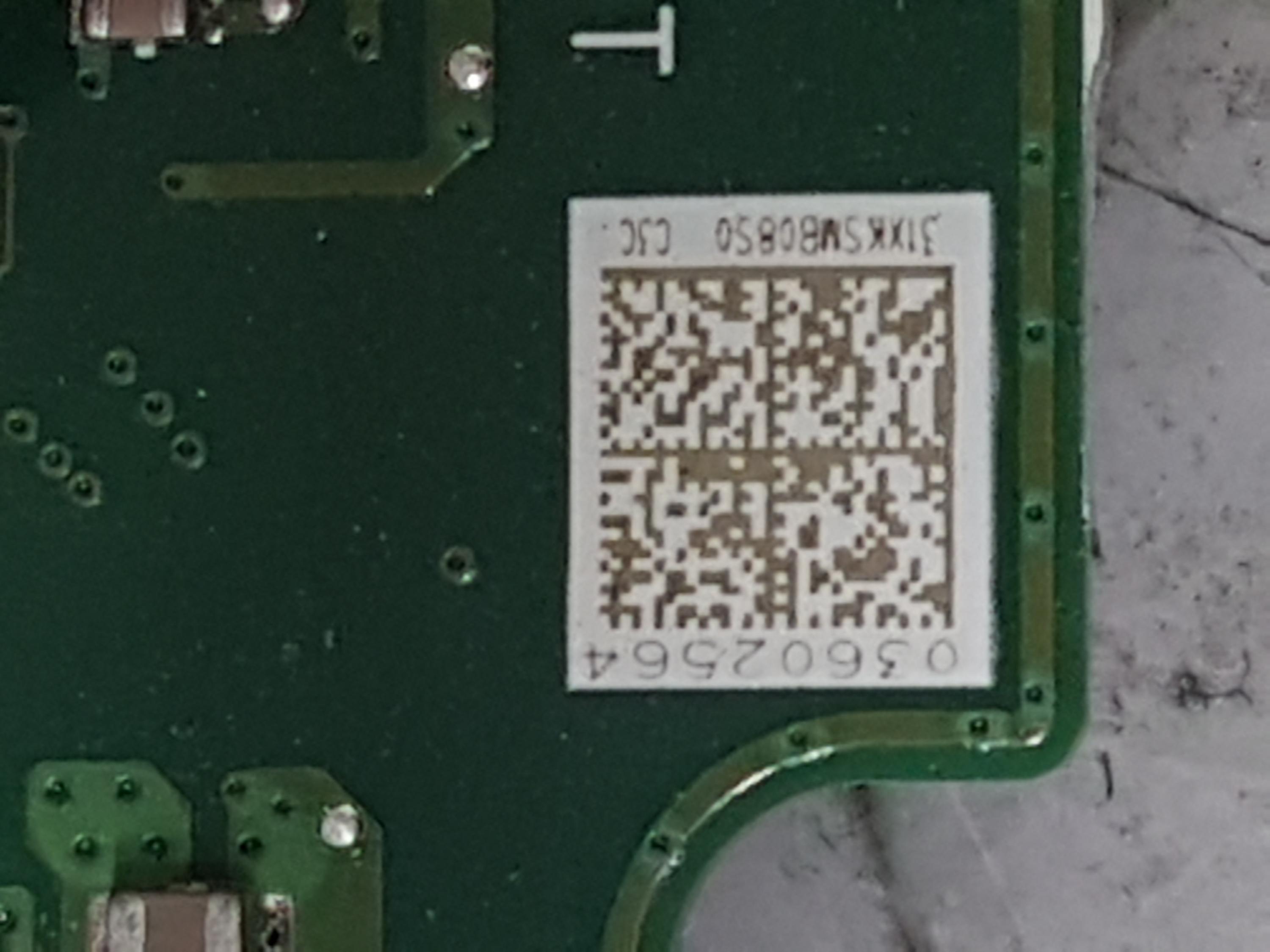

        Its an AMD bios,they are usually smaller in size than intel bios, DMI starts at 21000 .The QR code sticker doesn`t have the model number on it and its not on a barcode sticker either,you can get the update/full image from asus support https://www.asus.com/supportonly/m433da/helpdesk_bios/
