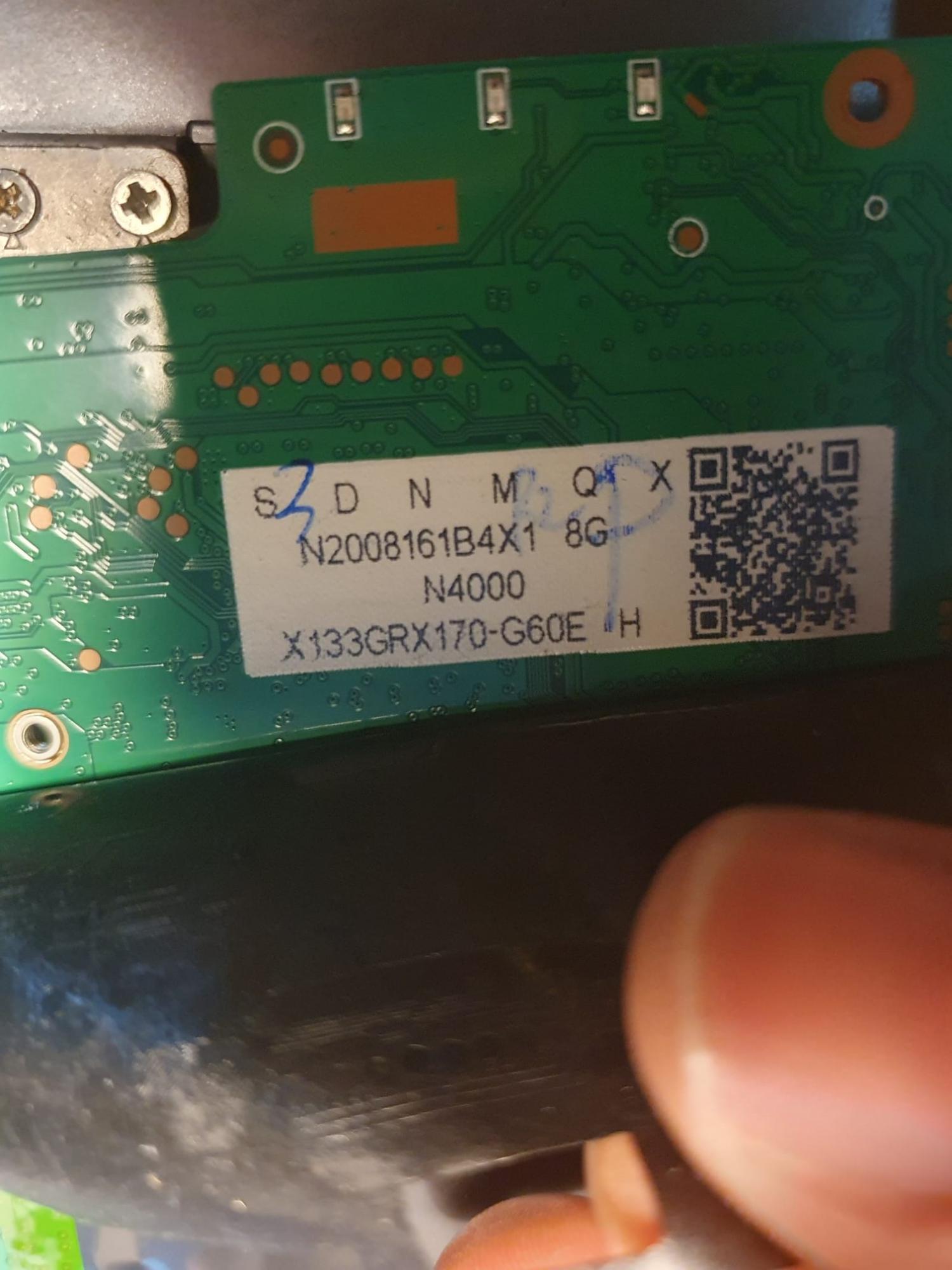

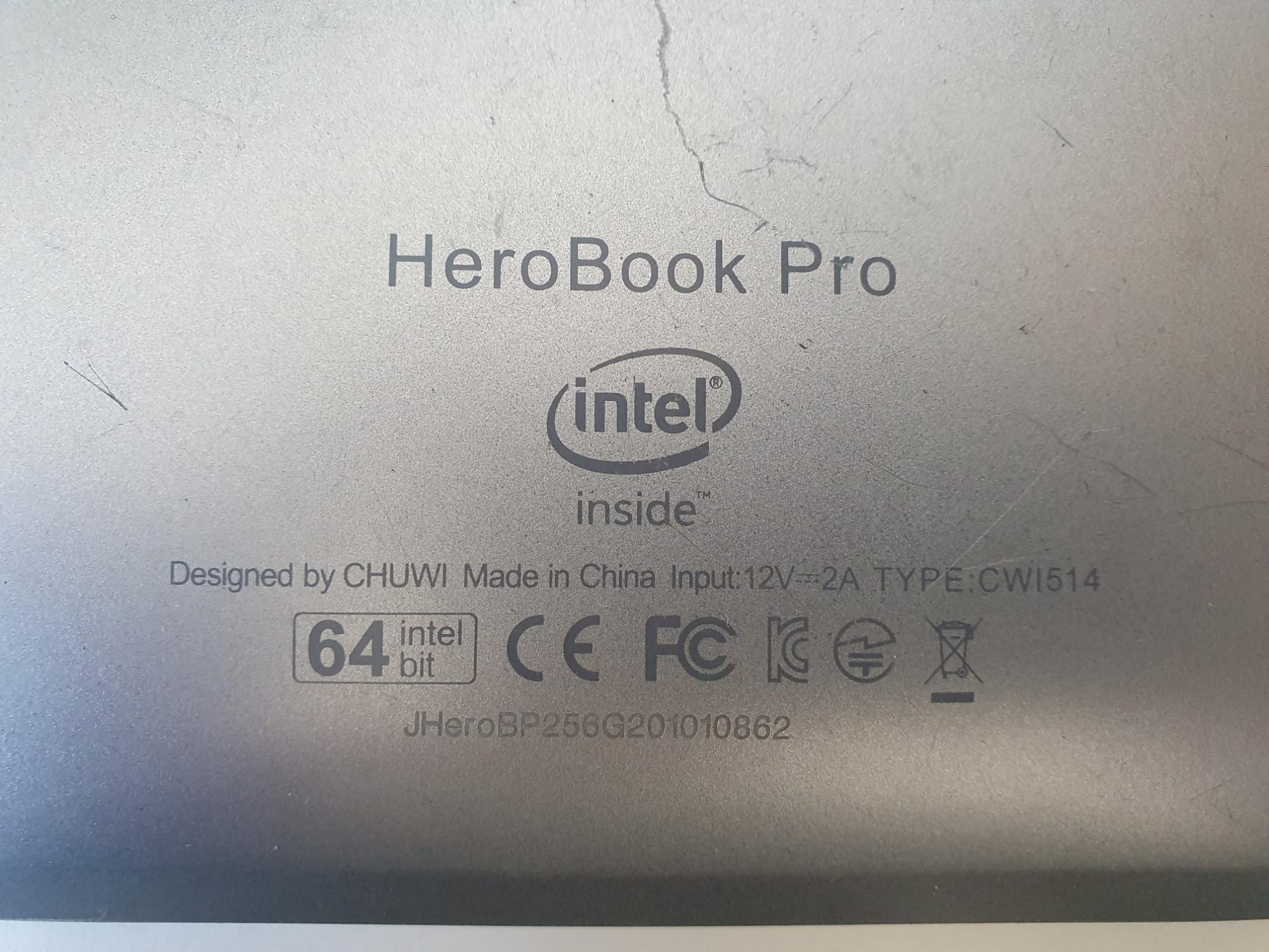

    Hi everyone,
    I have a Herobook Pro JHeroBP256G201010862, the motherboard is X133GRX170-G60E.
    When i turn on the laptop there is a bios password request, someone can help me? I need or a bios dump or a bios unlocked
    I attached some photo and also the bios locked
    Thanks so much

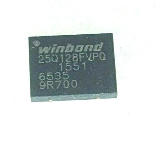

          As you can see in the Images, your chip should be one of those Packages.

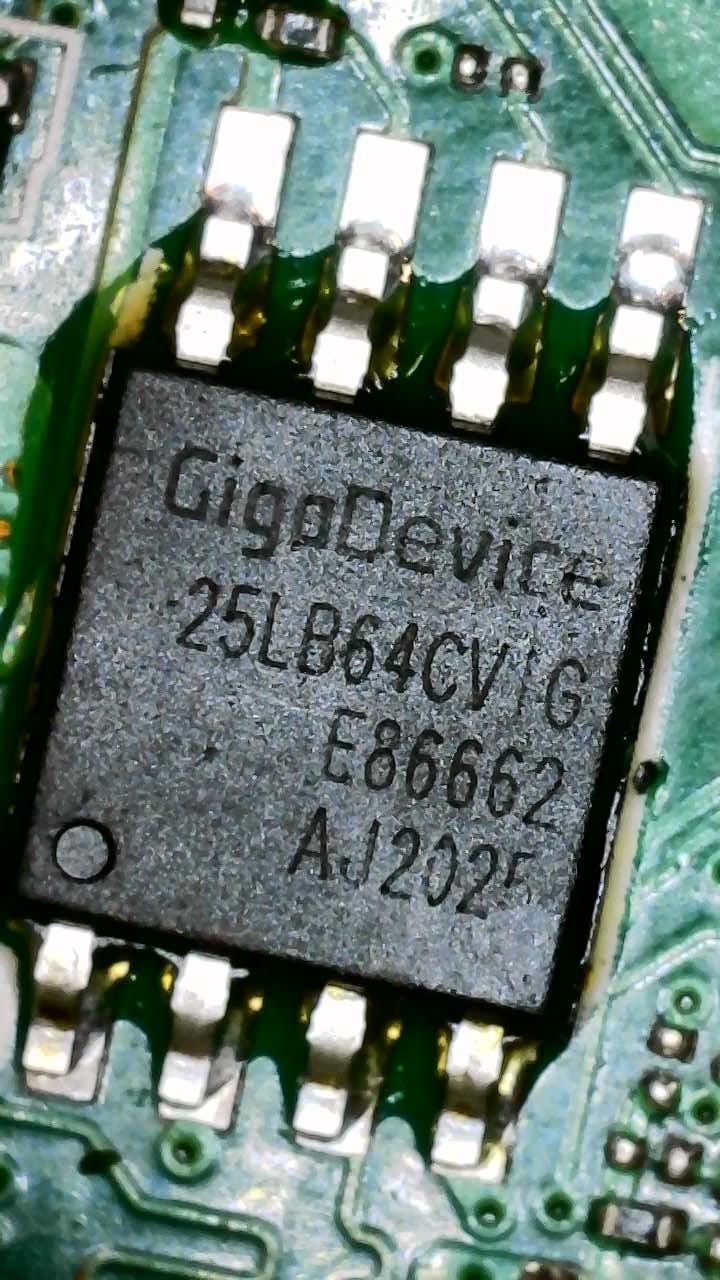

            Hi, Thank you so much for the answer, i have found the chip GigaDevice 25LB64CV (image attached) but i can't read it with ch341a, i think it isn't supported chip, it isn't in ch341a list
              It's a 1.8V Chip as mentioned in the datasheet, you need to use an adapter with the CH341A. I don't know if the Programmer support that chip or Not, also it's better to Desolder the chip (Don't use a clip).
                Hi, yes i have used the adapter 1.8V for the ch341a and i have desolder the chip but it don't work, i will try with XGecu T48, the chip is in the device support list of the T48 programmer

                  Hi guys, finally i have read the bios correctly with the new programmer, i hope some one can help me to unlock the bios password
                  Thanks to everyone

                    Here's your Unlocked Bios, hope it works fine.
                    Note: Your Backup was 3KB (C00h) Larger.

                      Sorry for the delay in my reply, today i have flashed the bios, it's work fine, thanks so much cheers:
