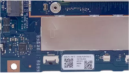

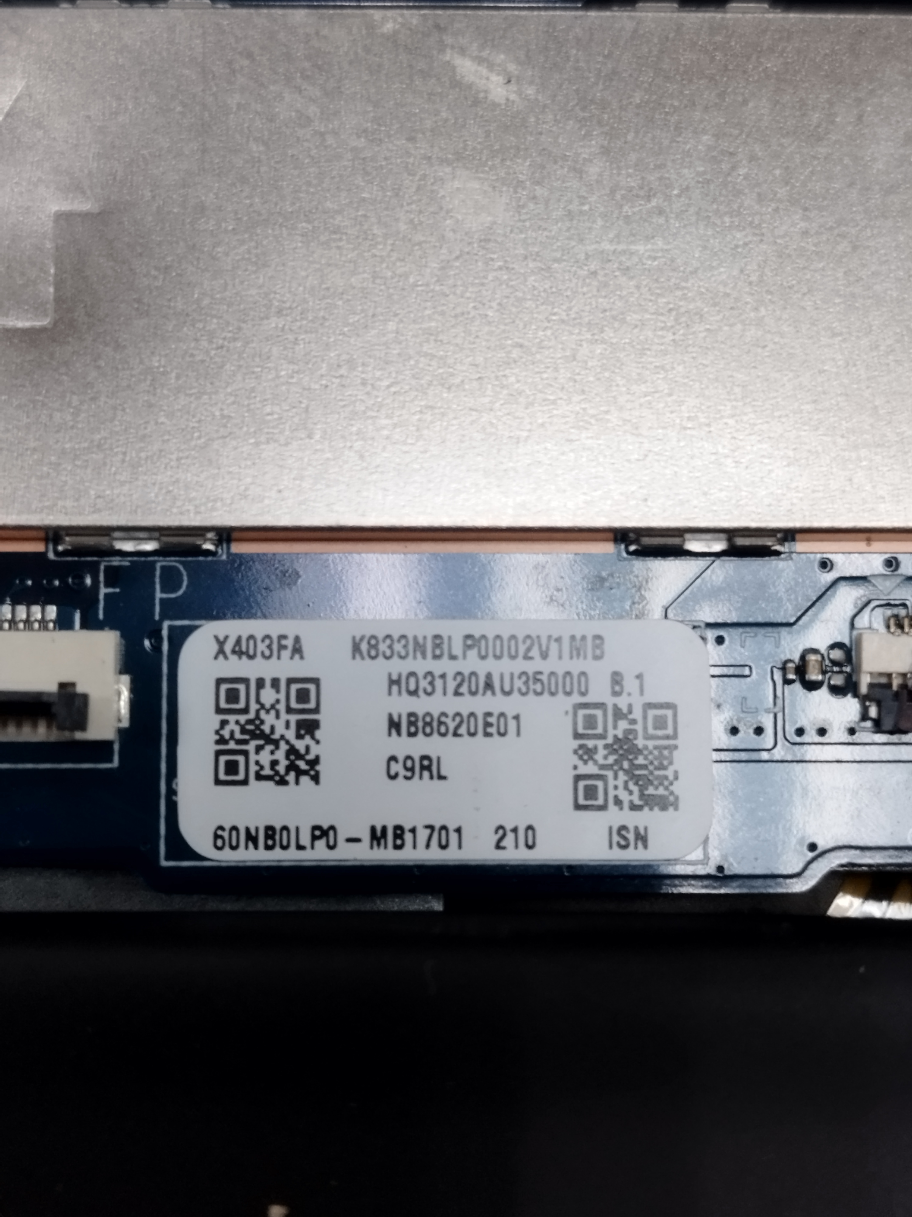

                Post a good clear picture of the white QR code label on the motherboard, below the metal ram cover

                        • peste
                          • Dec 2016
                          • 13806
                          • ROMANIA
                          Re: asus X403FA rev:2.1 bios
                          Originally posted by qonma
                          original bios
                          x403fa rev 2.1
                          please help
                          read this..
                          post the s/n, clear pictures with white stickers from the ram memory area...

                              • 22170
                              Originally posted by Bryan1892
                              hello everyone please help me this bios
                              x403fa revision 2.1
                              the laptop has no sign of light years that not used maybe a frozen bios
                              thank you appreciate your effort
                              Please type the serial number that is on the base cover sticker
