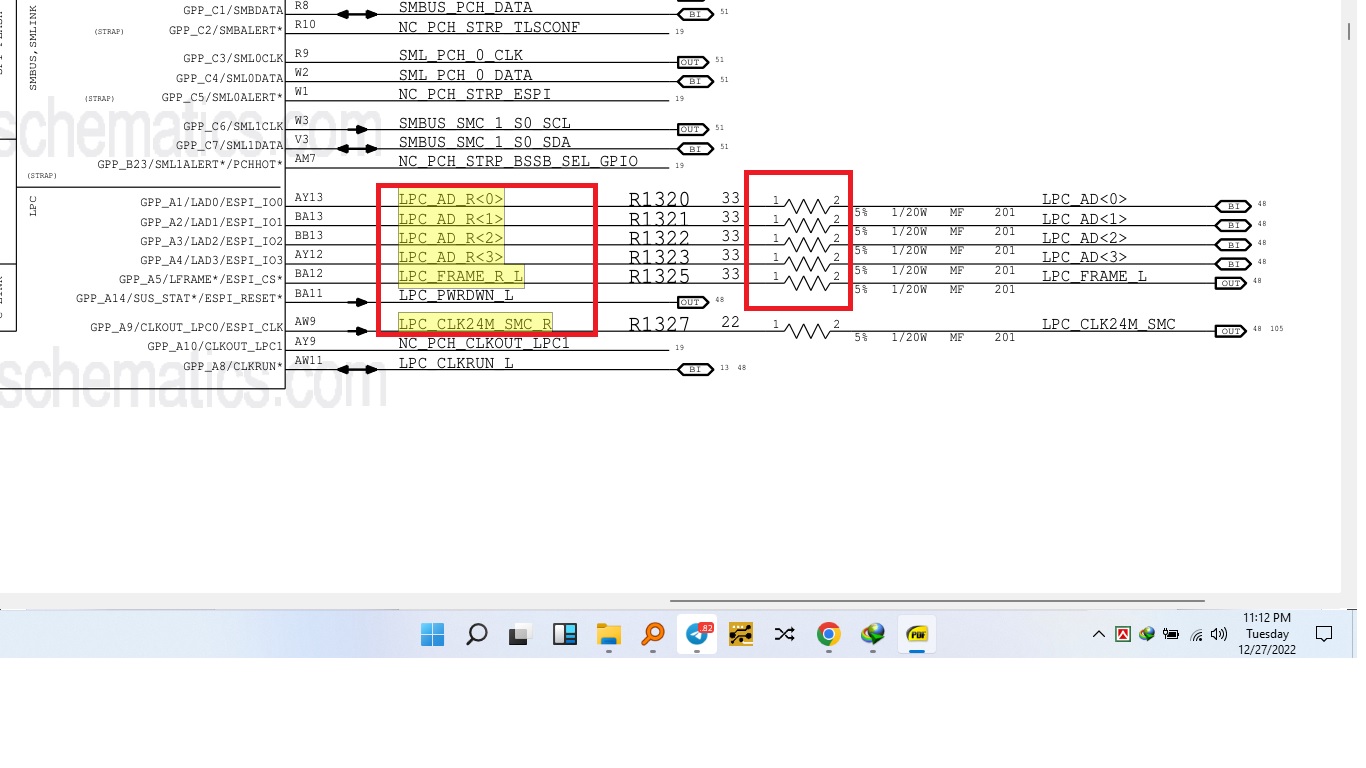

                  Check the LPC Reset and lpc fram and also lpc clock,thouse are responsible no display
                  • Stevie_belfast
                    • Jan 2015
                    • 23
                    • United Kingdom
                    Re: MacBook Pro 820 00923-A seems to boot but no activity
                    LPC reset, can't find it?
                    LPC_FRAME_R_L = 3.3V
                    LPC_CLK24M_SMC_R 1.6V
