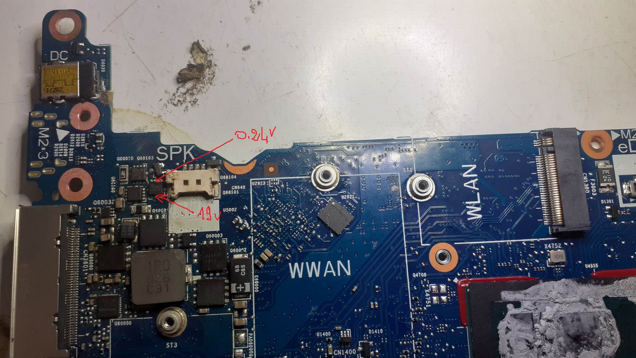

    hi!
    hp 830 g5 no power no led
    i can't find schematic or boardview
    no short
    i tried to change all power mosfets but i always get 0.24v .

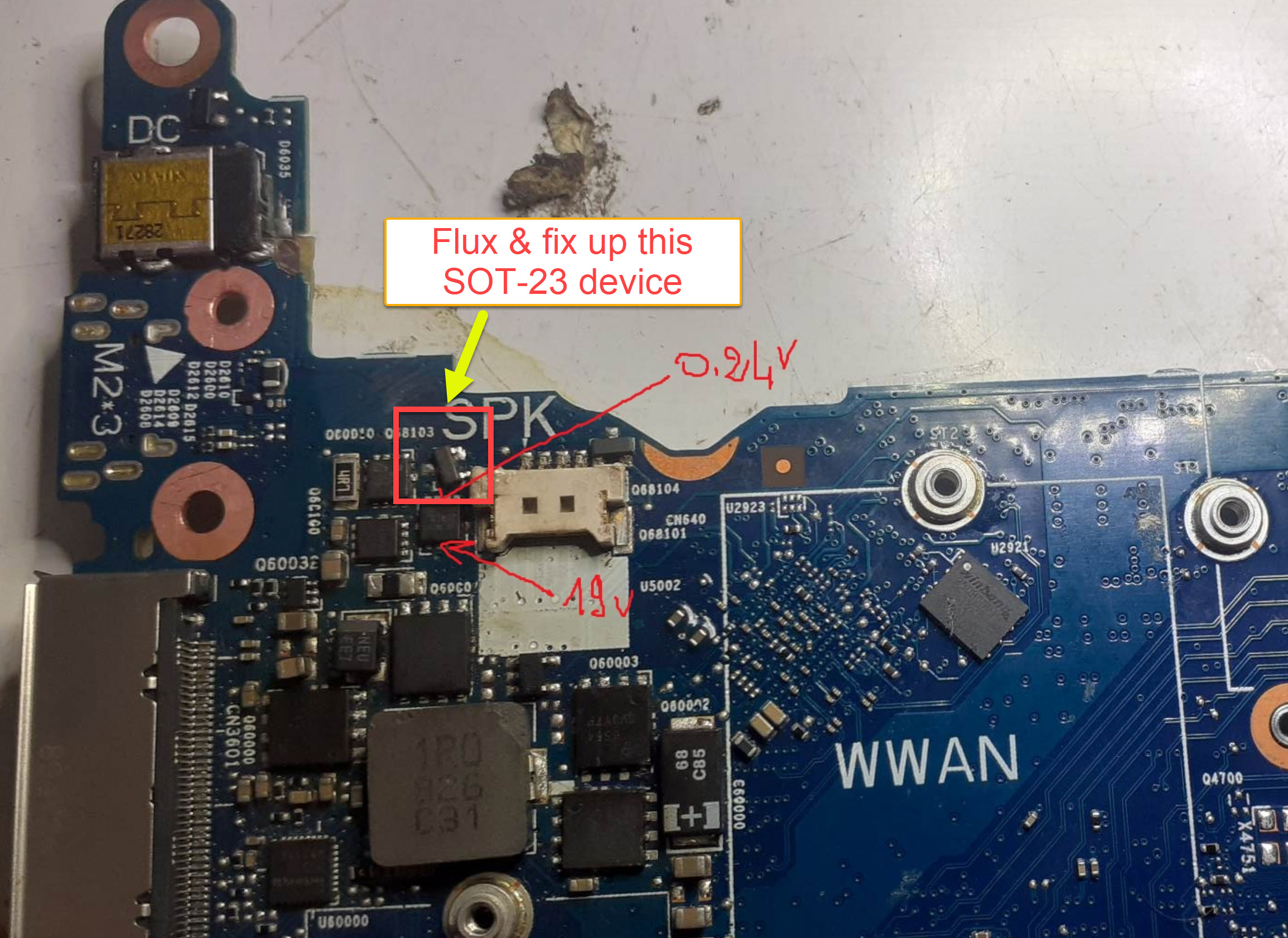

    Re: hp 830 g5 no power
    See attached. Fix up the SOT-23 device so it is properly on the logic board.
    1) What are the topside markings on this mosfet ?
    2) which charger IC is onboard this logic board ?
    3) Share all white silk screened markings on the logic board. Could not find anything in my schematic database with '830'.

      the SOT-23 i fix it i touch it when i change the mosfet .
      1- 21307 p channel mosfet
      2-i can't find it .

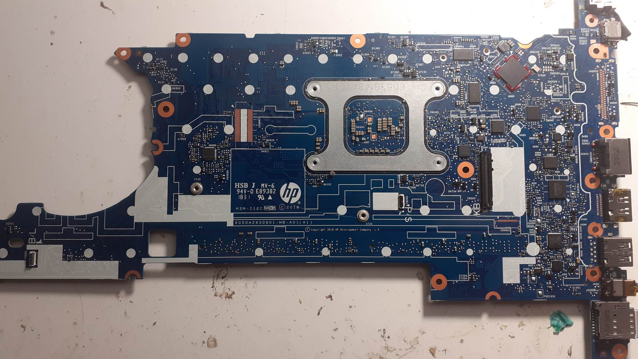

      3-motherboard number 6050A2930901-MB-A01 .

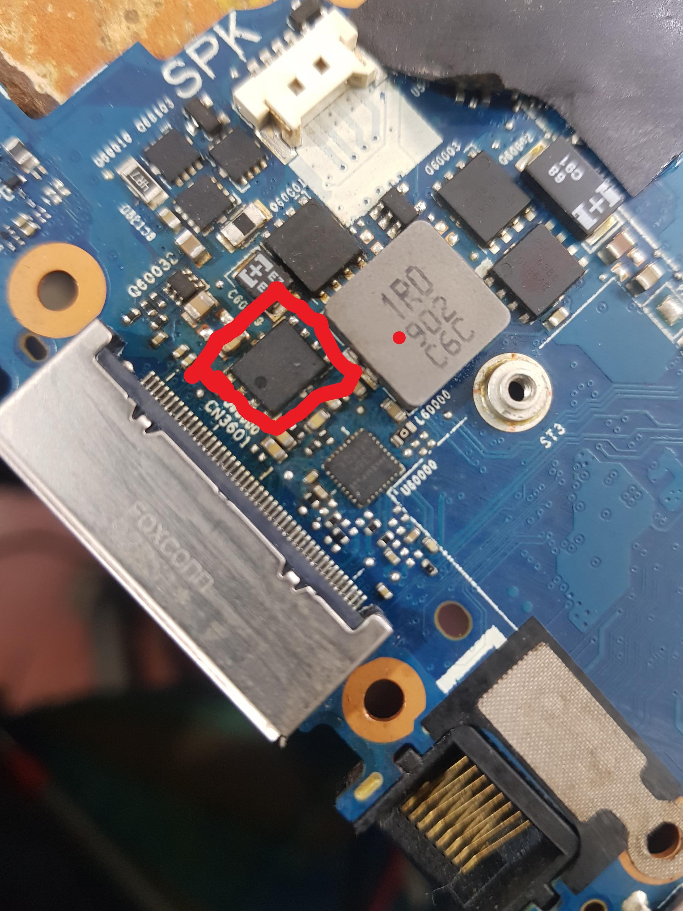

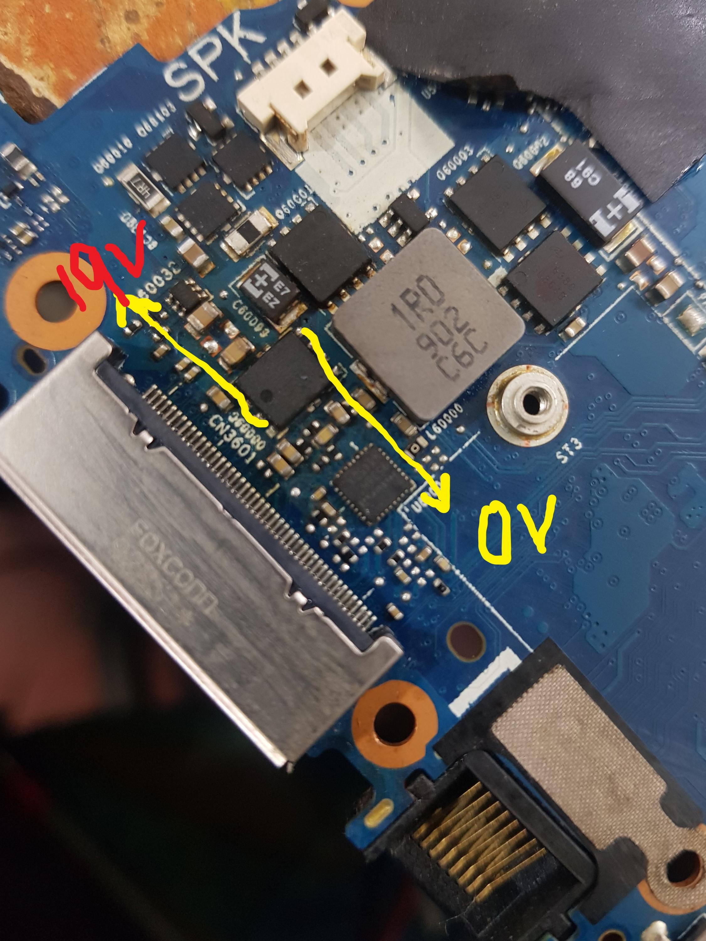

          This laptop does not power on, voltages as attached in the pictures below. Behind mosfet Q6000 I have 19v, 0v if measured in front(3 leg and gate), if i short the mosfet the laptop turns on, I have changed the mosfet it works fine on a different motherboard, I have also changed the charging ic intersil 9538h, same result. No short to ground exists within the same mosfet what could be the issue.
          • mcplslg123
            • Jun 2015
            • 7262
            • india
            ACOK status?
