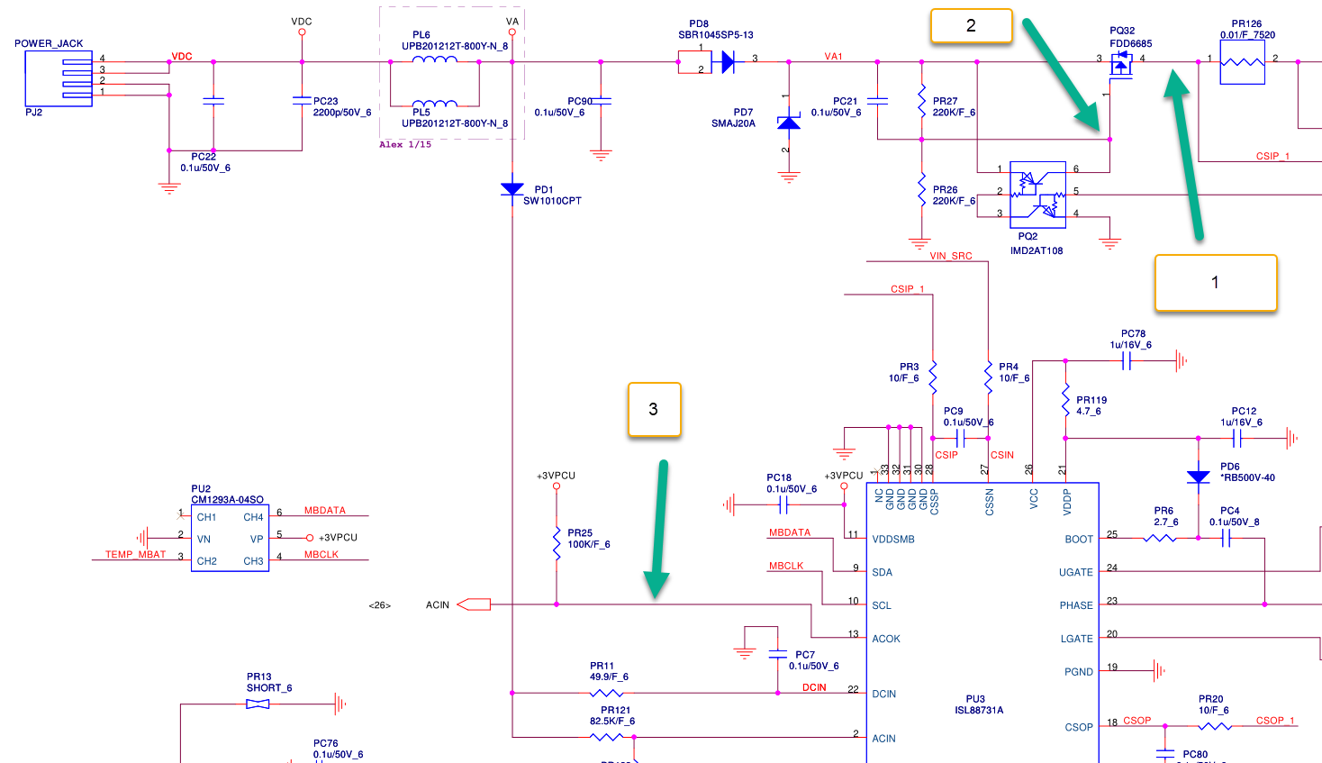

      Re: Motherboard DA0ZQ1MB8D0 Rev. D no turn on
      See attached. Measure the voltage to ground of these 3 points of interest. Post each reading.
        1 - 0V
        2 - 3.34V
        3 - 3.35v
        • mon2
          • Dec 2019
          • 14664
          What is the voltage to ground of VA and VA1 points ?
              Remove all power. Measure the resistance to ground of pin #4 of PD32. If the resistance is not low, then consider to replace PD32.
