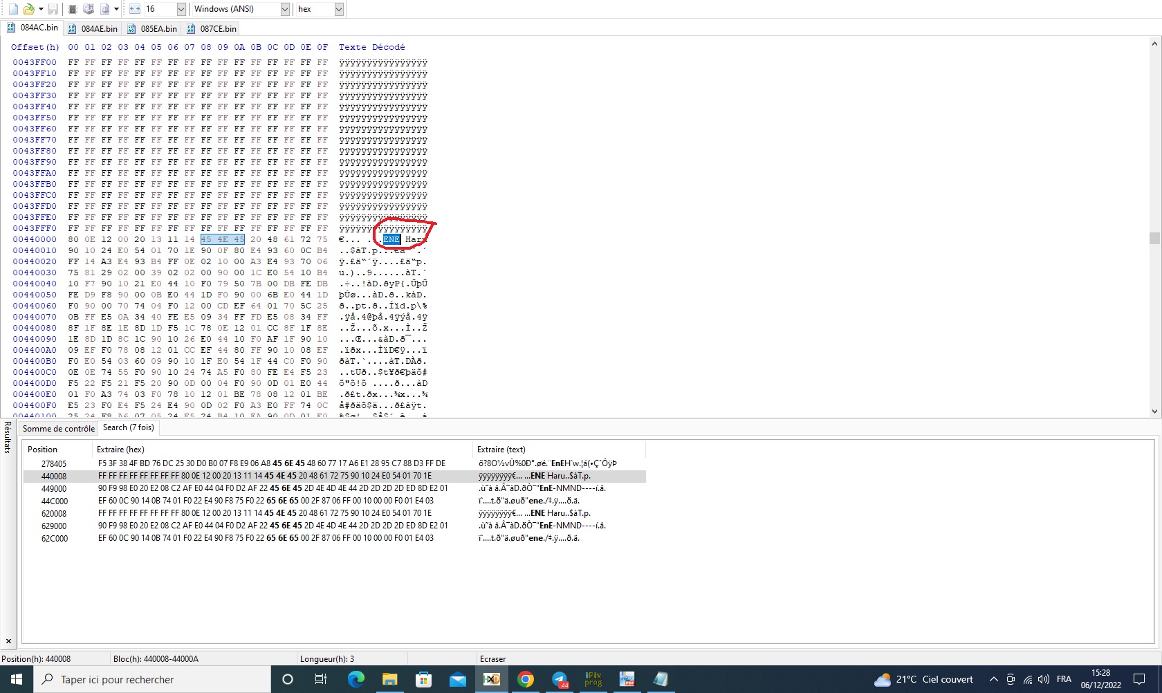

          About your exemple , i download bios exe from official site , excute and we have 4 bios image .
          For newer bios the EC is usually stored in the bios, its useful to know a few keywords to help search for it, such as For newer bios the EC is usually stored in the bios, its useful to know a few keywords to help search for it, such as
          ENE / haru / J7IFT / ITE..
          So using Hxd i search at the first bios img by keyword :ENE ...that's your kbc model

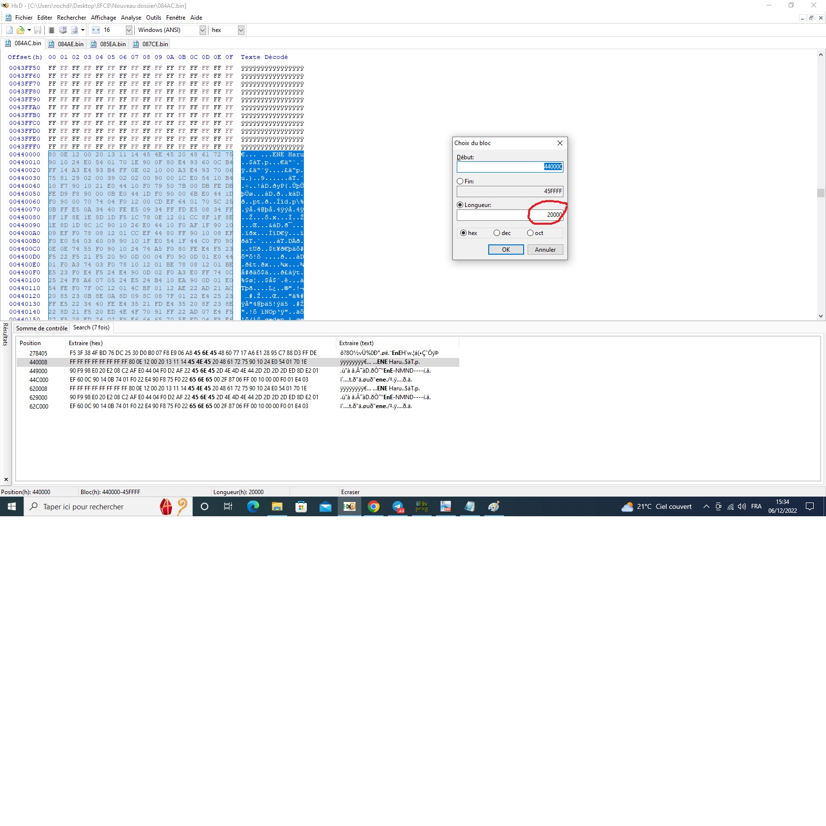

          If my kbc capacity is 128 kb so i go to hxd / edition /select bloc
          Start my selection by beginig od data ( that's my start point and as capacity i write 20000....the selected area is your EC dump
