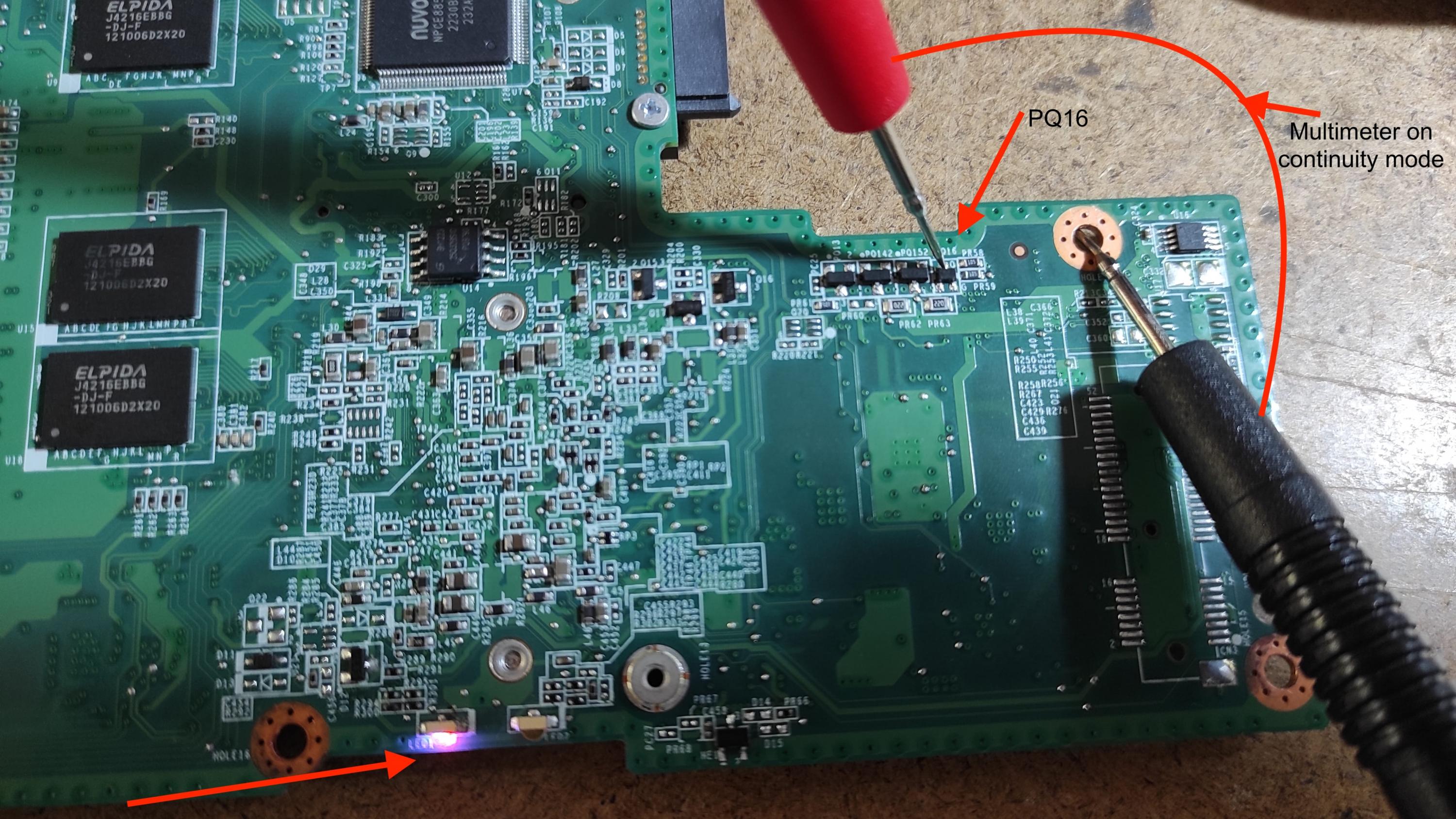

    I have an Acer V5-551G that not powering on, motherboard DA0ZRPMB6C0
    PU6:
    Pin 16 VIN→19.4V
    Pin 11→ 3.3V Pin 20→ 5V
    Pin 23 (pgood)→ 0.036V
    I've checked 3.3v always on on PL5 and it's ok, and 5v on PL4 ok.
    No 3.3V on the power on button...
    On the BIOS chip (25Q32Q8SIG) pin 8 no volt.
    Checked continuity between bios pin 8 and 3.3V (PL5 inductor) but no continuity...
    How is it possible?
    Can someone give me some help?
    Can i check something else?
    Thanks in advance.

        PL5 stands for +3VPCU-so there cant be direct connectivity between bios chip pin8, which is powered by +3V_S5. +3VPCU becomes +3V_S5 with PQ25.
        You need to check working of PQ16/15/14/13/23/24/33/25 to get some clues.
              Thanks for your reply,
              On pin 1 of PQ25 there are 0V and it is connected with BIOS pin 8.
              On Pin 3 of PQ25 there are 3.3v...
              I've found only
              PQ33 drain 3.3v source 0V
              PQ23 drain 5.10V source 0V
              PQ24 drain 5.10V source 0V
              PQ13/14/15 all pins 2 to 9.2v all pins 1 and 3 to ground
              PQ16 pin 0?→ 9.2v and continuity to ground ? When check continuity to ground the motherboard led 1 switches on. Is there a problem on PQ16, can be shorted?

                  So this proves that you'll get voltage on pin8 of bios chip only after it turns on-thats how acer has designed it.
                  PQ16,pin3 at 9.2V is again correct as there is a voltage divider between PR58/59(Both being equal, you will get half the input voltage). So nothing suspicious here.
                  You should follow @rediii's suggestion to remove those electrolyte caps and replace them with 330uF Tantalum caps. If you have a scope ,no need to remove both this caps and you can check for glitch on output. In the absence of scope, just replace them to rule out a possible issue on relatively old laptops.
                  The problem lies perhaps in SYS_HWPG. This later becomes HWPG thru an array of diodes. I'll suggest to remove D5/6/7/8 and see if it turns on.Just desolder the diodes on one end only so that you dont loose them and reverse polarity by mistake.
                  Hope this will help you. Goodluck

                          I've noticed that on power switch there aren't 3.3v and i think the switch have some problem.
                          Can't find on motherboard R124 o C156 that are connected with power switch... Jumpered CN10 pin 24 (NBSWON#) to ground and the laptop starts on , but the PL6 and PL7 and GPU chip becomes very hot. After 15 minutes the display goes off
                          Is it possible there is a GPU problem?
                          Injected 1v to PL6 it absorb 1.4A...
