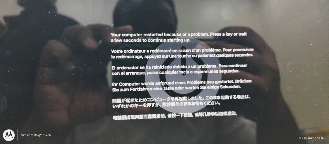

    I have a Macbook Air A1466 . it will suddenly restart and give me the below error. What can be the problem and solution?

    I would flash the bios or clean the ME first and if not then dig in the board to see some corrosion or heating.
