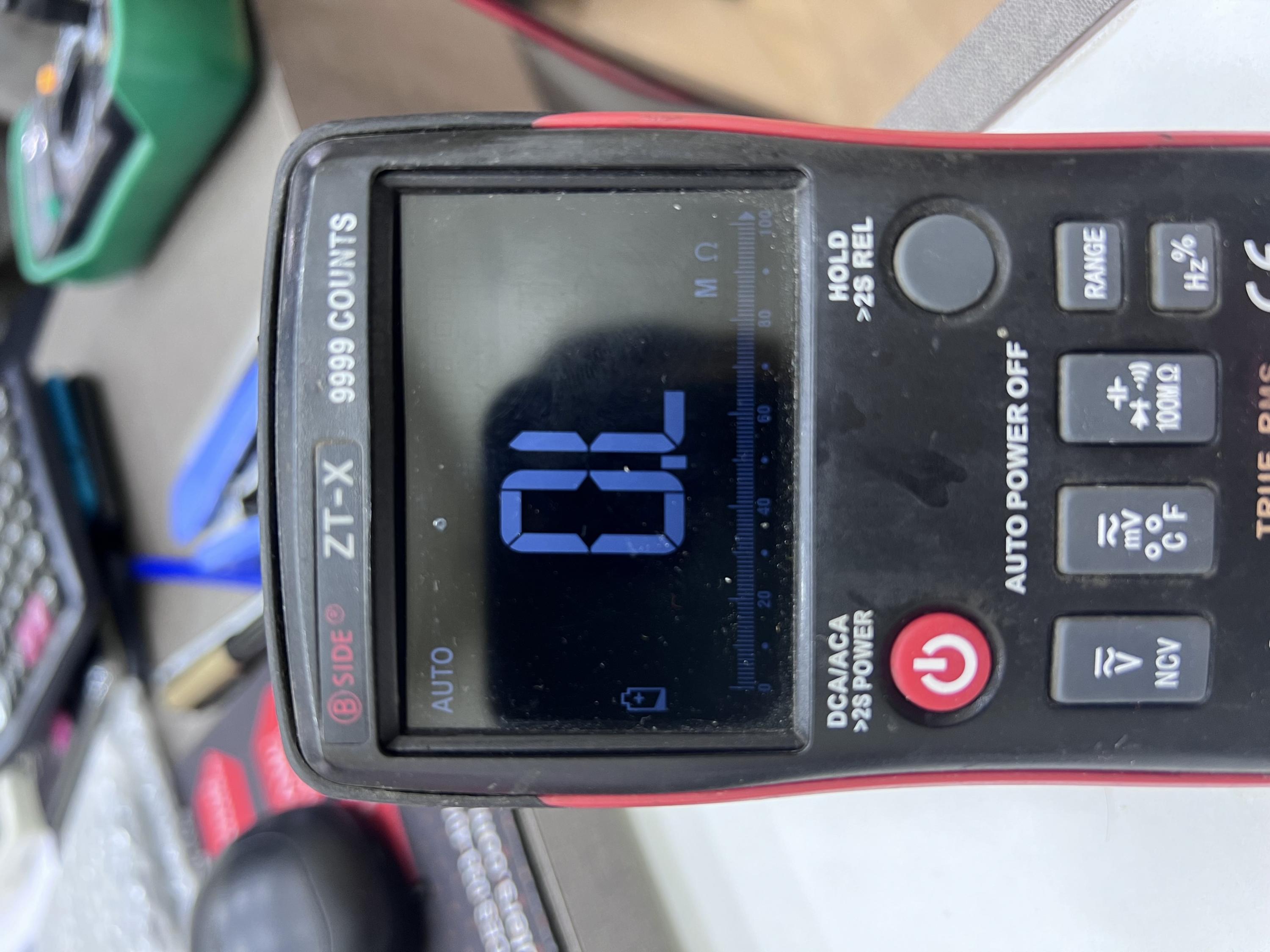

                      Check the resistance of r8162 with probes across the resistor.
                      If pin #1 resistance to ground is 0 ohms, this implies that the reset ic output pin #8 is shorted. Double check this. Could the meter be showing OL ?
                      • Instafixx
                        • Jul 2022
                        • 374
                        • India
                        Re: Macbook A1466 820-00165 - Suddenly Off
                        Yes the Meter is Showing OL. Apologies for the miscommunication. Image attached.
                        Also with Probes across R8162 its still showing 0.L
                        • mon2
                          • Dec 2019
                          • 14212
                          OL means the range selected on the meter is too low to test the part so select another setting.
                          In the future, consider to purchase an autoranging meter which will make these checks much easier.
                          • Instafixx
                            • Jul 2022
                            • 374
                            • India
                            That was an Auto-Range Meter i think.
                            Anyway
                            Using another meter set to the 2M scale.
                            Resistance to Ground
                            Pin #2 is .993
                            Pin#1 is 1.
                            Also this resistor is actually not present on the board. Its a blank spot with 2 pads. Same for U8160
