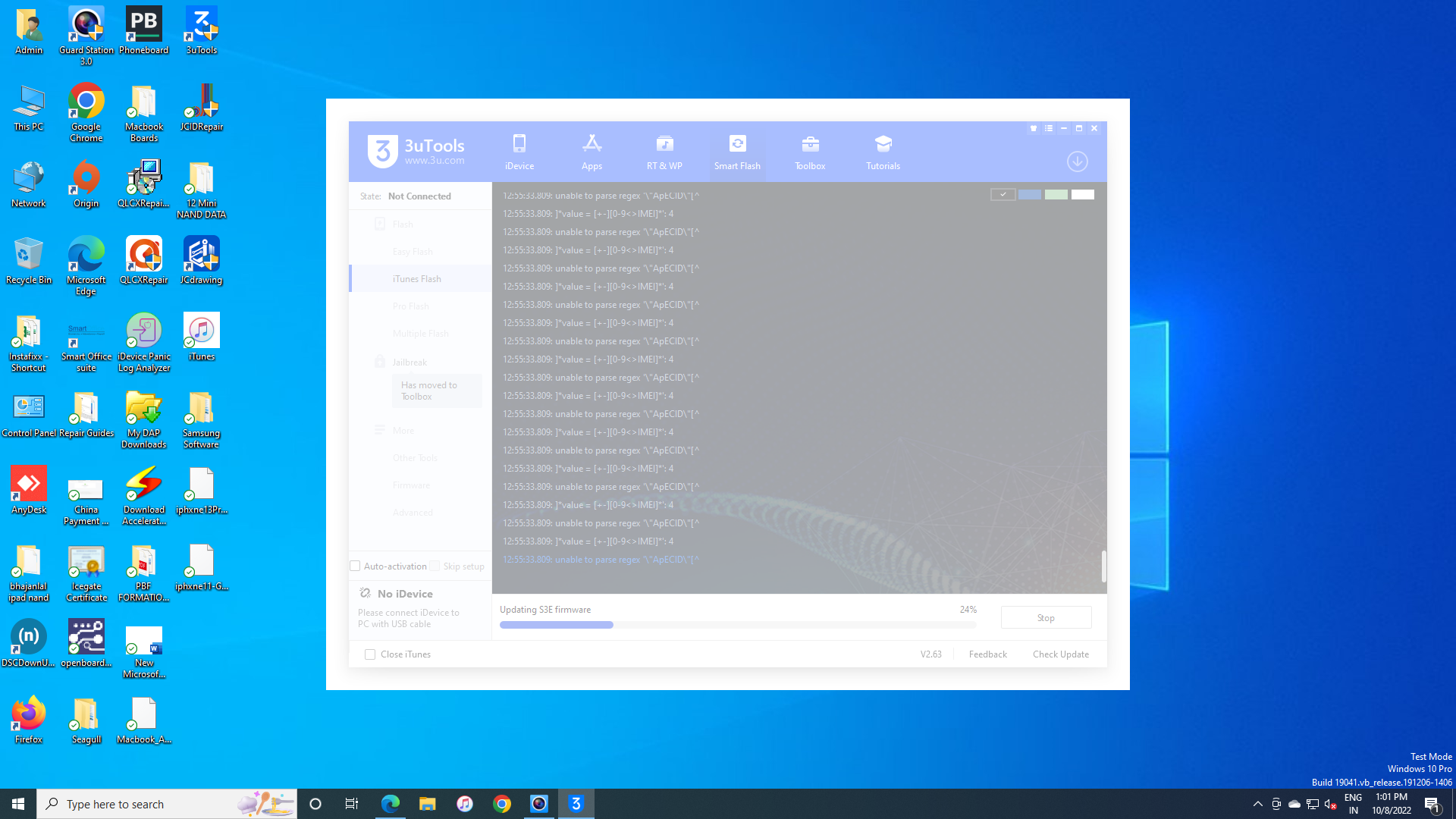

    Helllo Everyone, Namaste.
    I have an iphone 11. The client was doing an OTA updae and the phone crashes and it is stuck in recovery mode. While trying to restore again was getting an Error 3194.
    We removed the NAND and used JCID P13 to format and restore the data. Now when we try to restore it via itunes or 3uTools we get an error -1.
    It sometimes gives the error halfway through or sometimes at the end
    at about 96% when doing via 3uTools
    Restoring Firmware when doing via iTunes.
    One more weird thing is that the device will simply not go into DFU mode at all. It is stuck at recovery mode only.
    Sharing a screenshot of the error at 3uTools. Its a parseregex error everytime.

    Not sure if you have seen this video?
    https://www.youtube.com/watch?v=STnpmyMNWJ4

      Re: iPhone 11 Error -1
      The points are fine. Even if we are doing software with just the upper board getting an error too
