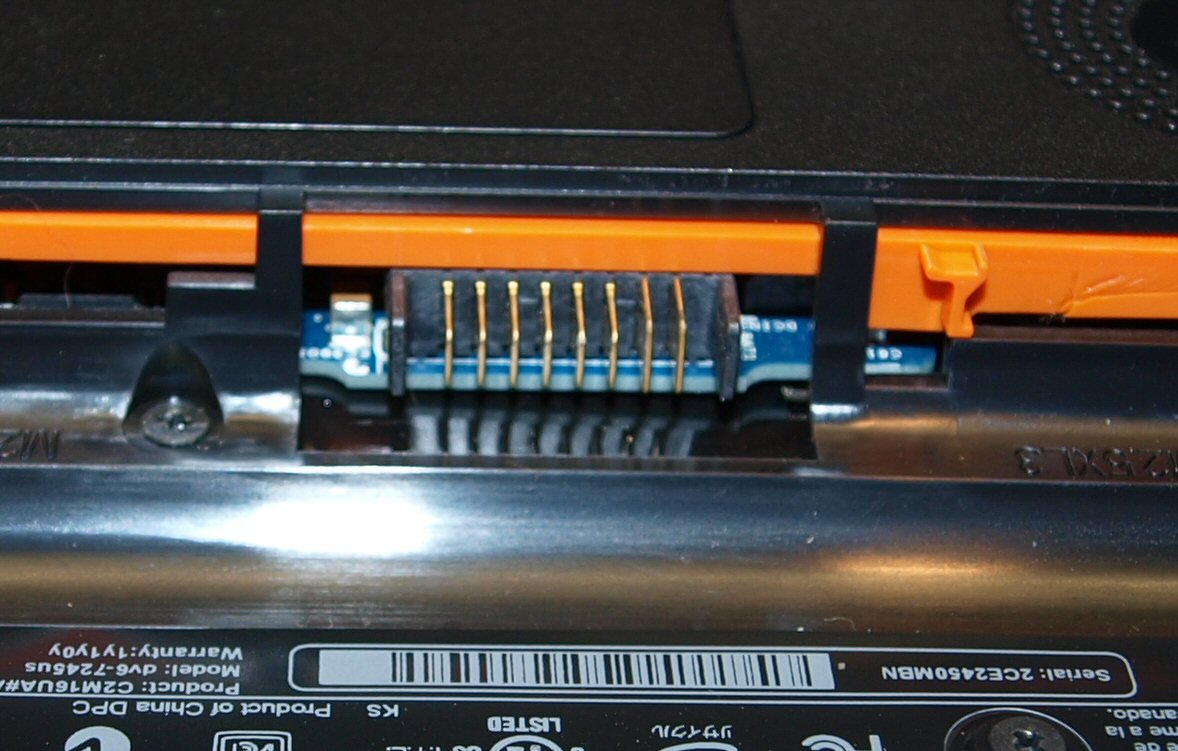

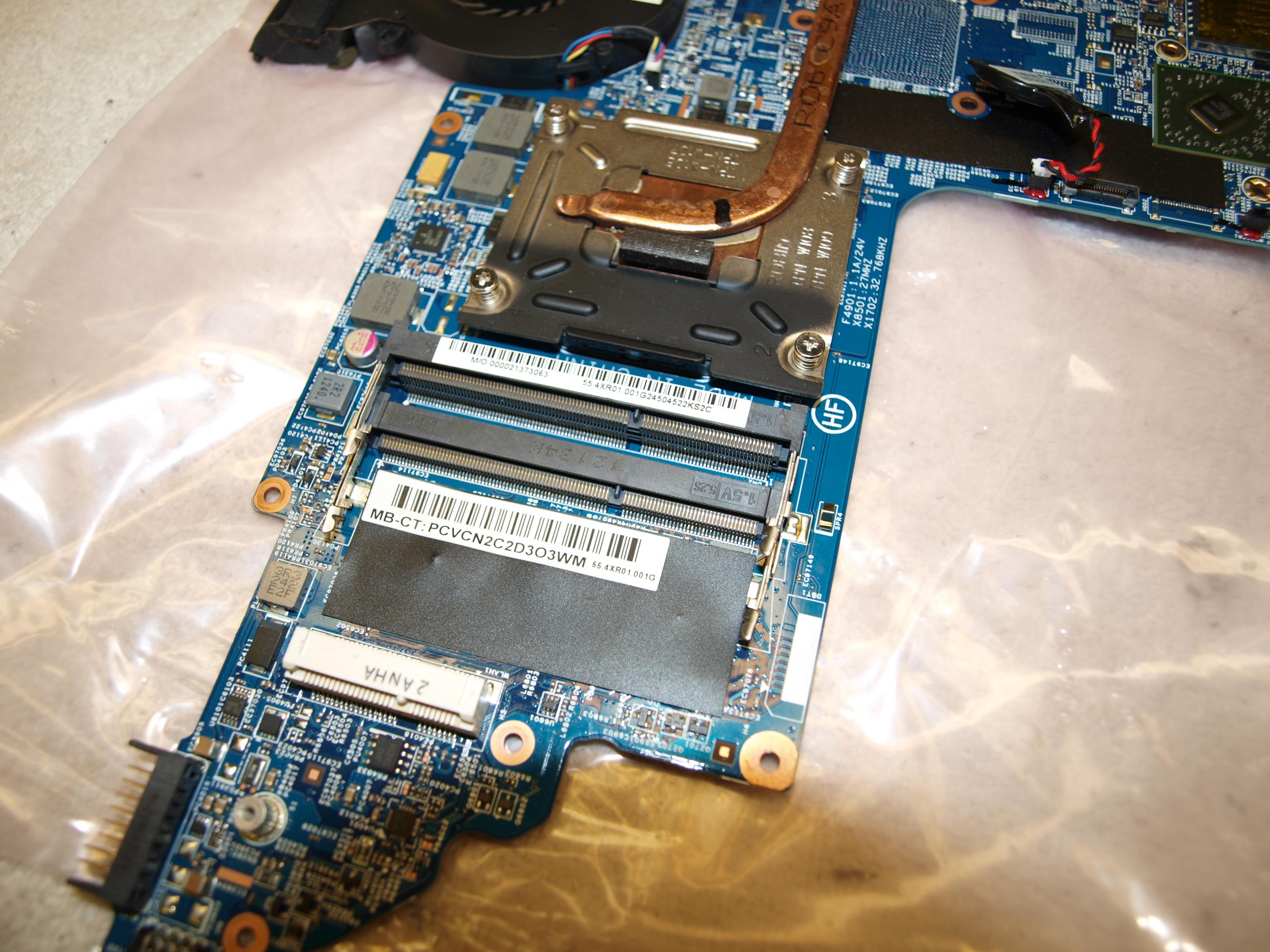

      Here's the connector:
      8 pins, read from left to right as in the photo:
      1 = 3.1v
      2 = 3.1v
      3 = 3.3v
      4 = 3.3v
      5 1~1.4 mV
      6 = 3.3v
      7 = 0
      8 = 0
      Charge LED is white when batt is out, with batt installed, it flashes back & forth from amber to white; occasionally I can hear a 'ticking' sound from the corner of the unit where the plug is. Laptop functions fine as long as it's plugged in; with or without a batt installed. If I charge the battery in another DV6, it runs fine on batt until the batt dies.

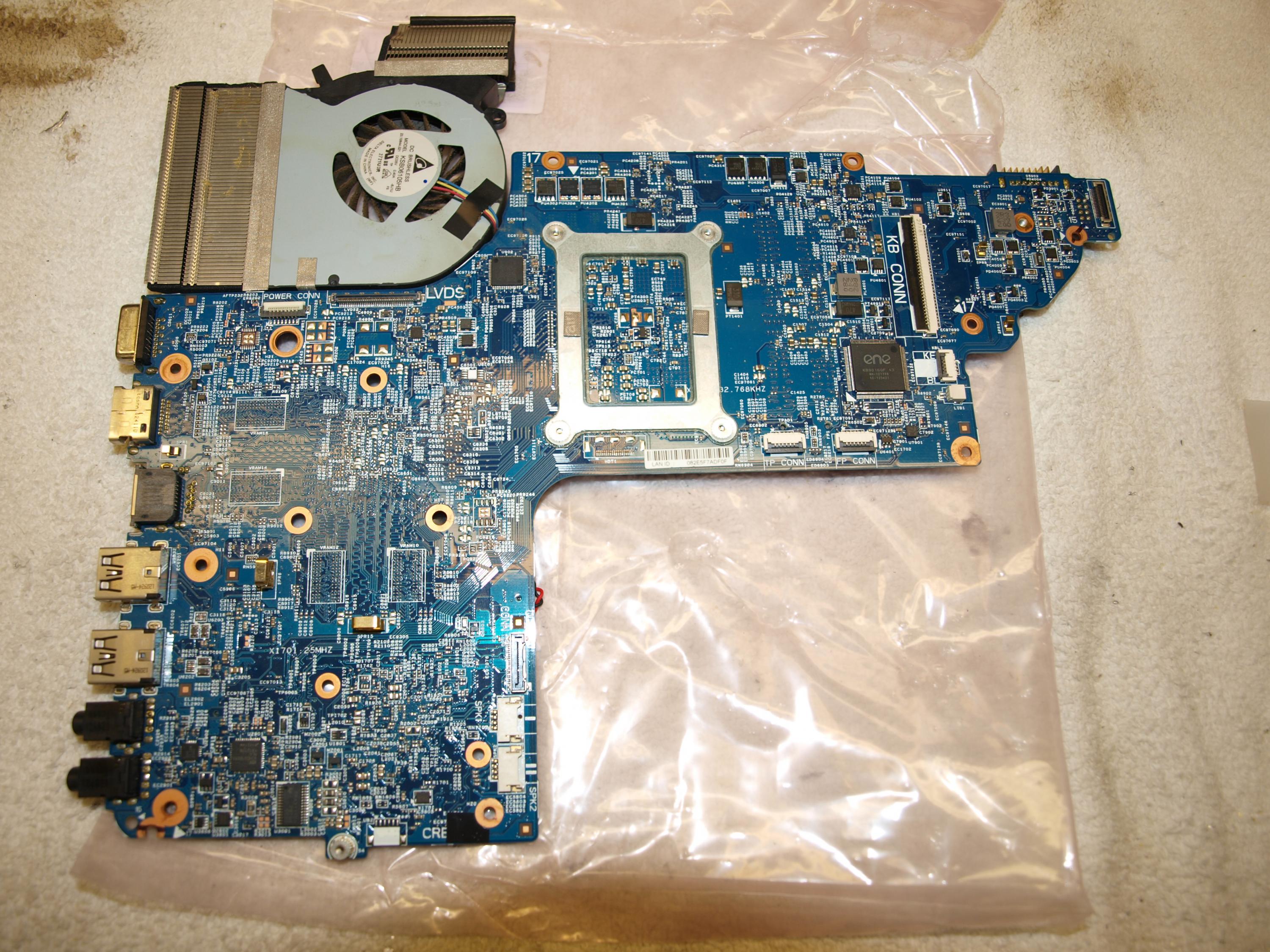

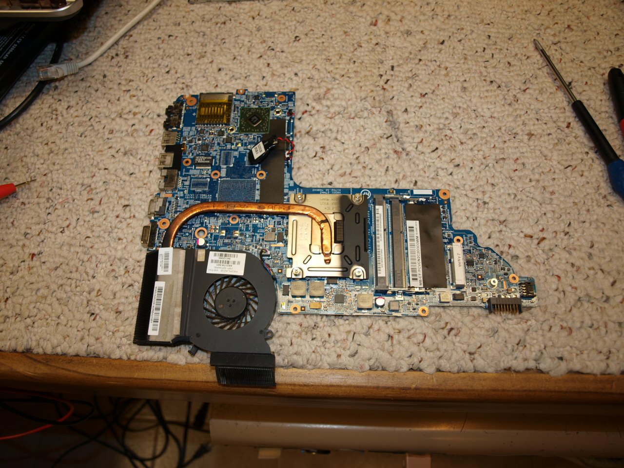

              Ok, finally got it....this was a bit of a pain to get apart....but I got it...and dind't break anything.
              The motherboard.
              Power section:
              What appears to be 'PQ3804' (so many numbered components around it) reads a short across the pins indicated with red dots. All neighboring transistors read as they should.

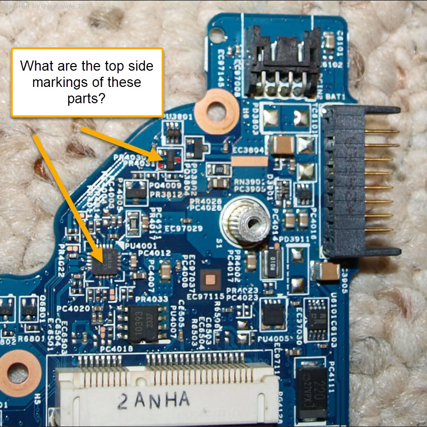

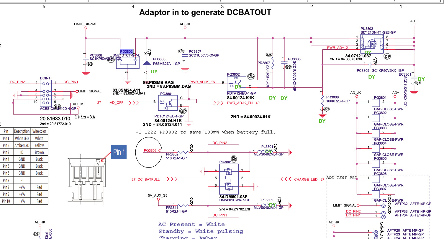

                Re: HP DV6-7245US Won't Charge
                See attached.
                1) to avoid static charge kills, best to place perhaps a piece of cardboard underneath the logic board rather than carpet. ESD bags are even a better choice.
                2) what are the topside markings of the referenced parts in the attachment. PQ3804 may be a dual esd diode array for the battery SCL / SDA interface.
                Interested to know the square device part number which is probably a 'BQ' (TI) charger IC.

                  That is anti-static carpet....I promise, I'm not that careless!! ...but yea, I'll slip an ESD bag under it. Stand by for the numbers.

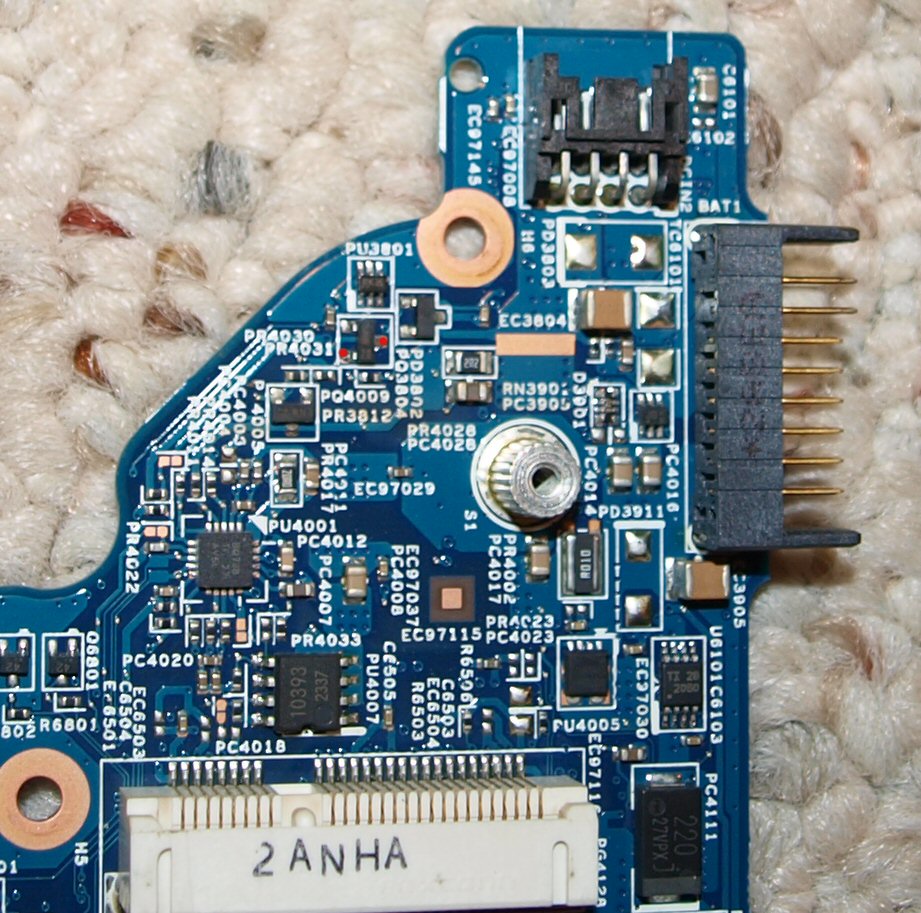

                        Originally posted by mon2
                        Can you also post any additional silk screen markings from your logic board? Perhaps have a schematic in my database or perhaps not but will search for it.
                        Here you go. Unedited.

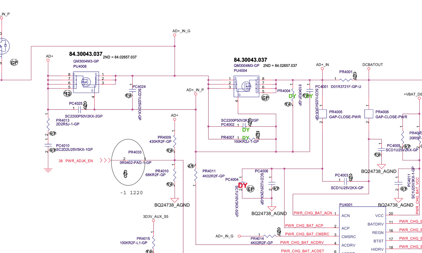

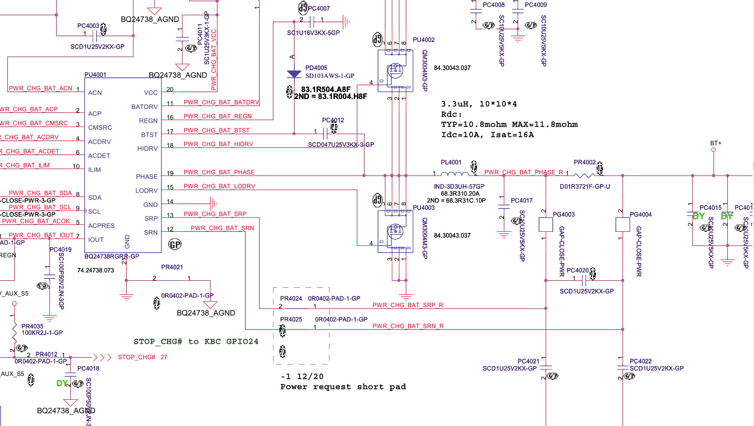

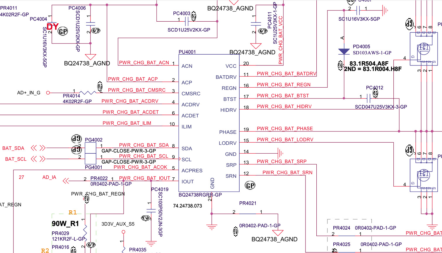

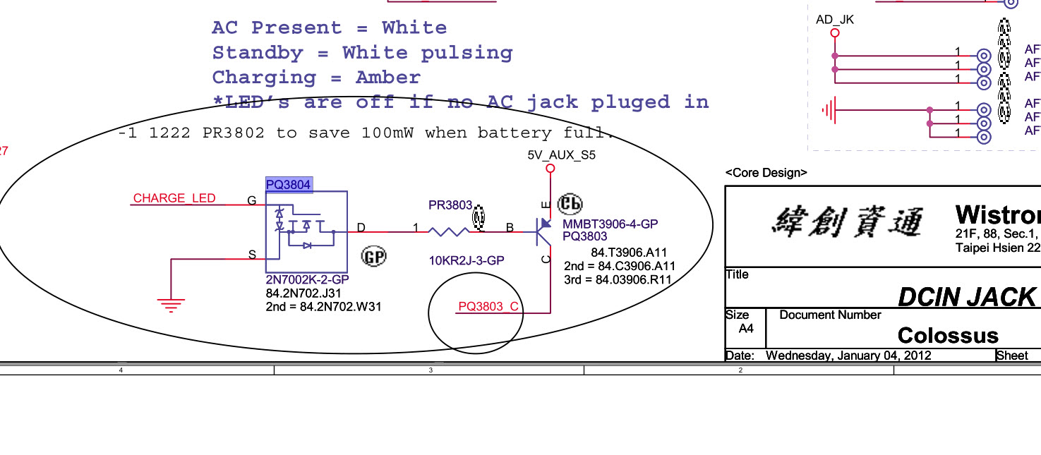

                          May have a hit...see attached.
                          1) PQ3804 = 2N7002 (SOT-23)
                          2) PD3802 is on your board - also in the next attachment.
                          3) PU4001 = BQ24738 charger IC
                          4) DCin charger mosfets - as per sticky from @Piernov, often the 2nd DCin mosfet gets damaged. Review the voltage on each pin of these 2 * DCin mosfets.
                          Interested in:
                          source (1-2-3)
                          gate (4)
                          drain (5-6-7-8)
                          voltage readings of each - PU4006 & PU4004 (likely the defective guy).
                          5) After the above check -> power down -> meter in resistance mode.
                          Check the resistance across the above 2 x mosfets as per above.
                          source (1-2-3) & drain (5-6-7-8)
                          source (1-2-3) & gate (4)
                          gate (4) & drain (5-6-7-8)
                          PU4004 is of interest. If really keen - replace this mosfet and test again.
                          These mosfets are N-channel so the gate has to be higher than the voltage it is passing and should be ~25v using the ACDRV pin on the charger IC (BQ).
                          Confirm it is this voltage to enable the 2 x DCin mosfets.
