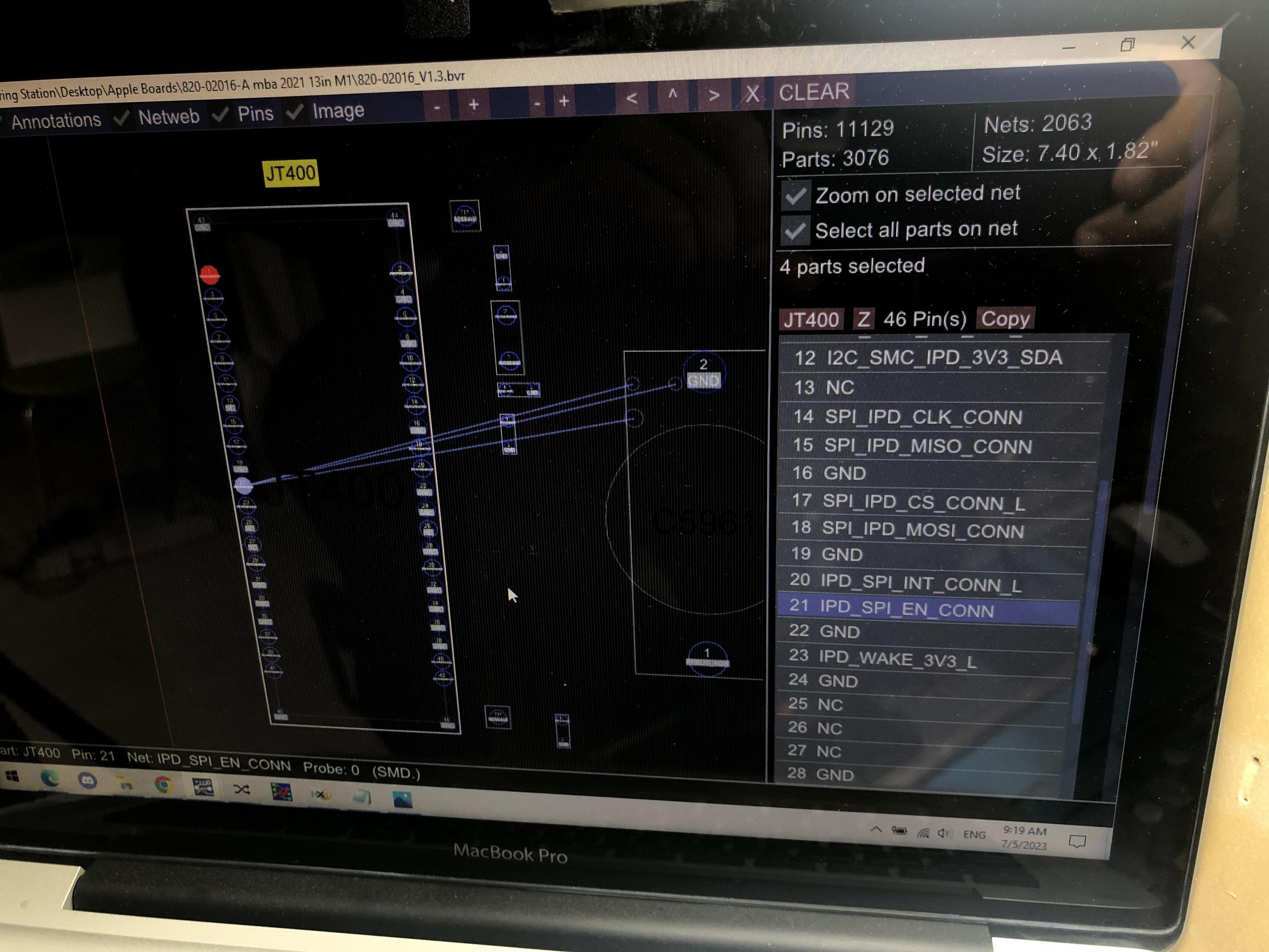

      Re: Macbook M1 820-02016 Keyboard -Trackpad stop working after a while
      Same problem. When computer goes to sleep via closing the lid usually, trackpad and keyboard dont work.
      Either in the OS or recovery environment, suggesting it was not software related.
      Reflowed the area that controls IPD_SPI_EN_CONN and just in case the lid sensor controller (same area)
      Now 4 days and no more problem

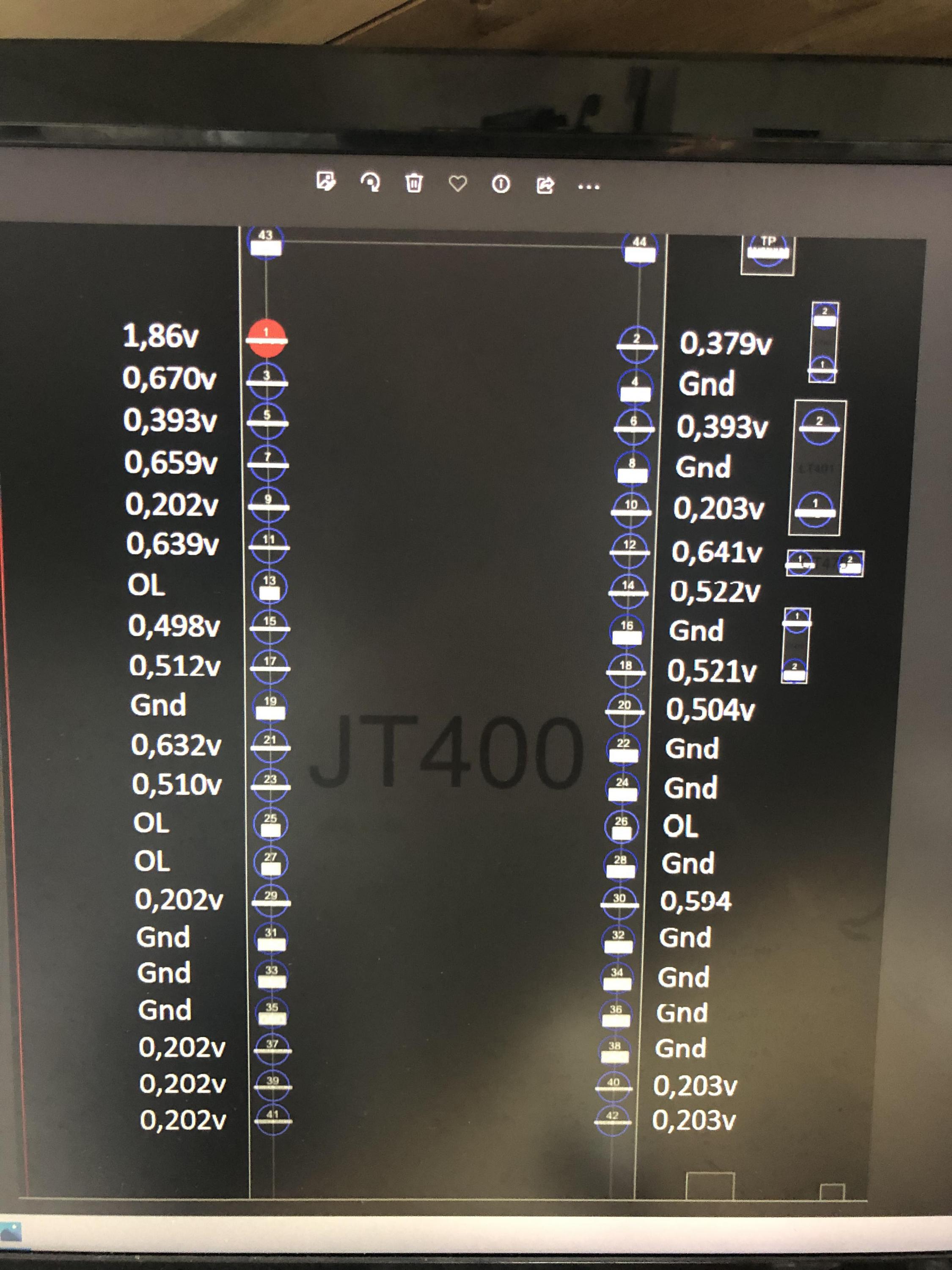

                last pic are these diode readings?
                have 0.5v where you have 1.8v drop
                    That's another error.
                    • reassor
                      • Apr 2021
                      • 181
                      • Poland
                      Yeah figured. Took pcb out measured again with sensor in and keyboard in and it's 1.8v
                      Still does not work.
                      But in my case it does not work permanently.
