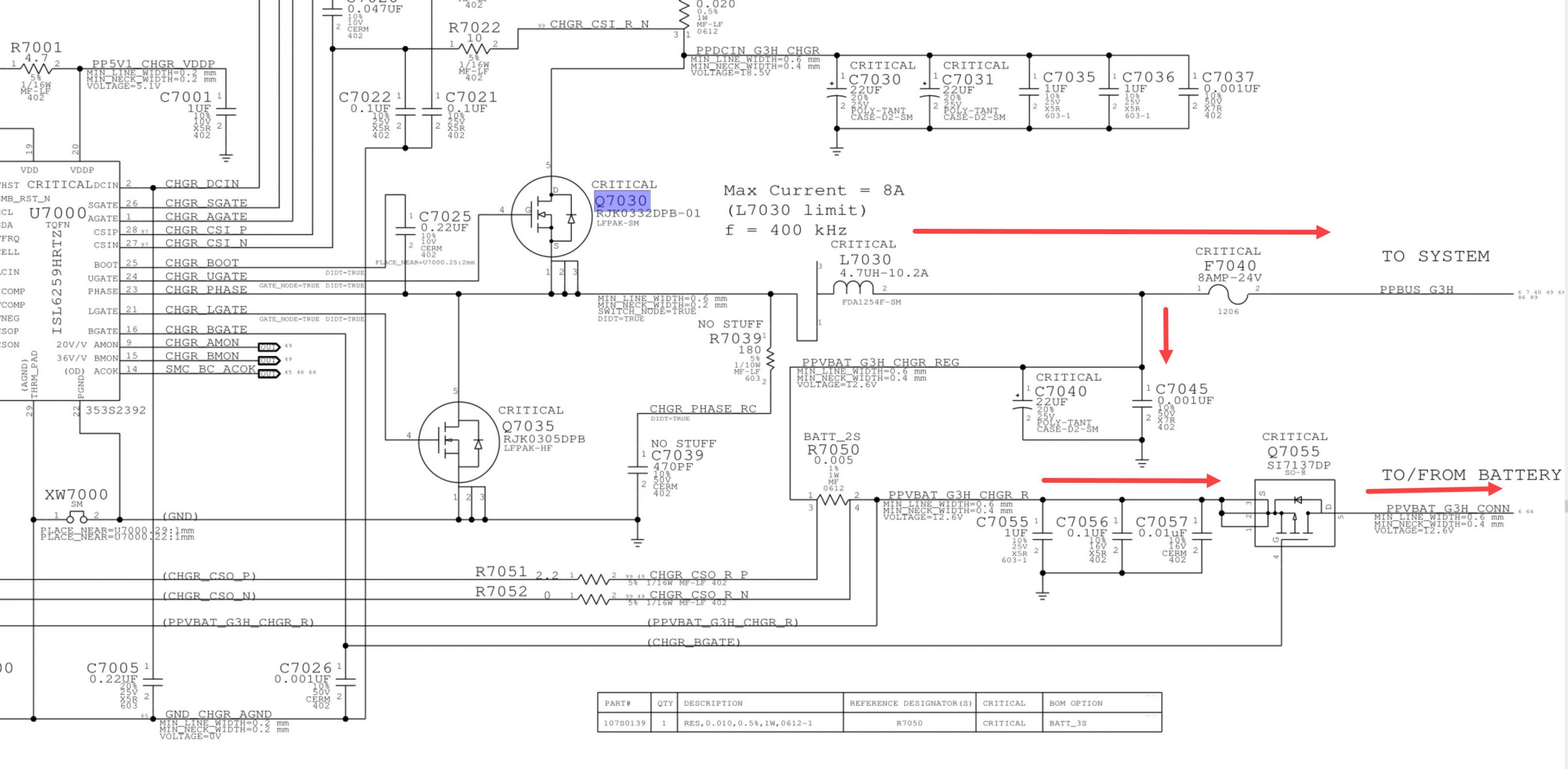

                            #33
                            Re: MacBook Pro 2010 15" 820-2850 no charge, green light, powers on
                            According to this video, Q7035 and Q7030 are suspects:
                            https://www.youtube.com/watch?v=6_kB...=NorthridgeFix
                            Changing Q7035 in this case solved the No Orange LED issue.
                            Very similar to my situation.
                            I've verified the SMC pullup resistors as 2Kohm in circuit (1Kohm in the schematics though), all reaching the ISL.
                            Since this was in the beginning a very fringe case of "almost" charging (a BAD battery), then none, I believe MOSFets are still under suspicion.
                            What I don't understand is how Q7030 and Q7035 are related to charging.
                            Worth a shot?

                              #34
                              See attached.
                              PPBUS_G3H voltage is created / regulated by Q7030 & Q7035. These mosfets switch on / off to dial up the desired voltage to power the logic board.
                              This same rail is used to charge the battery pack.

                                #35
                                Originally posted by mon2
                                See attached.
                                Thanks for chiming in!
                                So if one or both of q7030 and q7035 became faulty / weak, it could explain the symtoms?
                                Enough current to boot, but not charge.
                                • mon2
                                  • Dec 2019
                                  • 14761
                                  #36
                                  Yes, it is possible. Consider to replace the HIGH SIDE (Q7030) / LOW SIDE (Q7035) and also the battery mosfet (Q7055).
                                  It is worth testing with a fresh set of mosfets. Believe you have already replaced Q7030 so proceed with the others.
