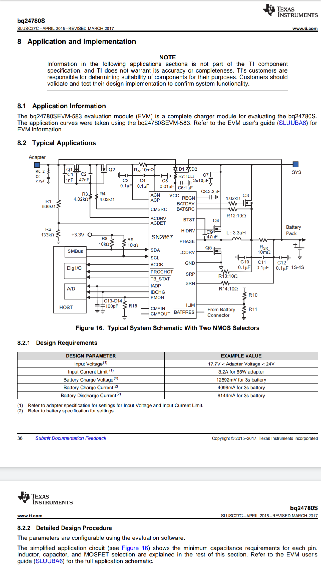

            #105
            Re: Troubles with HP pro x2 612 g2
            That bytes.
            See attached on the ref design of the charger IC.
            Locate the other mosfets on your board that are the high and low side for the battery charging.
            These are mosfets Q4 (high side) and Q5 (low side) in the attachment.
            Respectively, they will be connected to pin 26 and 23 on the charger IC.
            Once you locate the mosfets, post a pic of the parts. Remove all power and measure their resistance across the pins, as you have done before.
            We are checking if perhaps the high side mosfet is leaking. Check even the low side mosfet.
            Post your measurements.

              #106
              hi, ok
              So first of all, in the photo 2 you ll see that the pin 26 goes, it seems, to the intersil IC (photo 3) :
              I read resistance values coming from pin 26 of bq24780s on many, many pins of this IC
              I can't find any datasheet for this IC.
              I can't find where pin 23 goes. It directly sink into the board... I didn't find any track of it
              Pin 26 gives reading on these components around BQ24780S (see first photo) : K727, A7W,
              L43 (x2), SBI, NM742 (below SB)

                    #109
                    See the ref schematic. The mosfets will be close to a coil (grey?). The mosfets will share common pins like schematic and probably near the battery connector since this rail charges the battery.
                    Post pics of mosfets that you find and their topside markings.
                    Assuming that they will be single package single mosfets like before.

                                #115
                                Perfect. Now review which side is the source (pins 1-2-3) will be shorted; pin 4 by itself; drain (pins 5-6-7-8) will be shorted - for each of these mosfets.
                                Then proceed to continue to test the resistance across the mosfet pins:
                                source (1-2-3) & drain (5-6-7-8)
                                source (1-2-3) & gate (4)
                                gate (4) & drain (5-6-7-8)
                                Post the readings of each measurement.
                                Then repeat for the next mosfet that is also connected to this coil.
                                One mosfet = high side.
                                Other mosfet = low side.
                                These 2 mosfets & the coil you have found are responsible for the battery charge voltage. Each mosfet pulses ON / OFF till the ideal charge voltage is in range for your target battery pack. This is a BUCK regulator and accepts the high input voltage (12V in your case) and lowers it to a safe value for the battery pack.
                                The LOW side mosfet will have ~0 ohms resistance to ground on likely the source (pins 1-2-3).
