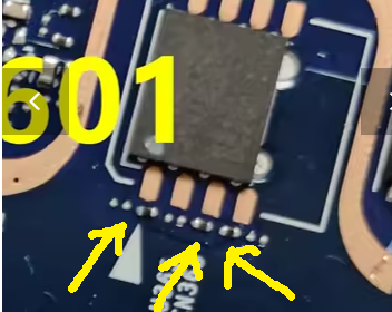

                                Hi, can anyone tell me what these three components marked in the photo are? I accidentally ripped them off!
