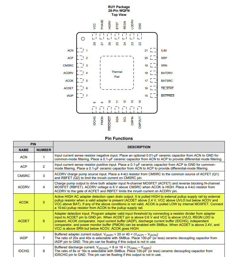

                                          Ok. That is not good. The battery mosfet is ON while the adapter is connected ? Can you confirm this understanding ?
                                          Gate voltage is ENABLING this mosfet.
                                          Update:
                                          with extreme caution, measure the voltage on:
                                          pin # 5 - ACOK
                                          pin # 6 - ACDET
