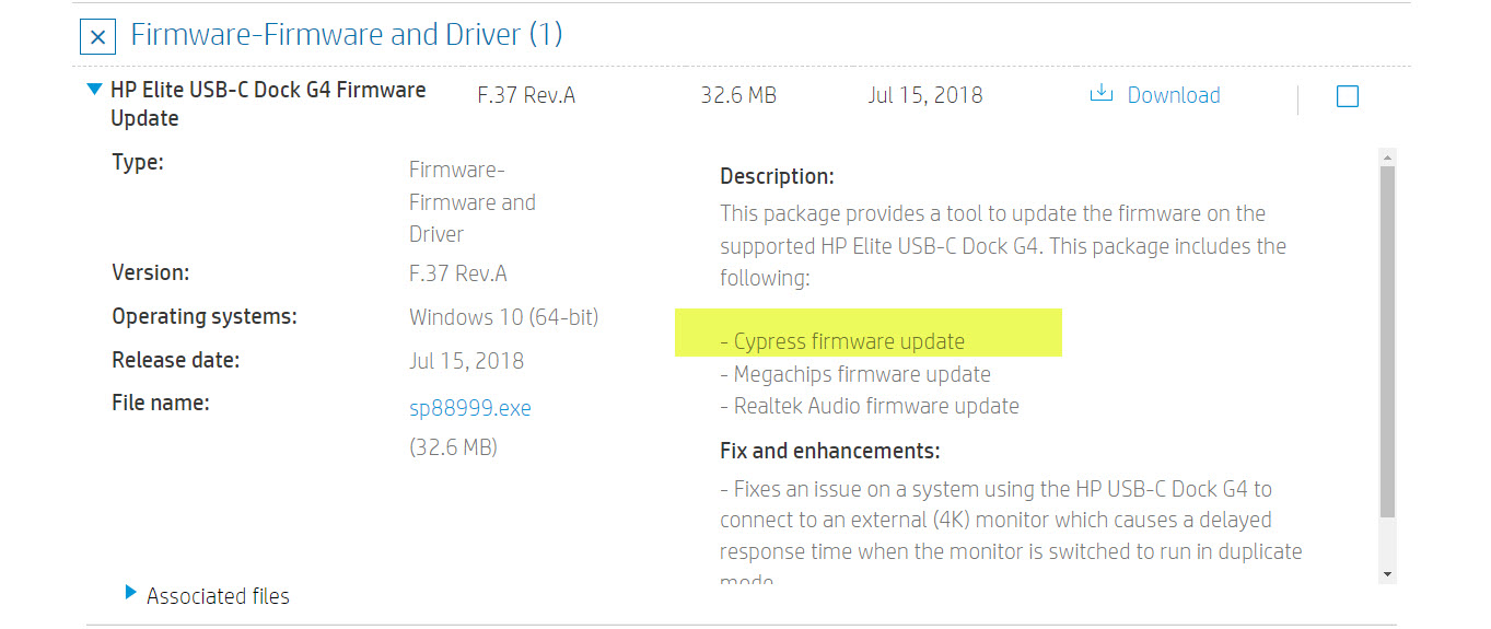

        Re: Troubles with HP pro x2 612 g2
        From here:
        https://support.hp.com/us-en/drivers...12-g2/14432855
        it appears your controller onboard will be from CYPRESS.
        then search for an IC with the following graphics on the topside:
        https://www.bing.com/search?q=cypres...NTA1&PC=EDGEDB
        See attached and it appears that there is a firmware tool / update to allow you to update the Cypress firmware. This is desirable to confirm you are current and that this tool can reflash the controller.
        It cannot hurt to perform this update.

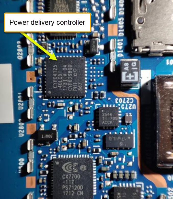

            #65
            That helps. See attached.
            Cypress p/n CYPD4125 is the USB Type C controller for this logic board.
            Does your power adapter power up this unit each & every time (without the battery connected) ?
            The other chip, nearby is the TI 2546 which is a load switch - we can ignore this since your issue is with the main power source; not the downstream devices you may want to charge.
            Datasheet for both are attached.

              #66
              yes every time
              Oh the updated firmware was for docks only
              Indeed I think this throubleshooting of the board will help many people, because there really nothing to be found elsewhere

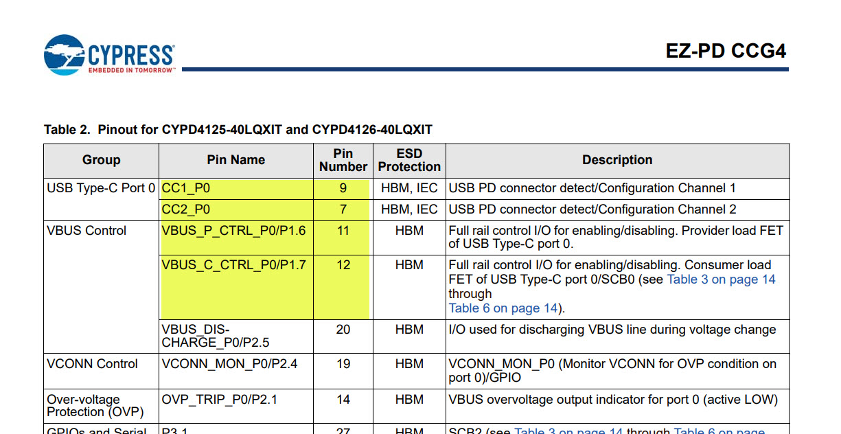

                #67
                See attached. With great care, review the voltage readings of the VBUS control pins.
                That is, when the adapter is connected - these pins should offer some voltage to enable local mosfets (that should be nearby this controller IC).
                These mosfets then feed to the charger IC.
                If these mosfet driver pins are not enabling then the fault could be with the CC1 and CC2 pins on this IC.
                To check the CCx pins; remove all power; meter in DIODE MODE.
                Red probe to GROUND. Yes, RED probe.
                Black probe to CC1 pin -> what is the reading ?
                Repeat for CC2 pin -> what is the reading ?
                Also - with no power -> meter in resistance mode -> do check the resistance to ground of any and all polarized caps nearby. Especially the tantalum in your posted picture. Tantalums are crap - we do not use them in any of our designs - with pride. Tantalums are cheap and are for planned obsolescence. When they die, they act like a short.
                I am being pulled away - will continue to review over the weekend and post when I can. Review the above details and post your measurements.

                  #68
                  here are the readings
                  pin 7 0V
                  pin 9 0.67V
                  pin 11 0V
                  pin 12 4.75V
                  I don't think I have diode mode ou my tools
