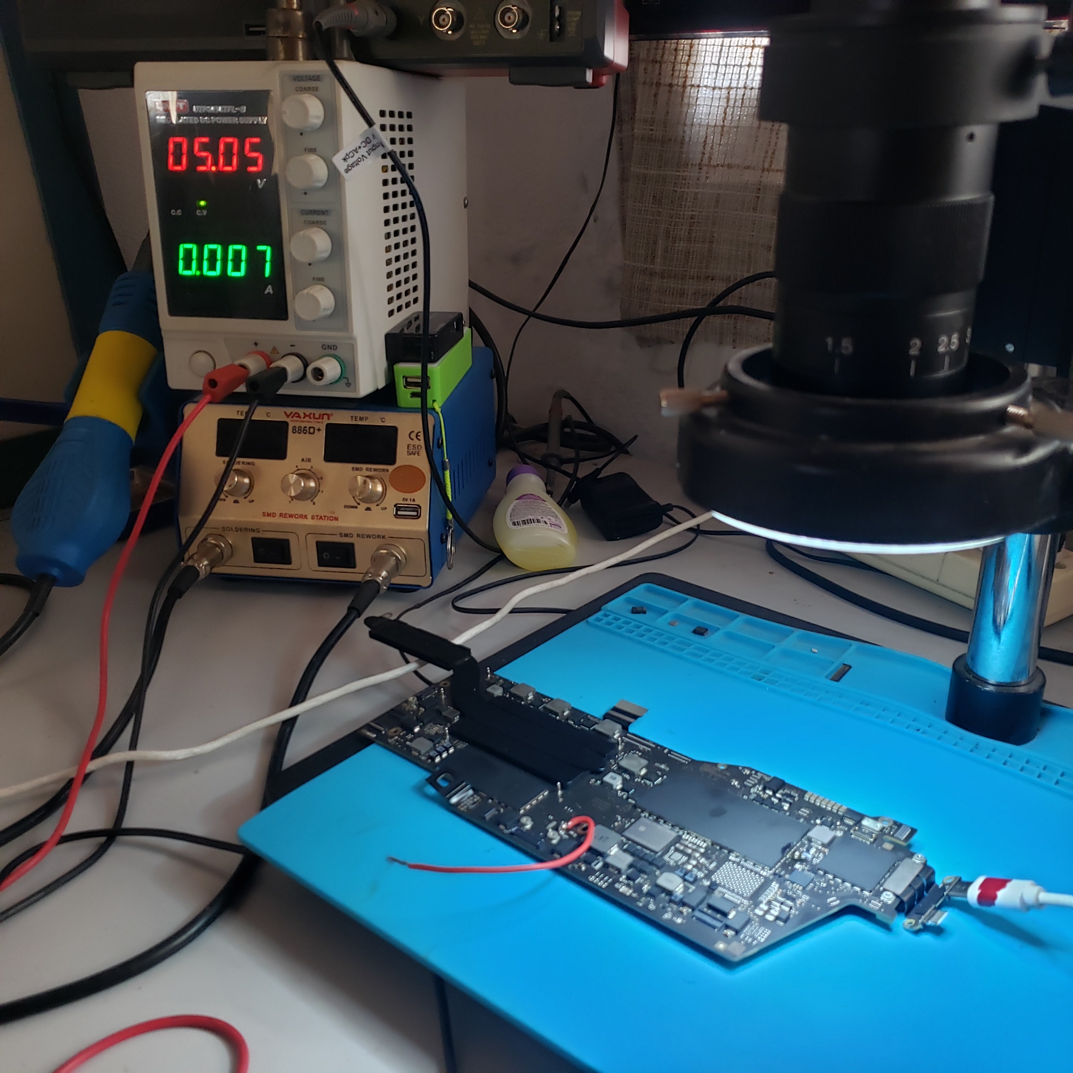

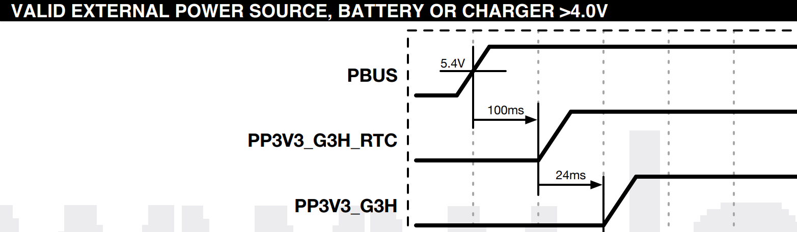

    Hello
    I have a 2019 no power A2159 MacBook TouchBar retina, board is 820 01598A
    No liquid damage so far. No power no chime with battery or connected to a samsung 2A celular 5v charger.
    With a usb C cable alone and my LAB power supply I see it is taking only 0,012mah at 5V, but I do not know if this is because of my 5v limit.... what else can I test with no MacBook charger?
    Im not getting pp3v3_g3h
    Since I do not have original charger USB C type, and also no usb c ammeter... I wonder if can use my lab power supply with a usb c (for now) and 5v initially and then increase to 9v to test battery charging and maybe increase to 20V after some seconds in the same pins...thks

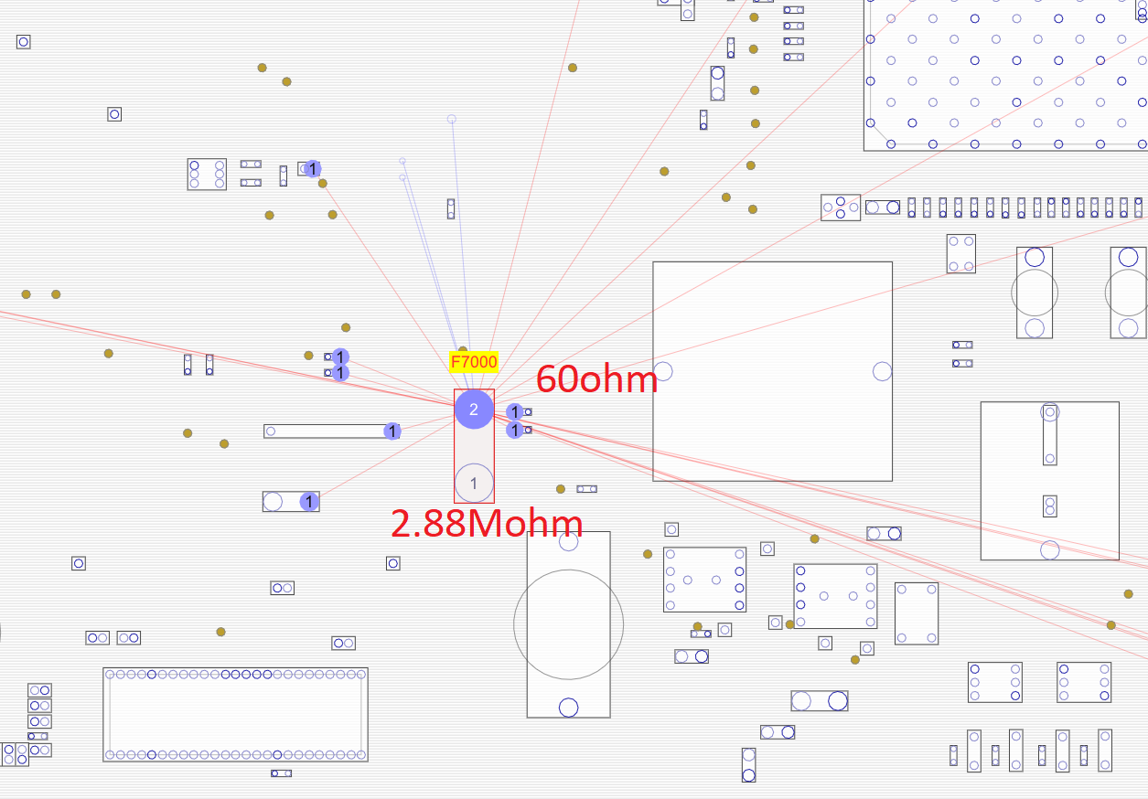

      I have removed the board.... for now just make diode and resistance measurements, so if you want me to test RES from coils to ground, or anyone does know typical values for this board will be welcome.... for example I have
      RES TO GROUND FROM:
      51,6ohm F7000

        That is a very low resistance.
        Remove F7000 fuse and check if the low resistance is on the ISL (producer) or downstream (consumer) side.
        • marce002
          • May 2018
          • 316
          • Argentine
          Re: A2159 no power test (no charger)
          Mon , battery removed , only board, fuse as expected : I have 60ohm in the load part (ppbus_g3h) and 2.88Mohm in the pin 1 of the fuse (PPVBAT_G3h etc).
          Lets inject volt and try to check something hot? i can do ... only issue is i have lab power supply (no mac usb c for now)
          thanks in advance

                                      3) Remove F7000 and check if the ISL9240 is able to offer any output at the F7000, pin # 1 PCB pad. What is the voltage if PPBUS_G3H without the fuse?
                                      4) What are the full markings of your power adapter being used ? Does it support 'power delivery specification' ? If not, then this is just a simple 5V power supply with a Type C connector.
                                      Based on the above assumption, the logic board may be just refusing to proceed.
                                      5) The ISL9240 & ISL9239 (previous generation) are buck/boost regulators. That is, they can take a low input voltage -> boost it to a higher voltage like 12v or vice versa. Take a high input voltage (ie. 20v) -> lower it to a voltage like 12v6 (BUCK mode).
                                      Before we can proceed, the PPBUS_G3H must work to offer the ~12v rail. This is the first step but may be blocked due to the wrong power adapter being used.
                                      Perhaps check your local Amazon store for a quick delivery.
                                      6) Confirm the voltage of PPDCIN_G3H (left side of ISL9240; page 64 in schematics). What is this input voltage with your adapter ?
