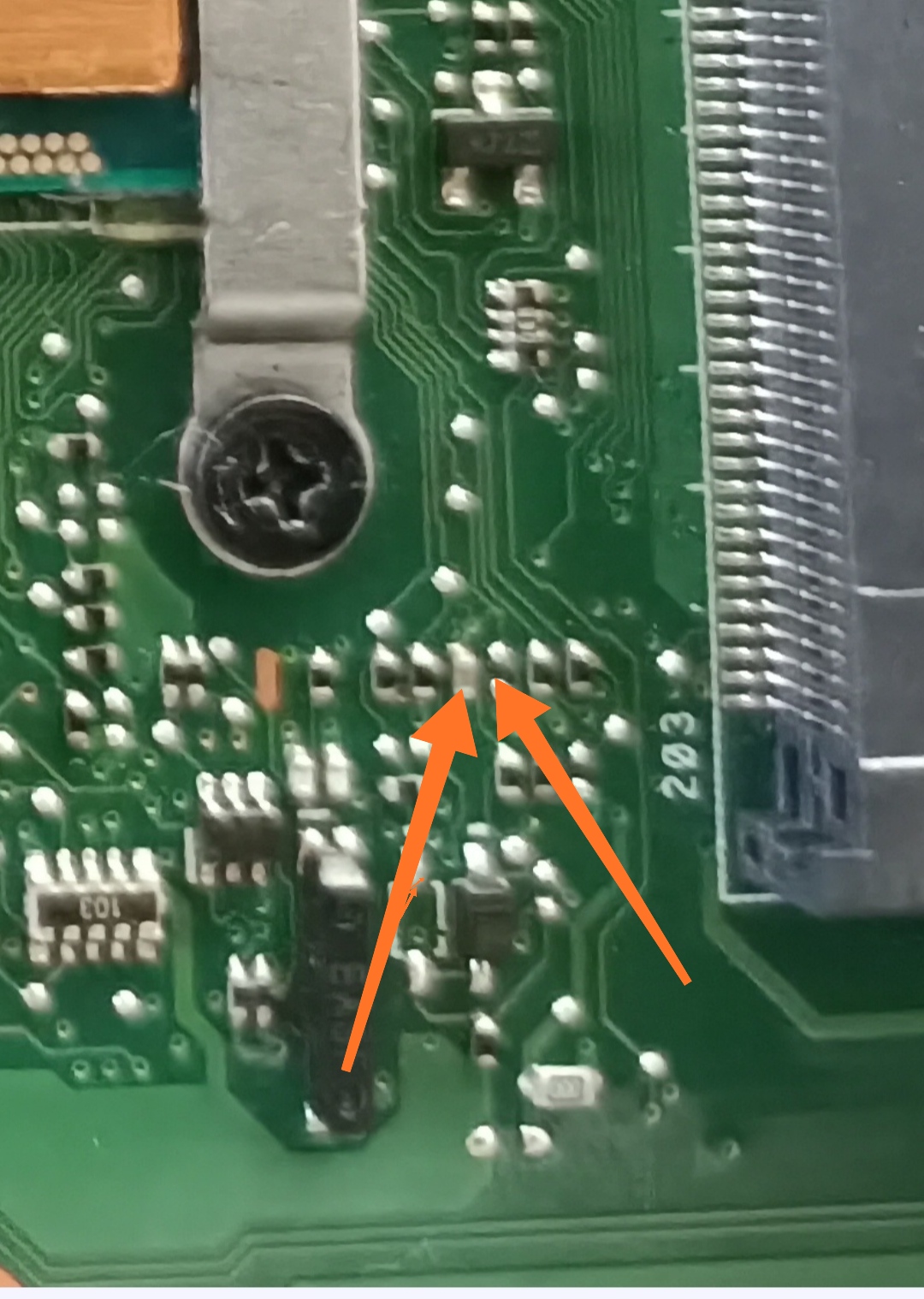

    Hello there
    X555LD REV 2.0 i7 4510u processor
    I closed and moved it while working, when I tried to open it again, there was no response
    I took the motherboard out and tested the power line with a multimeter
    I/O was heating up, we tried plugging in another chip, now the same chip doesn't heat up but still no power
    They said the processor south passed away but I want to be sure. What check should I do with the multimeter?

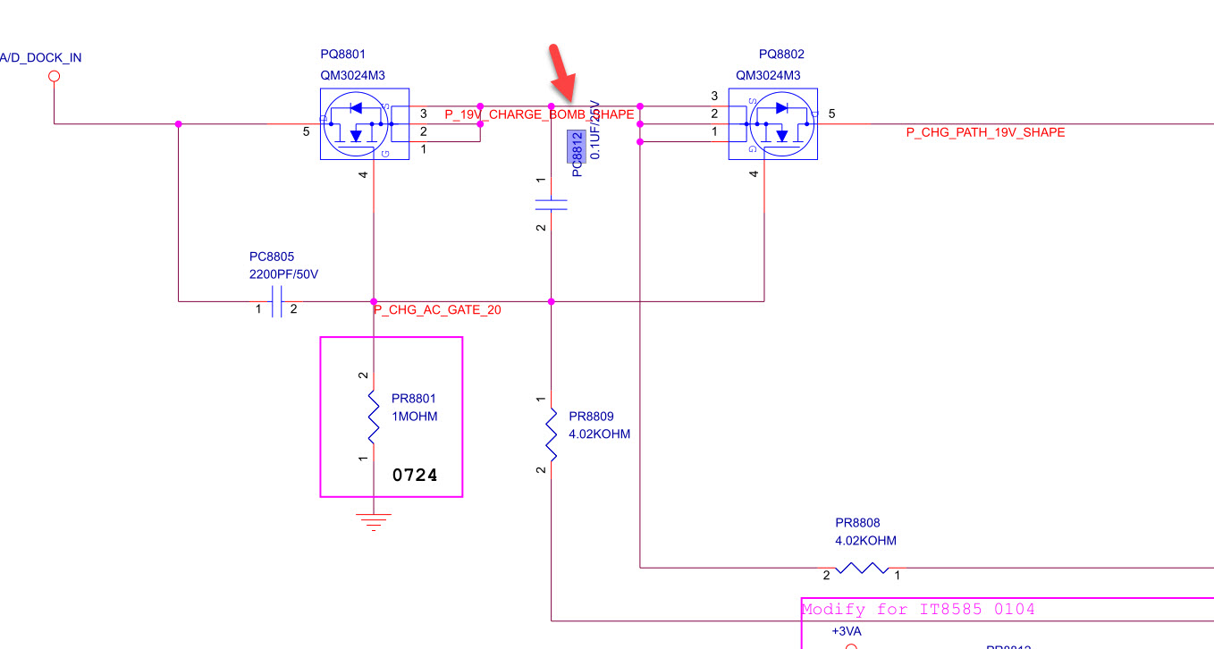

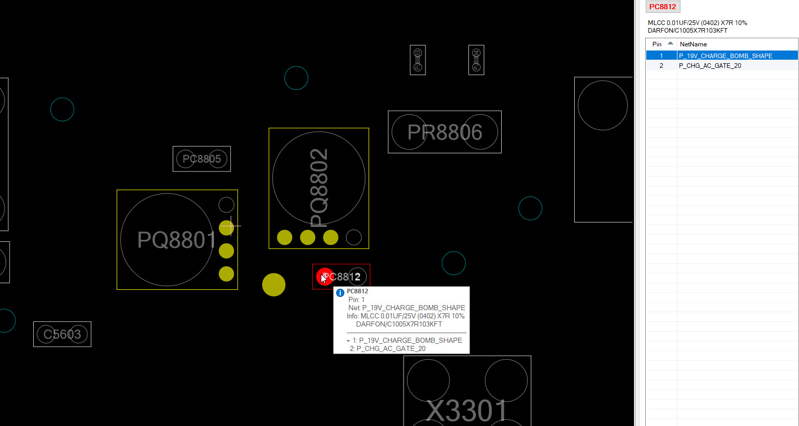

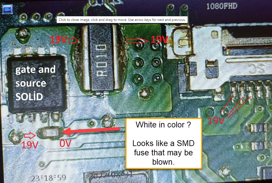

    Re: X555LD Rev2.0 No Power No Mainboard Could you help
    Update:
    False alarm. See attached.
    Put away the non-alcoholic beverages. It is a capacitor and the readings are ok.
      Originally posted by mon2
      Update:
      i think about it
      I couldn't clarify whether this is the coil of the processor, I don't have a schematic reading
      So there's 19V to this marked place, where does it come from?
        I believe to have both, the boardview and schematic files for this logic board or something very close to it. Will post more details after some beauty rest.
        In the meantime, the parts you show are the typical dcin mosfets.
        Post the markings from the top surface of each mosfet do we can compare notes.
        Remove all power. Meter in resistance mode.
        Check the resistance across the mosfet pins as usual:
        Source and drain
        Source and gate
        Gate and drain
        See the many many posts here on this forum about the same checks. If the resistance is too low, then the mosfet is defective and must be replaced.
        Do note the pin #1 of the original mosfet so it can be replaced. Take close up pics and post them here.
        Quite often, one or both of these mosfets get damaged. Read the sticky above from @Piernov for more details.

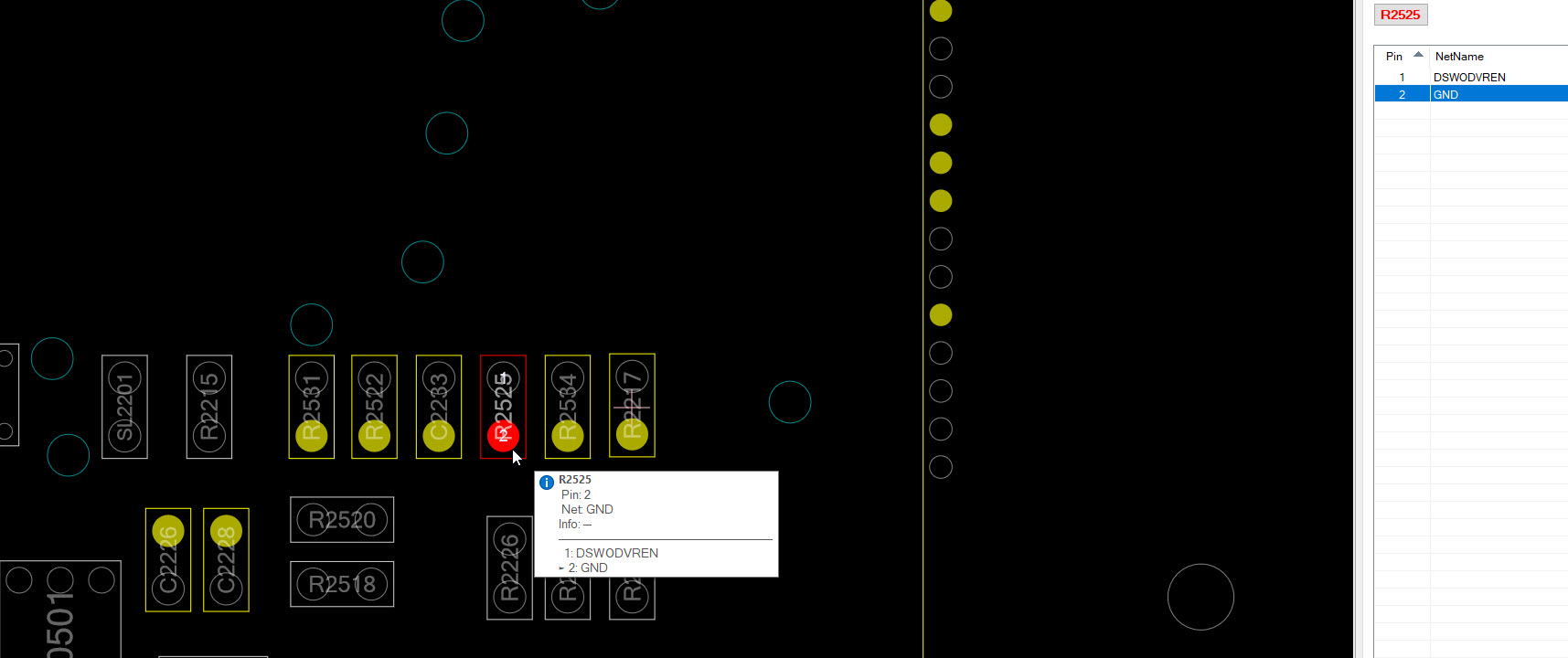

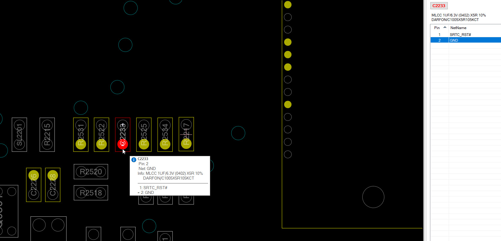

                    what are the designations and values of these components? one is a capacitor and the other is a resistor, I just don't know their value. thanks for the help, I didn't find the schematic, if someone has I would be grateful
                    • mon2
                      • Dec 2019
                      • 14106
                      Attached.
