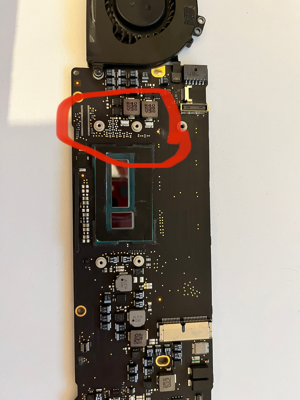

    hi guys I have the above MacBook Air
    ive got the schematic for it and the boardview file.
    but I can't for the life of me figure out what's going on.
    its as if its dead the MagSafe light turns on when connected and goes to green to say the battery is charged.
    but there is no signs of life other than the fact that if I press the power button when I have a usb dongle connected it will spring to the life (the usb stick I mean)
    but nothing else no fan spin no backlight no chime
    nothing.
    ive tried an SMC reset which seems to work.
    but still no power on.
    ive removed the bottom cover and can see no sign of water damage or anything.
    it just was on then shut down and never came back after.
    ive tried a new battery with the same results.
    as I have the board files ive checked the board for shorts and find loads around the circled area.
    but if I check for voltages im getting 8.5v on all the caps marked NEHAV7
    thanks for any help.
    picture attached

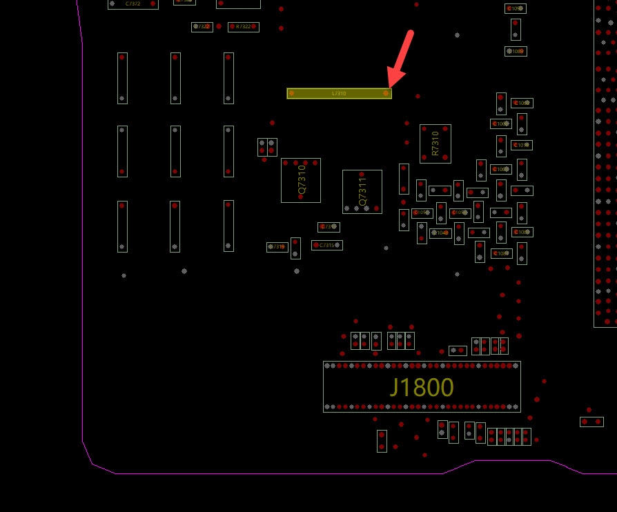

            Download the schematic and boardview file from here:
            https://www.badcaps.net/forum/showpo...34&postcount=2
            Search for the above 'PPVC_S0_CPU' netname and the PDF viewer will offer a match for each hit.
            Then look for the same component inside the boardview file to locate where to probe. Suggestion is to use a large component like a coil.
            You can probe @ L7310 (pin 2) - red meter probe here; black meter probe to ground.
            Check the voltage on this coil. See attached.
                  hi again
                  ive checked for voltage on L7310 and im getting no voltage at all..
                  if I check on the following cap C7372 I get 8.6v

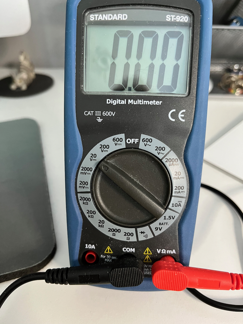

                          if im correct with my voltmeter the ohms setting is on the bottom ???
                          Correct. You are on the DC volts scale and the 20 setting denotes the max voltage that you can measure on this setting. If you reach 21v (as an example), the meter should report 'OL' or '1' = over limit status.
                          Then you should select a higher meter scale on the DC volts till you have a proper reading.
                          Yes, resistance scales are more counter-clockwise to this DC volts setting and with the ohms symbol.

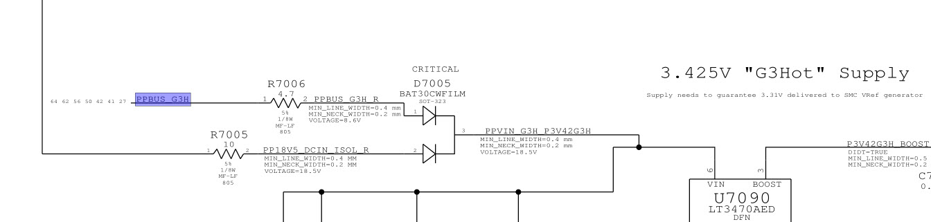

                          Although you have a LED on for the magsafe head, confirm the voltage readings on:
                          pin # 1, pin # 2 and pin # 3 of D7005.
                          Red meter probe on pin # 1; black meter probe to ground. What is the voltage ?
                          Repeat with red probe on pin # 2 & ground and finally pin # 3 and ground. Post each measurement.

                              No - we are not reading resistance at this time. Later, perhaps. Now you need to leave the meter on the 20V DC scale like your picture you posted.

                                    Review and post the voltages on the D7005 dual diode - see above on the details. This is for a critical voltage leg which has to be 3v42 (suspecting it is ok since you have a LED on for your magsafe). Small concern is that there are lots of fake chargers on the market and can cause the LEDs to turn on regardless of this voltage rail.

                                        Re: MacBook Air Early 2015 13" No Power
                                        ok on pin 1 I get 8.5V
                                        and on pin 2 I get 14.9V
                                        and on pin 3 I get 14.7V
