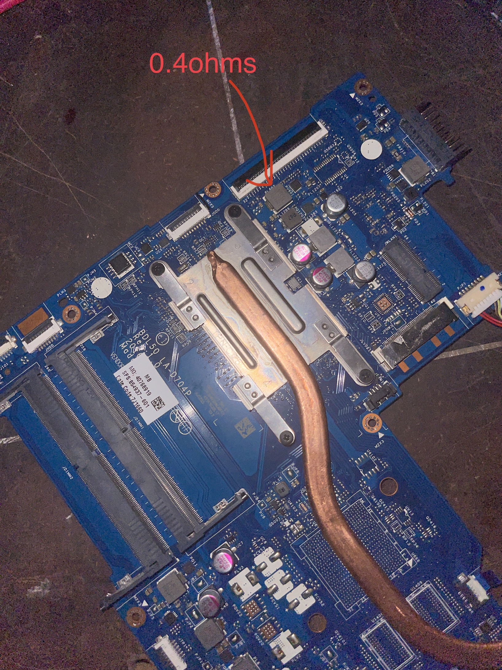

        #43
        Re: HP - LA-D704P Rev 1.0 No Power Motherboard HELP
        Originally posted by mon2
        It is important to note again that the mosfets attached to pu301 are dual mosfets inside the single package.
        Post your measurements and the pins used for each resistance check.
        PQ301(Mosfet removed. values taken from the pad)
        Source(5,6,7) to drain(2,3,4) -----> 6.38kohms
        Source(5,6,7) to Gate1(1)-----> No value
        Source(5,6,7) to Gate2(8)------> No Value
        drain(2,3,4) to Gate1(1)-----> No value
        drain(2,3,4) to Gate2(8)------> No Value
        D2/S1(pin9) to ground-----> 0.4ohms (this is the short I guess)
        PQ302(Mosfet is on the board)
        Source(5,6,7) to drain(2,3,4) -----> 6.36kohms
        D2/S1(pin9) to ground-----> 8.07kohms

          #44
                Putting out our own local fires so immediate replies are not always possible. Have an ipad from h*ll that almost burnt the owner's hands - good job Apple / Foxconn. Wage bonus for the design engineers. Just purchased the over priced thermal camera from Qianli which is not really helping. Any metal object is showing a higher temp than the parts. My hands are on 'fire' from the thermal view. Perhaps a learning curve here...
                Not good. So the short is either INSIDE the power supply IC @ PU301 if it is still soldered onboard OR could be downstream since the inductor PL302 is onboard.
                Start with lifting one leg of PL302 coil / inductor. Once this leg is removed, check the same pin # 9 of the dual mosfet resistance to ground.
                If the short is gone, then the short is INSIDE the power supply IC PU301.
                Post your test results.

                                #55
                                Remove all power. What is the resistance to ground of your CPU Vcore rail ?
                                I see 4 Inductors.
                                1---> 18.2ohms
                                2----> 17.6ohms
                                3----> 32.7ohms
                                4-----> 0.4 ohms
                                See the attachment.
                                • mon2
                                  • Dec 2019
                                  • 14665
                                  #56
                                  When you inject the voltage at the earlier 3v3 site, do you see any voltage at the coil with the 0.4 ohms ?

                                    #57
                                    1v with 2.4A injected again.
                                    No voltage at any of those 4 coils.

                                      #58
                                      Yet, someone is consuming this current when you inject the voltage. The part is just not warm or hot enough for you to sense the location. Perhaps the part is on the bottom side?
                                      At your discretion, this is risky, but you can consider to dial up the voltage to a higher voltage but must remain under the expected 3v3 (max). Suggest, perhaps 1v5. Test again with the injection. The risk is if some mosfet is leaking and hits a low voltage rail at which point this higher voltage will kill that part.

                                        #59
                                        Injected upto 2.7V at max 5A. I'm afraid to go more. however nothing heats up. How is that possible. I checked both sides of my board. nothing heats up.
                                        However after 2-3 minutes My DC power supply fan gets on. I guess he is the person who heat by seeing this.
                                        What can we do?
