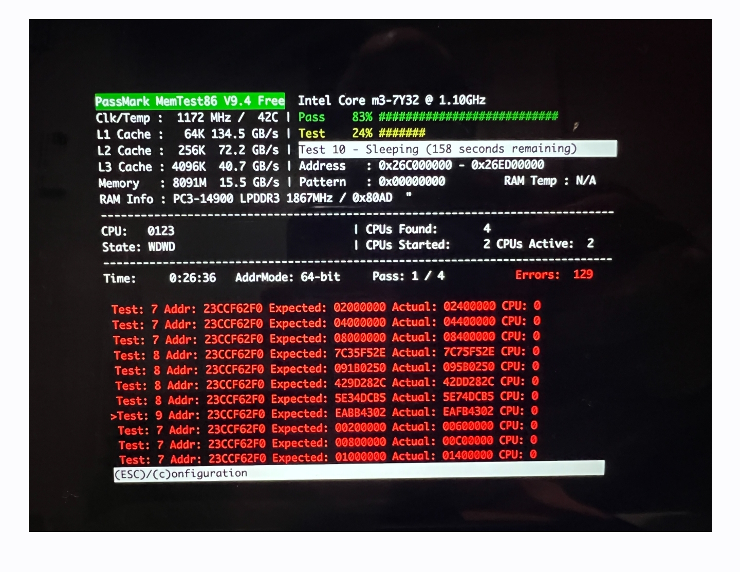

Memtest errors on A1534
  • sikocan
    • Oct 2019
    • 344
    A1534 model
    Serial C02WP2Q3HH21
    From client notes:
    OS upgrades don't proceed as usual - they fail with errors.
    Running memtest86 produces multiple errors.
    Can this be fixed or replace motherboard? Thanks!

    Re: Memtest errors on A1534
    A1534 famous for cpu issues, probably best to ditch this model, or replace MB.
    • sikocan
      • Oct 2019
      • 344
      • mon2
        • Dec 2019
        • 14633
        Likely not worth the effort as noted but you have a stuck memory bit at this location. The "20" is returning "24" and the pattern is the same throughout this location.
        See here on the process to replace the ram:
        https://youtu.be/yjFAr5nM4YU
        Could be a dry solder joint but a reflow may cause additional issues.
