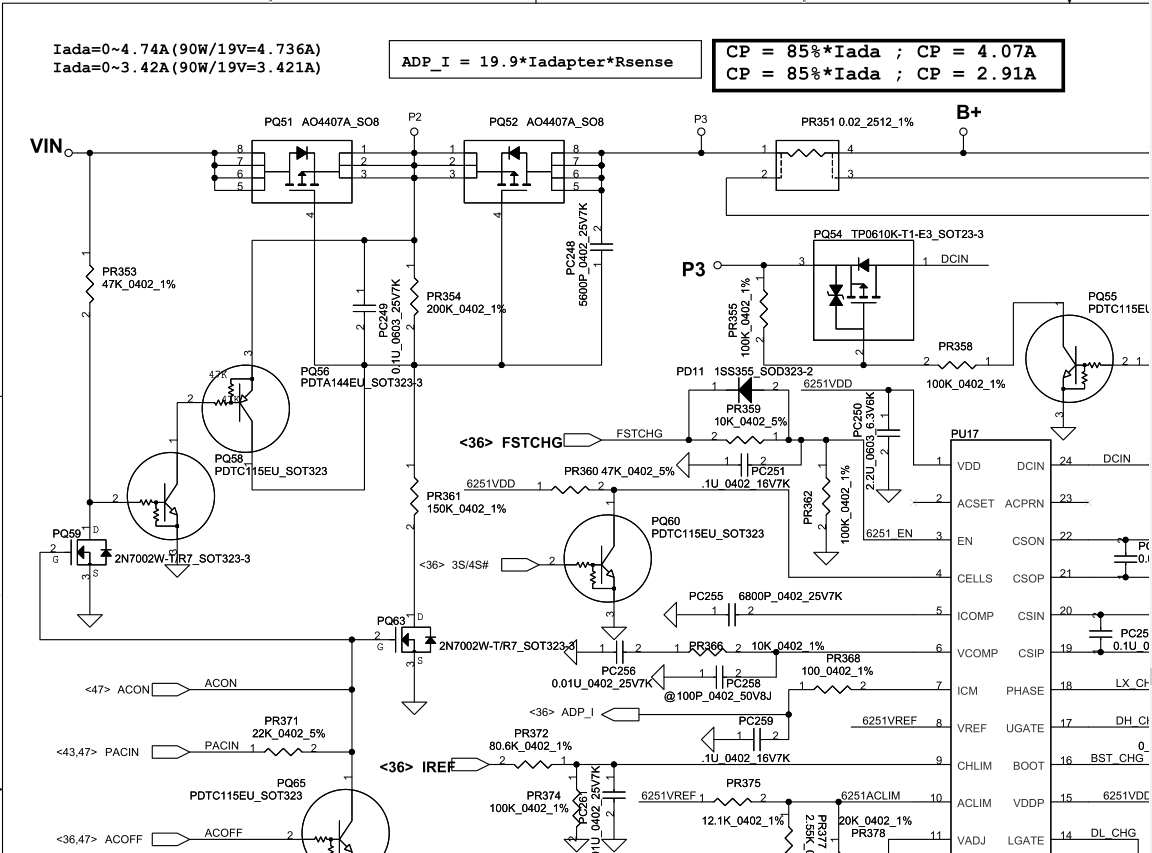

              Re: acer 5742g power on 1secand
              Start with checking the voltages on mosfets PQ51 & PQ52.
              See attached.
              • ddhlawi
                • Feb 2017
                • 165
                • algerian
                18 v
                • mon2
                  • Dec 2019
                  • 14093
                  Post the voltages on each pin and each mosfet.
                  Source pins will be 1-2-3 ; pick one
                  Gate pin will be 4
                  Drain pins will be 5-6-7-8 ; pick one

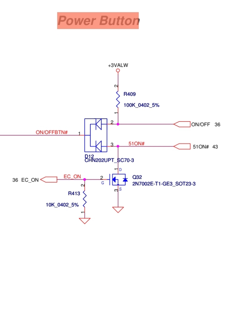

                    If you have 18V at switch, check 51ON# circuit.
                      source pin is 19v gate 8v drain 19v
                      • mon2
                        • Dec 2019
                        • 14093
                        Same readings for both mosfets?
                        Remove all power. Meter in resistance mode
                        Check the resistance of each of these mosfets:
                        Source and drain
                        Source and gate
                        Gate and drain
                          ec_on 0v
                          • usyusy
                            • Sep 2021
                            • 171
                            • Pakistan
                            Originally posted by ddhlawi
                            ec_on 0v
                            flash clean and tested bios and check sio requirements
