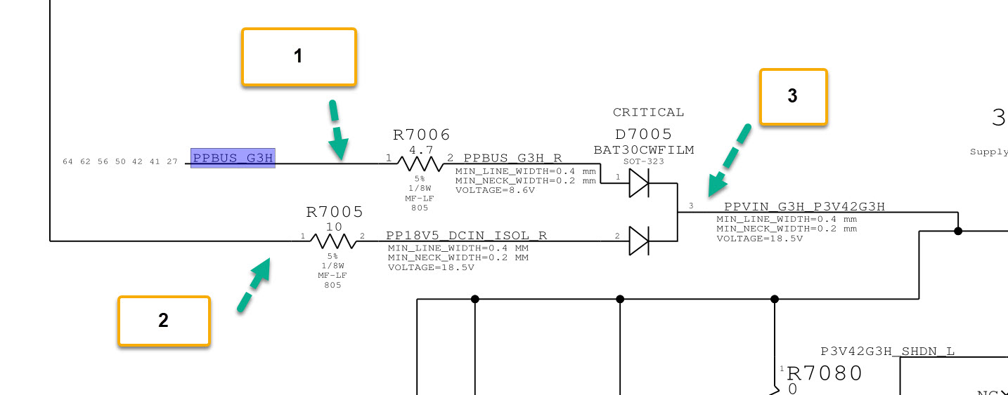

    Hi I have a 820-00165 with a known good and working DC-In board, currently that is the only thing connected to the board. No green light on charger.
    PPDCIN_G3H = 15.04V
    PPDCIN_G3H_ISOL = 15V
    PPBUS_G3H = Moves around between 0.6V and 1.4V in no specific pattern (Measured on both sides of F7140)
    PPBUS_G3H resistance to GND measures OL
    PPBUS_G3H seems too low. Any ideas?
    Boardview and schematic attached.

    Re: 820-00165 Low Voltage on PPBUS_G3H, No Green Light, No Power
    Hi. See attached.
    1) Remove fuse F7140.
    2) Power up without the fuse F7140 and check the voltage of PPBUS_G3H @ F7140, pad # 1. This will be the output of this regulator before the fuse (L7130, pin # 2).
    What is the voltage without any load on PPBUS_G3H ?
    3) Next, check the voltages at the points referenced by the arrows. Post the measurements.

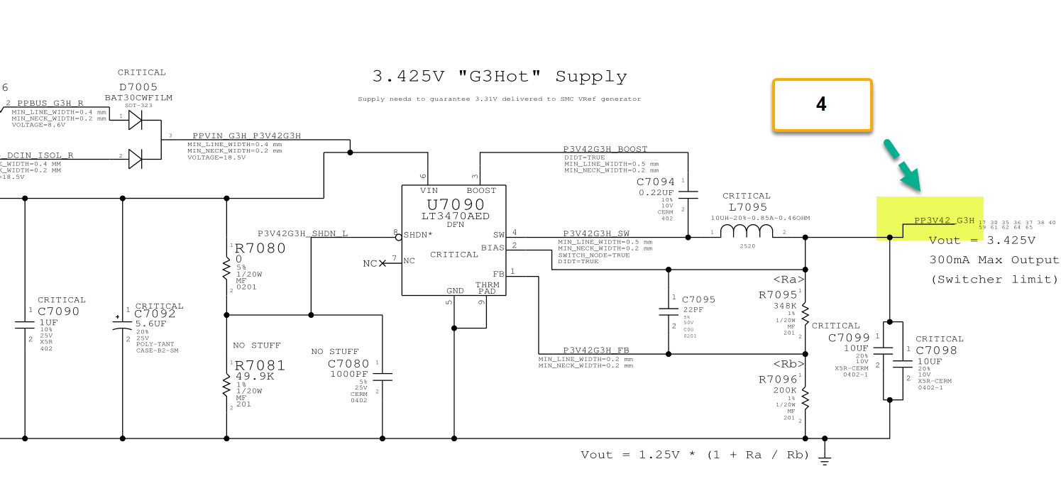

      you wont have correct ppbus if your missing pp3v42, make sure you have that first.
      once that is sorted move on to ppbus g3h

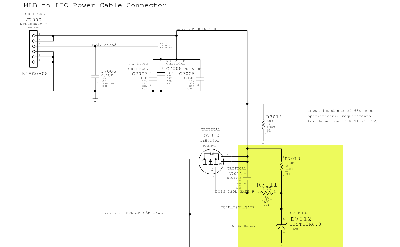

        This means that you do not have PP3V42_G3H. The PP3V42_G3H rail is required to power the single wire communication that turns the LED inside the magsafe head GREEN / ORANGE.
        You may not have PP3V42_G3H if Q7010 is OFF.
        Q7010 will be off if the voltage @ R7010 / R7011 junction is not ~6v8.
        Confirm the voltage at:
        a) Q7010, pin # 1 (drain) = PPDCIN_G3H_ISOL
        b) R7010 & R7011 junction
        c) Q7010, pin # 4 = GATE
          Originally posted by mon2
          Hi. See attached.
          Without F7140 I consistently get green and then orange light on charger. Both sides of fuse >10MOhm so doesn't appear to be shorted directly.
          Voltage on pin 1 of F7140: 8.58V
          Pin 1 of R7006: 0.7V
          Pin 1 of R7005: 15.08V
          Pin 3 of D7005: 14.68V
