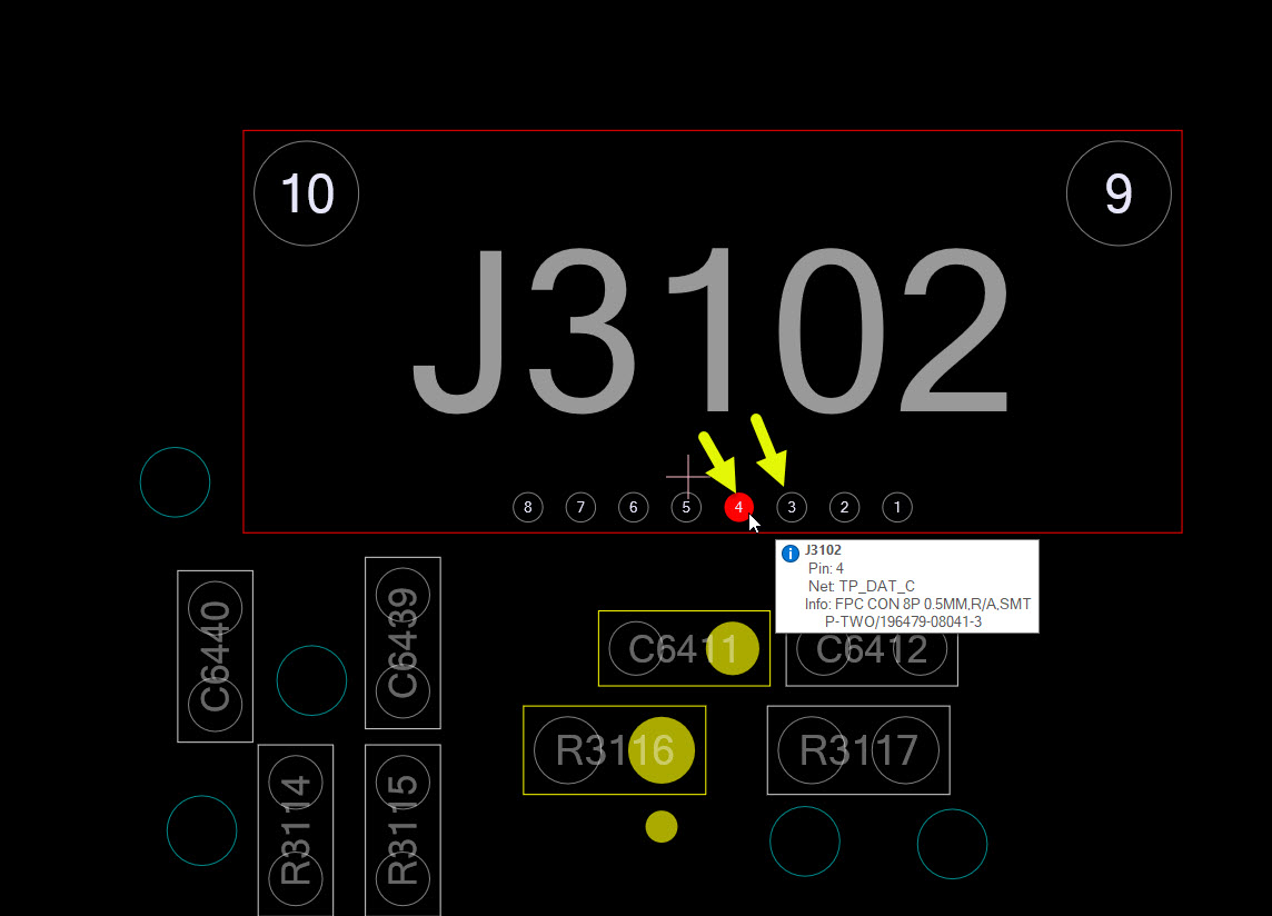

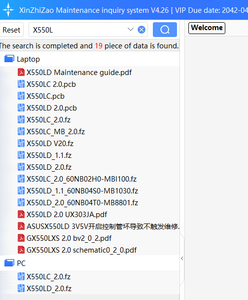

asus x550l wont react to power button
  • mosfetratus
    Sure Not
    • Feb 2019
    • 174
    • Resistron
    asus x550l wont react to power button
    It has 5V, 3.3V. No shorts on coils. Power button works correctly, when pressed voltage drops.
    One time turned on. Not sure how.
  • mon2
    • Dec 2019
    • 14313
    Re: asus x550l wont react to power button
    Which board is yours ?
      • 21137
      Re: asus x550l wont react to power button
      https://www.badcaps.net/forum/showthread.php?t=88758
      When requesting help, please attach a picture of the board with voltage and resistance to ground measurements on all the large inductors after triggering power button.
      • mon2
        • Dec 2019
        • 14313
        Re: asus x550l wont react to power button
        When requesting help, please attach a picture of the board with voltage and resistance to ground measurements on all the large inductors after triggering power button.
        ..but resistance checks are to be performed always with the power OFF and with NO battery.
        • mosfetratus
          Sure Not
          • Feb 2019
          • 174
          • Resistron
          Re: asus x550l wont react to power button
          fixed by removing cmos battery and waited for some time, after few tries it worked. BIOS went mad i guess.
          Other problem. trackpad doesnt work. I have second trackpad, and it doesn't work too.
          Under windows 10, device manager is not detecting any trackpad. Doesnt work on latest ubuntu and windows 7 install setup.
          Asus smart gesture driver is installed (W10).
          x550ld rev. 2.0
          Last edited by mosfetratus; 07-07-2022, 08:46 AM.
          • mon2
            • Dec 2019
            • 14313
            Re: asus x550l wont react to power button
            Review the voltages on the J3102 connector.
            Most interested in the voltage readings of pins 3 & 4 which are the TP I2C interface pins (SDA & SCL).
            Meter in DC volts scale (5 volts or higher is ok).
            Red meter probe on pin # 3 of the connector; Black meter probe to ground.
            • mosfetratus
              Sure Not
              • Feb 2019
              • 174
              • Resistron
              Re: asus x550l wont react to power button
              Originally posted by mon2
              review the voltages on the j3102 connector.
              Most interested in the voltage readings of pins 3 & 4 which are the tp i2c interface pins (sda & scl).
              Meter in dc volts scale (5 volts or higher is ok).
              Red meter probe on pin # 3 of the connector; black meter probe to ground.
              1. - 0.00v
              2. - 3.34v
              3. - 3.34v
              4. - 0.00v
              5. - 3.34v
              6. - 0.00v (2.80V when linux is booted).
              7. - 0.00v
              8. - 3.34v
              Last edited by mosfetratus; 07-07-2022, 10:21 AM.
              • mon2
                • Dec 2019
                • 14313
                Re: asus x550l wont react to power button
                3. - 3.34v
                4. - 0.00v
                Pin 3 : OK
                Pin 4 : something is wrong here. This should also be ~3v3.
                Remove all power -> check your cabling. Remove the cable for now.
                Power up and check the voltage on pin # 4 again. Still 0v ?
                If yes, power down again -> meter in resistance mode (lowest scale is ok).
                Check the resistance to ground of pin # 4 of this TP connector J3102.
                Post the measurements.
                • mosfetratus
                  Sure Not
                  • Feb 2019
                  • 174
                  • Resistron
                  Re: asus x550l wont react to power button
                  Originally posted by mon2
                  Pin 3 : OK
                  Pin 4 : something is wrong here. This should also be ~3v3.
                  Remove all power -> check your cabling. Remove the cable for now.
                  Power up and check the voltage on pin # 4 again. Still 0v ?
                  If yes, power down again -> meter in resistance mode (lowest scale is ok).
                  Check the resistance to ground of pin # 4 of this TP connector J3102.
                  Post the measurements.
                  i measured connector only, without trackpad attached.
                  Resistance of pin 4. is 0.1ohm - shorted.
                  • mon2
                    • Dec 2019
                    • 14313
                    Re: asus x550l wont react to power button
                    Resistance of pin # 4 = ~0 ohms to GROUND ?? (no power when testing resistance)
                    • mosfetratus
                      Sure Not
                      • Feb 2019
                      • 174
                      • Resistron
                      Re: asus x550l wont react to power button
                      Originally posted by mon2
                      Resistance of pin # 4 = ~0 ohms to GROUND ?? (no power when testing resistance)
                      Yes :\
                      • mon2
                        • Dec 2019
                        • 14313
                        Re: asus x550l wont react to power button
                        Ouch! Review if you have a visible short on this line. According to the boardview diagram, this is a signal line and should be ~3v3 with no activity. This is common to I2C bus interfaces - the local pull-up performs this task.
                        The resistance is very low so suspecting that there is a solder short or a bad cap. Hunt the area for clues.
                        Possible short could be to pin # 5 = GROUND on the same connector.
                        • mosfetratus
                          Sure Not
                          • Feb 2019
                          • 174
                          • Resistron
                          Re: asus x550l wont react to power button
                          Originally posted by mon2
                          Ouch! Review if you have a visible short on this line. According to the boardview diagram, this is a signal line and should be ~3v3 with no activity. This is common to I2C bus interfaces - the local pull-up performs this task.
                          The resistance is very low so suspecting that there is a solder short or a bad cap. Hunt the area for clues.
                          Possible short could be to pin # 5 = GROUND on the same connector.
                          https://www.badcaps.net/forum/showthread.php?t=65391
                          your boardview file is wrong.
                          pin 4 is ground. Which is correct. No problem with pin 4.
                          pin 5 is TP_DAT
                          pin 6 is TP_CLK
                          Last edited by mosfetratus; 07-07-2022, 12:17 PM.
                          • mon2
                            • Dec 2019
                            • 14313
                            Re: asus x550l wont react to power button
                            Ok. So the TP connector = J3101.
                            What are the resistance readings for pin # 5 and # 6 to ground ?
                            Also measure the voltage on each pin.
                            • mosfetratus
                              Sure Not
                              • Feb 2019
                              • 174
                              • Resistron
                              Re: asus x550l wont react to power button
                              Originally posted by mon2
                              Ok. So the TP connector = J3101.
                              What are the resistance readings for pin # 5 and # 6 to ground ?
                              Also measure the voltage on each pin.
                              pin 5 and pin 6 is 11kOhm
                              pin 5 is always 3.34V
                              pin 6 is 0V when bios, windows 7 setup. And 2.8V when in linux.
                              C3004 is OK
                              RN3034 is OK
                              only suspect is U3001
                              Last edited by mosfetratus; 07-08-2022, 01:30 AM.
                              • mosfetratus
                                Sure Not
                                • Feb 2019
                                • 174
                                • Resistron
                                Re: asus x550l wont react to power button
                                FIXED
                                Was bad trackpad + bad cable.
                                Working trackpad had broken cable [From the laptop with BIOS problems].
                                Not working trackpad had good cable [From the laptop with trackpad "problem"].
                                • TimeRabbit07
                                  Asus FX517ZC charges but power button does nothing
                                  by TimeRabbit07
                                  Hi all!
                                  I've got an Asus FX517ZC on the bench at the moment and I just can't figure out what's going on with it.
                                  Here are its various numbers and identifiers:
                                  Model short: FX517Z
                                  Model long: FX517ZC-HN114W
                                  SN: NANRCX01S57842E
                                  CN: 3SDB 12M
                                  MFD: 2022-10
                                  Motherboard model: DA0NJLMBAE0 REV E
                                  Symptoms:
                                  The laptop's charge light comes on, but when the power on button is pressed nothing happens. No fan spin, no caps lock, no screen or keyboard backlight, nothing.
                                  History so far:
                                  The...
                                  09-04-2024, 05:48 PM
                                • themosttogain
                                  HP Envy 13-BA1565na with intermittent power button
                                  by themosttogain
                                  Hope someone can give me some suggestions on this because i'm at my wits end with it...
                                  I have an Envy 13-BA1565na here with an Intel Core i7 i7-1165G7 CPU (board is a LA-J475P Rev 1.0) which has an intermittent power button issue. The power button is integrated into the keyboard, and I have ruled out the keyboard, BIOS and battery as being the issue.
                                  Basically, on mains power, the power button works fairly well. The first time you come to it after leving it sitting (either on charge or not on charge), it might take 2 or 3 presses of the button, but then the laptop boots...
                                  07-12-2024, 03:03 AM
                                • ShadowAi
                                  ASUS TUF X570-PLUS doesn't power on: no VRM_EN signal.
                                  by ShadowAi
                                  Hello, I have an issue with the motherboard. Specifically, it doesn't power on, more precisely, the POST initialization doesn't occur.
                                  Let me start from the beginning, the motherboard suddenly stopped working one day. There are no beep signals from the speaker, and the debug LEDs are not lighting up. After inspecting it under a microscope and using thermal imaging, I didn't find anything that could be damaged.
                                  After that, I began voltage measurements, in which I noticed the absence of VDDQ, VDDP, VTT, and VPP lines. Later, I checked if there is an EN state on these lines,...
                                  03-15-2024, 10:46 AM
                                • myth77
                                  Asus Gl753, gl553, fx553 keyboard power button not working
                                  by myth77
                                  I have i think 4 dead keyboards from laptops in the title...they are very similar...almost the same...and all of them have not working power buttons. All other keys are working...but when you press power button it doesnt short 3.3v to gnd...so you can only do it manually on the keyboard conector with tweezers or similar. I inspected in every detail ribbon cable that is going to the motherboard connector and removed power key button from keyboard to see anything wrong there, but all seems perfect.
                                  Has anyone with more expirience figured where is that power button line getting broken? because...
                                  07-13-2023, 12:30 PM
