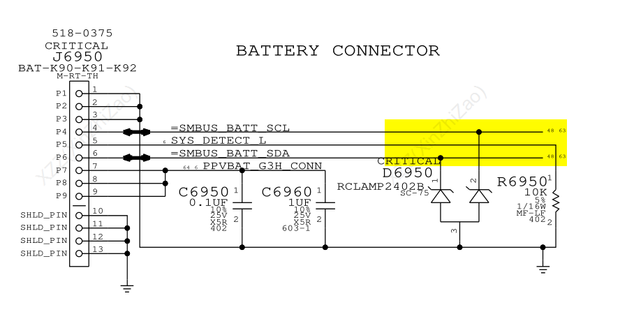

                • mon2
                  • Dec 2019
                  • 14213
                  Measure the voltage to ground of each pin on the battery connector. Interested in the SMBUS SCL and SDA voltage measurements. The same SMBUS interface is used to configure the PPBUS_G3H voltage by the SMC. My bad - I think you are ok on PPBUS_G3H and the voltage is ~12v6 after boosting.
                  Try a new reflashed bios. Can post some if needed.
                  Click image for larger version  Name:	smbus_D6950.png Views:	0 Size:	73.5 KB ID:	3281796
                  • Sergio Kub
                    • Jul 2018
                    • 169
                    • Brasil
                    J6950
                    1, 2, 3 GND 0V
                    4 - 3.456V
                    5 - 0V
                    6 - 3.456V
                    7, 8, 9 - 12.08V
                    * Measurements with the battery plugged in

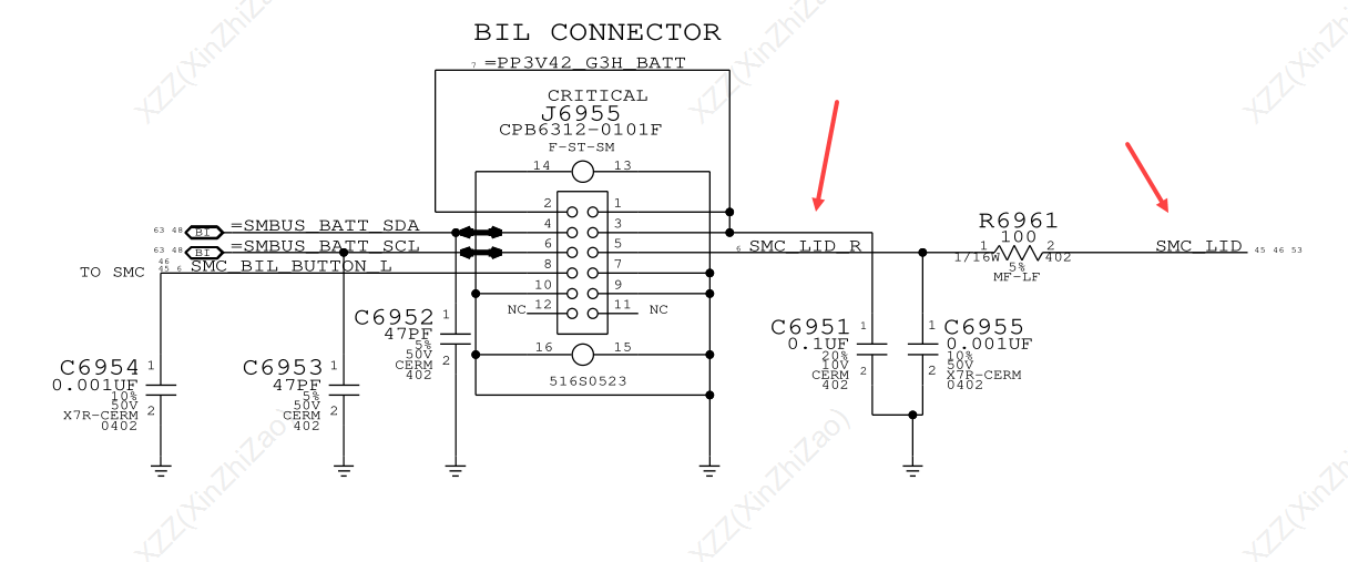

                              @mon2
                              Can you help me with this defect. I took several measurements and compared them and everything seems to be ok. Sleep light is on, stuck.
                              • mon2
                                • Dec 2019
                                • 14213
                                Check the voltage to ground of the attached. This signal is from the lid sensor that is working with the trackpad.
                                • Sergio Kub
                                  • Jul 2018
                                  • 169
                                  • Brasil
                                  Voltage to ground 3.125V on both sides of R6961 and C6951 3.47V
                                  • mon2
                                    • Dec 2019
                                    • 14213
                                    Close the lid and check the same points.
                                    • Sergio Kub
                                      • Jul 2018
                                      • 169
                                      • Brasil
                                      Closed the lid Pin5-C6955=0V Pin3-C6951=3.125V
                                      • Sergio Kub
                                        • Jul 2018
                                        • 169
                                        • Brasil
                                        I noticed that when I close the lid, without the bil connector connected, the standby light goes off.
