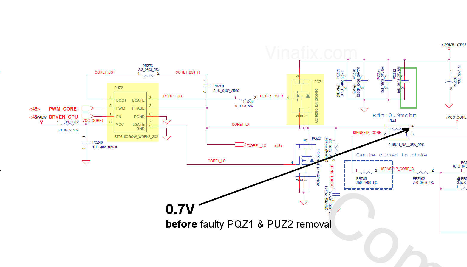

    Hi guys !
    this laptop came yesterday because turns on but won't POST, only a black screen and CPU becomes a little hot.
    After usual checks (RAM, PSU, CMOS reset, caps discharge...) I've removed the M/B and find these:
    • PQZ1 exploded: half onboard, half stuck on keyboard...
    • a hole in PUZ2
    (see attached pics)
    Both have been removed.
    +VCC_CORE looks a short to GND (what resistance to GND should measure ?)
    PQZ2, PQZ3 & PQZ4 have been removed and checked against shorts (S-G, S-D, G-D).
    The following have been checked working:
    - PC9100
    - PC9101
    - PC9102
    What else can I check before replacing PQZ1 & PUZ2 ?

      Right after removing bottom case (so dead PQZ1 & PUZ2 were still soldered), I've measured about 0.7V @VCC_CORE...is there a chance CPU can still be working ?

          PUZ2 is a dual mosfet driver
          PQZ1 is a high side mosfet
          Can I inject a very low voltage (ie starting from 0.5-0.6V) on VCC_CORE to check if SOC is really shorted or (maybe) some caps on the other side (see pics) ?
          Thank you !

              Tried injecting the following voltages on VCC_CORE:
              • 0.6V @ 1A -> 0.4V (VCC_VCORE multimeter reading)
              • 0.75V @ 1.5A -> 0.5V
              • 0.9V @ 2A -> 0.67V
              At 0.9V@2A SOC started to heat up a little bit (barely detectable with the finger)

                      PQZ1 & PUZ2 replaced
                      VCC_Core = 0.79V
                      Timeline:
                      - 0: push power button, no display, power led turn blue, fan spin
                      - 5s: fan turn off
                      - 22s: power led turn off
                      - 26s: power led turn blue, fan spin
                      - 32s: fan turn off
                      - 60s: the SOC become hot, fan turn on and doesn't turn off anymore
                      SOC RIP ?

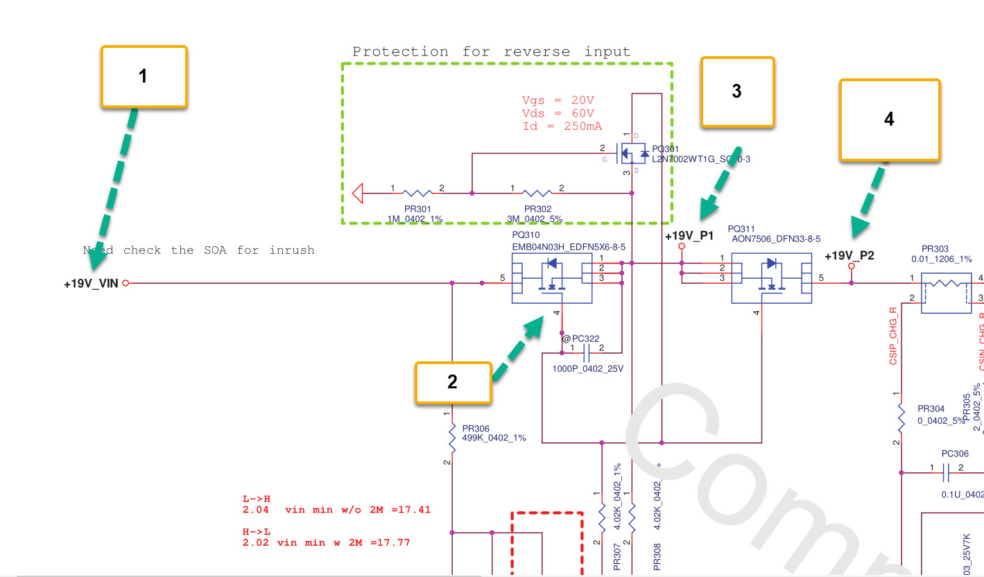

                              From the schematic -> appears that the BLUE led is from the battery ?
                              Can you remove or disconnect the battery and attempt the same power up with the official known good power adapter ?
                              Also, with the adapter (only) check the DCIN mosfets which are often a root cause of all evil.
                              Perhaps baggage X-rays nuked the bios but too early to tell (although they claim they are safe to electronic equipment). The bios will then have to be reflashed.
                              See attached -> measure the voltage at the referenced checkpoints. Post the readings.

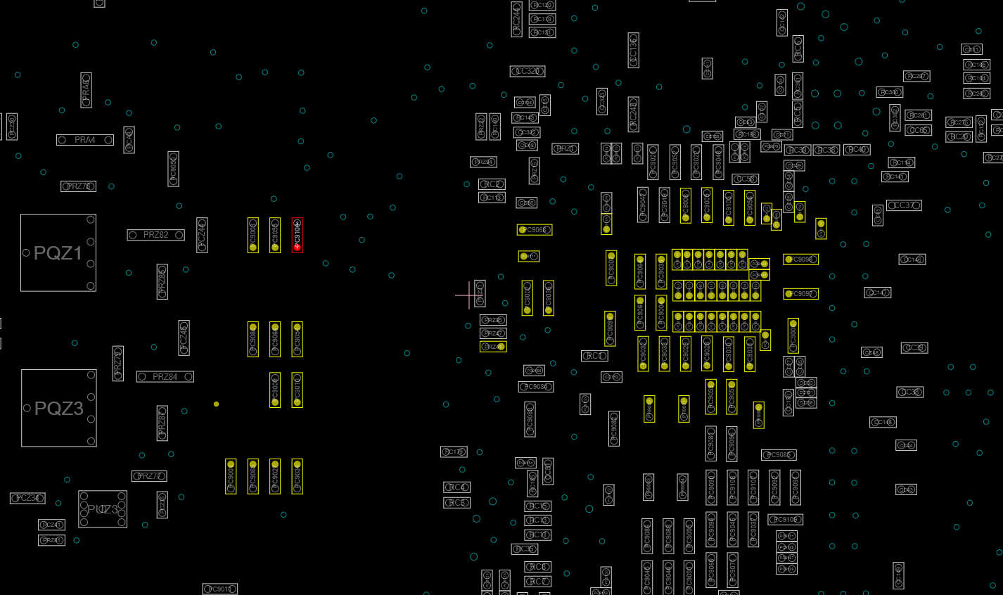

                                        Sounds good but do also check the resistance to ground of the VCC_CORE rail. Remove all power -> meter in resistance mode -> post the reading to confirm the CPU is still ok.
