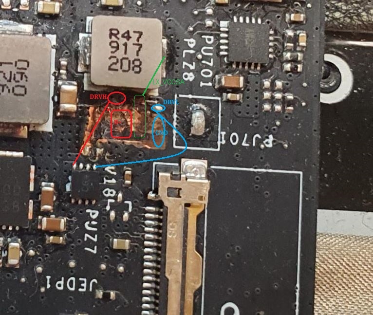

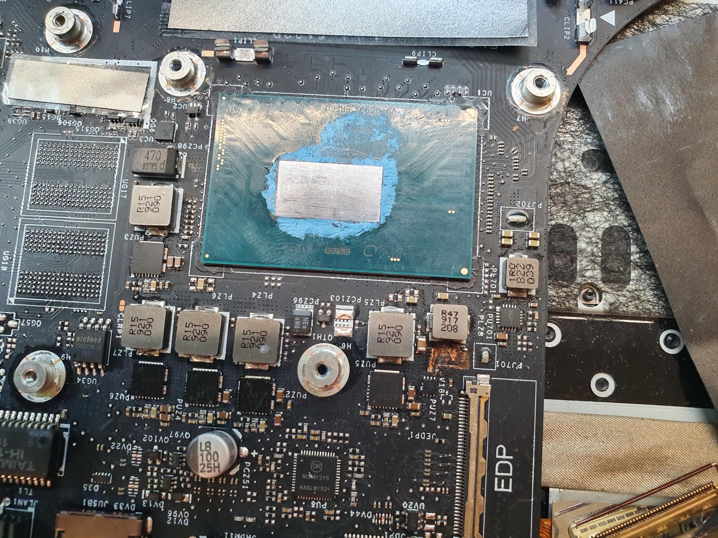

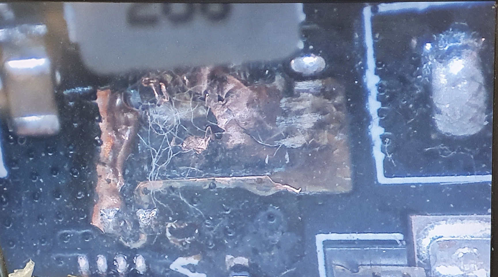

    PQZ1 was taken out by someone else.
    its probably a dual mosfet. but all traces destroyed ,so hard for me to tell what goes to where
    does anyone have a boardview or schematics. or a high quality picture to tell which ic is PQZ1

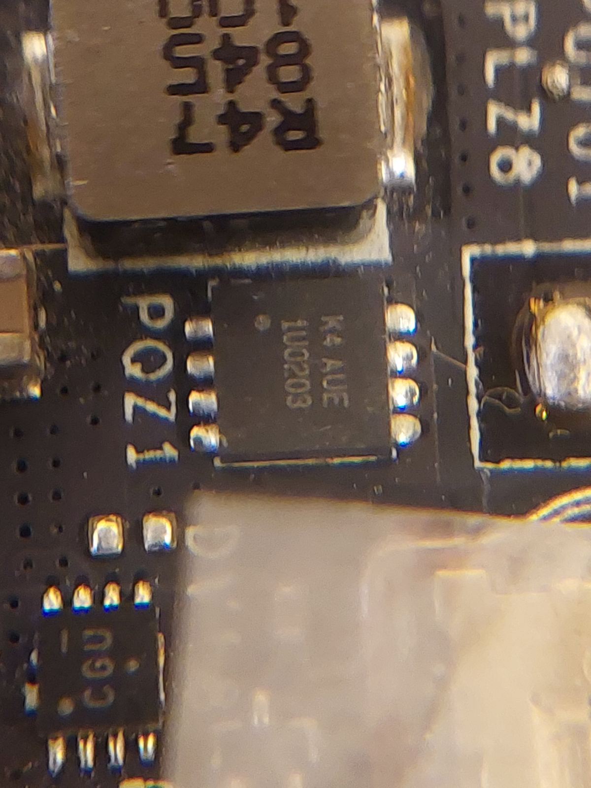

    Here you go.
      • 21821
      Re: Lenovo Legion Y740-15ICHg LA-G132P blown PQZ1 mosfet
      K4 *** PE642DT https://www.badcaps.net/forum/showpo...65&postcount=4

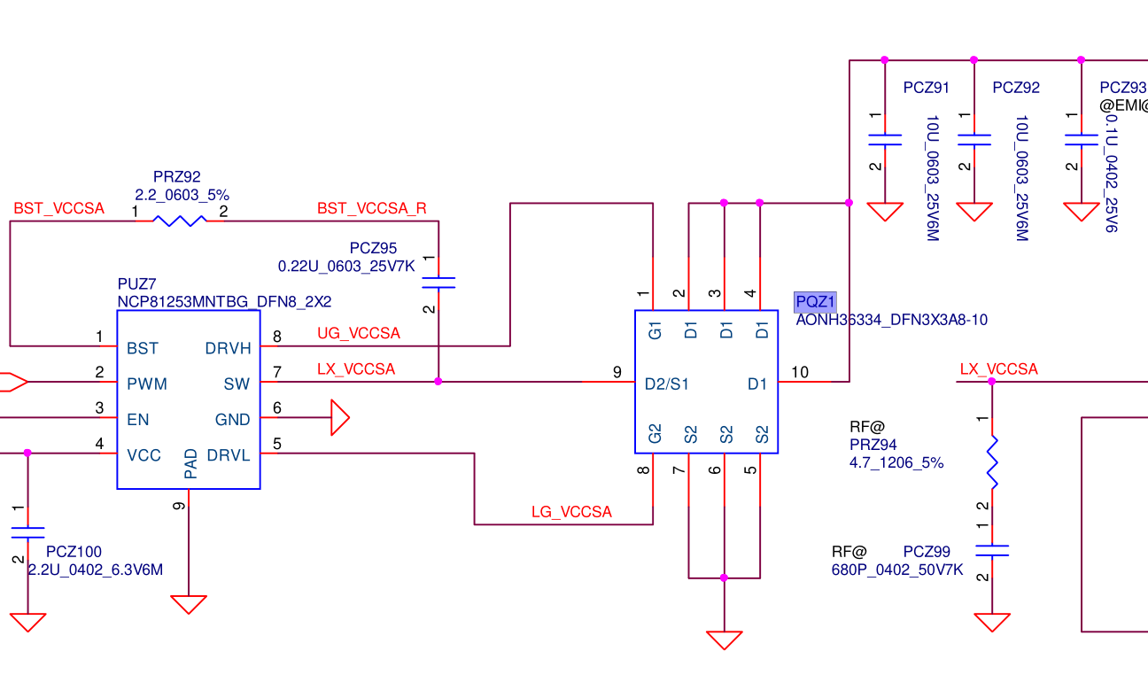

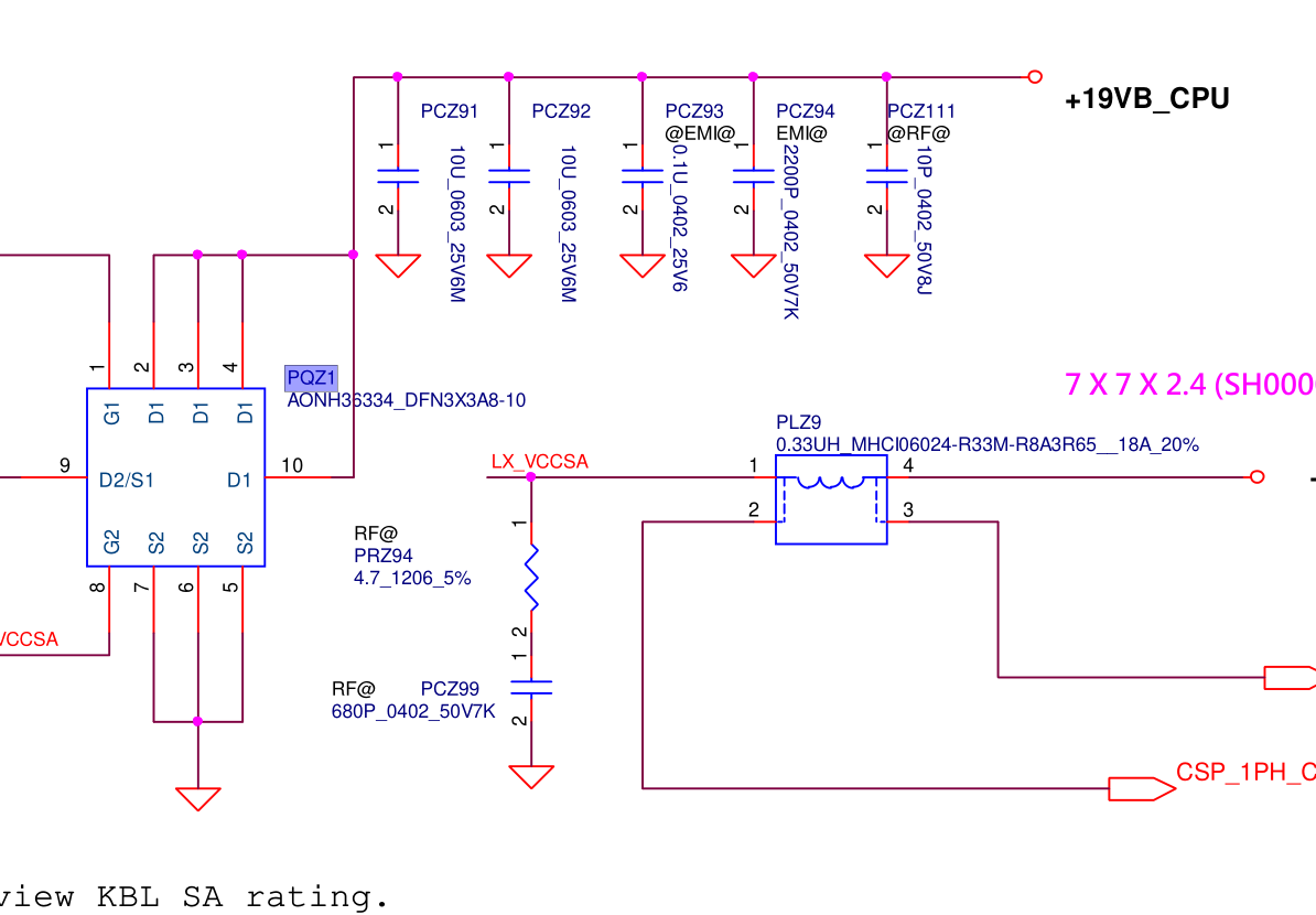

          Y750 has a PQZ1 dual mosfet.
          See attached - again from a Y750 - likely very close or same as the Y740.

            I have same problem how i can recover trace ?

              Schematic...
              [MOD EDIT]
              Link to Schematic - https://www.badcaps.net/forum/showthread.php?p=1285883
                LA-G132P schematic .
                [MOD EDIT]
