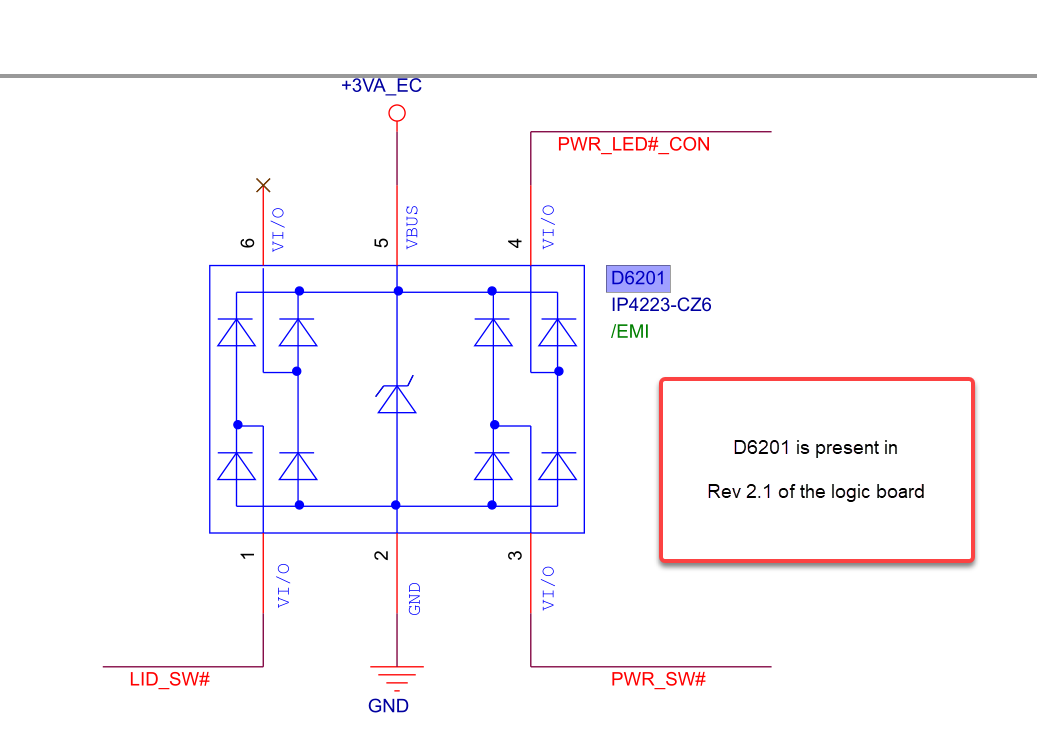

          Ok. See attached.
          There is no D6201 inside my schematic for Rev 2.0 for the logic board.
          There is a D6201 inside the Rev 2.1 schematic.
          Remove all power. Meter in resistance mode (lowest scale).
          Check the resistance to ground with one meter probe on
          PWR_SW#
          and the other meter probe to ground.
          What is the resistance reading in ohms ? Also post the meter scale used for the measurement.

              Re: Asus X550JX rev 2.0 not power on !
              Using flux & hot air, remove the ESD device @ D6201. Make a note of the orientation of this device for replacement after this test.
              Then measure again the resistance to ground for pin # 3. Post the reading.
              • lapfix
                • Mar 2020
                • 2719
                • my workshop
                same = 3.530kohm

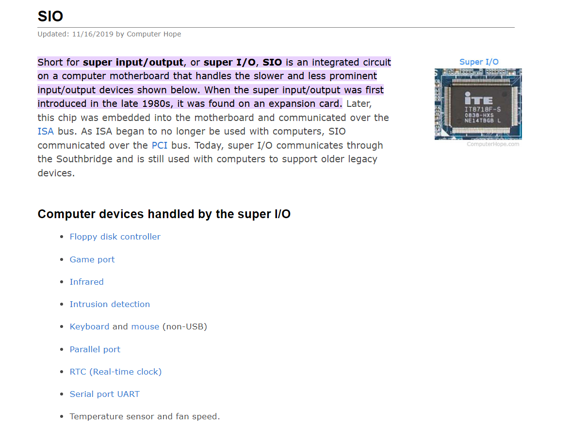

                  • koby058
                    • Jan 2017
                    • 375
                    • israel
                    what is SIO ?
                    • mon2
                      • Dec 2019
                      • 14118
                      Attached.
