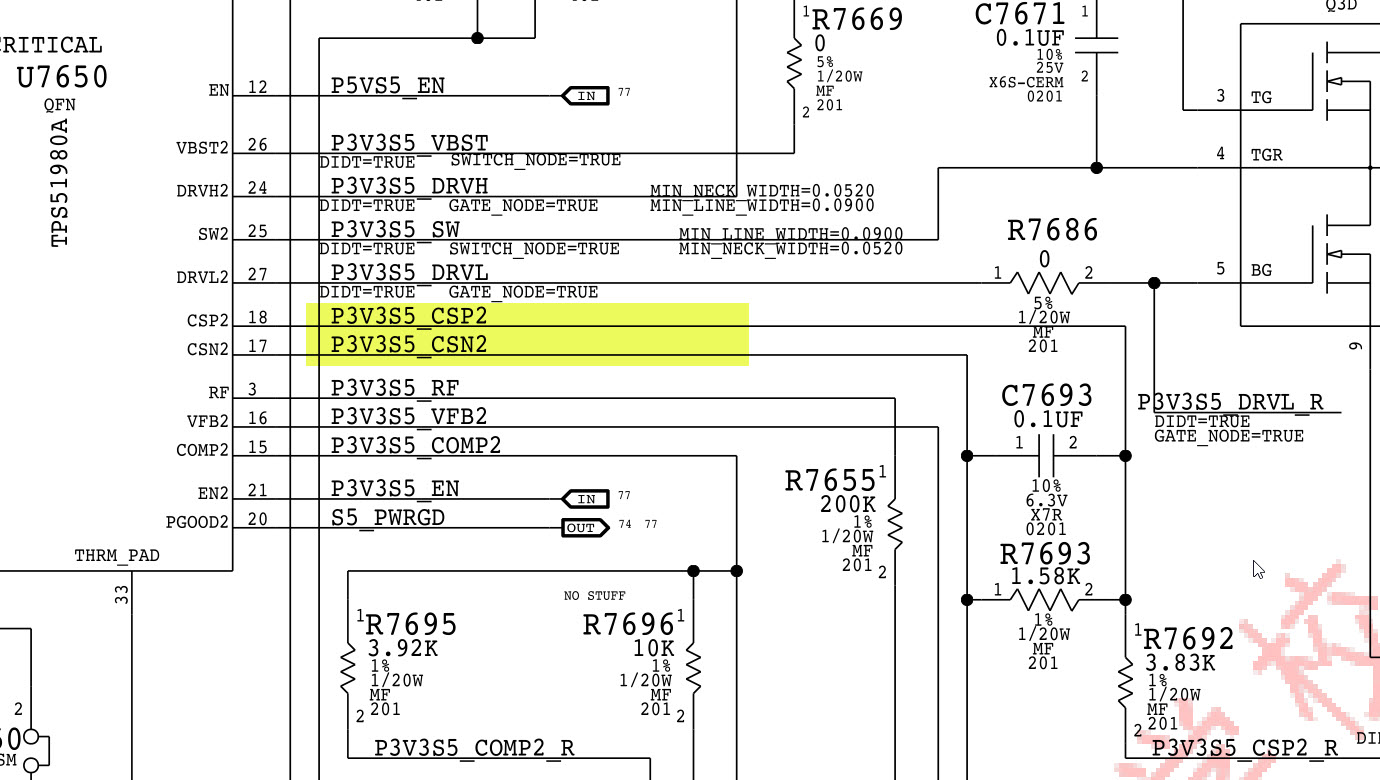

    this a1706 logic board i have was taking 20v and 120mA stucked
    i opened it up and did a visual inspection and it was all good except from U7650 which had some corrosion between the ic and C7651 i tested C7651 and shorted
    so i removed C7651 and U7650 and replaced with new ones
    now i have 20v and 20mA so i started testing that area
    I have:
    pp5v_s5 - 5V
    pp5v_s4 - 0V
    pp3v3_s5 - 0V
    pp3v3_sus - 0V
    p5vs5_en - 3.4V
    p3v3s5_en - 3.4v
    PPBUS_HS_OTH3V3 - 13v
    i know i must have all my s5 in order to have s4 so since i dont have pp3v3_s5 i dont have pp5v_s4
    what im not understanding is why if im having power Vin in U7650 also i have p3v3s5_en why im not having the output of pp3v3_s5 ?
    any help would be really appreciated
    i have osciloscope so i can test anything you suggest
    thanks!

            Measure and post the voltage values of the following:
            P3V3S5_CSN2
            P3V3S5_CSP2

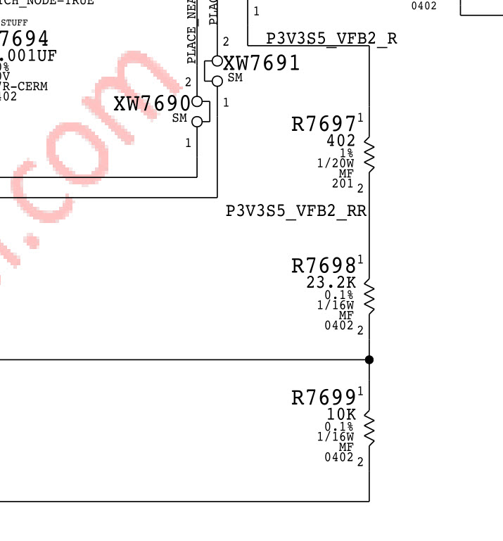

            Remove all power. Meter in resistance mode. Confirm the resistance of the network for the P3V3S5_VFB2 are matching the schematic.
            Specifically, confirm the resistance of:
            R7697
            R7698
            R7699

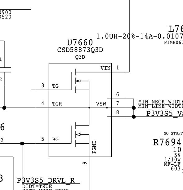

            Still with no power to the logic board, meter in resistance mode, check the resistance of the switching dual mosfet @ U7660.
            Check the resistance of U7660 as follows:
            pin #1 & pins # 6-7-8
            pin #1 & pin # 3
            pin #3 & pin # 6-7-8
            pin #4 & pin # 9
            pin #4 & pin # 5
            pin #5 & pin # 9
            Post the readings.

                ok this is becoming a nightmare
                i have a fully working 820-00239 board so i compared all the measurement you asked me and everything was ok
                when i was taking all those measurement you asked i noticed something weird on U7660 so i changed it after that i powered up the board again and it was taking 20 mA more than before but still not booting of course
                i unplugged and measure PP3v3_S5 again and now its shorted to ground
                i removed u7660 and the short is still there
                so out of the blue now PP3v3_S5 is shorted giving me 1 ohm to ground
                so now i know if i have a short i inject voltage and look with the thermal camera for the hot spot the problem is nothing get warm
                im injecting 1.5v in PP3v3_S5 and my power supply is consuming 2amps so i should get some heat somewhere in the board but im not
                i even removed the heat sink thinking that maybe cpu was getting hot but no its cold as a stone
                so now this is my problem PP3v3_s5 shorted injecting 1.5v getting 2amps but NOTHING gets warm

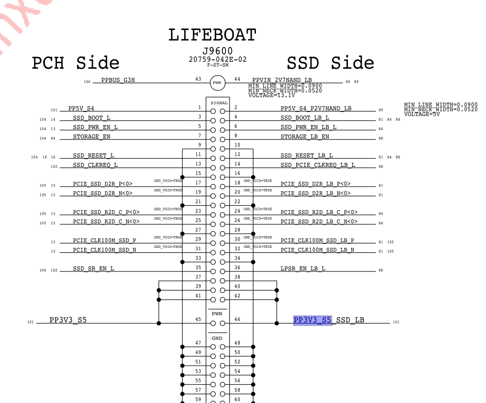

                  Remove (carefully) UB600 and check the resistance of this rail again. It is a DFN package so should be ok to return back if it is not the fault.
                  UB600 is a load switch for this rail.
                  This same rail is also used to power the SSD. Are you able to check the thermals of the SSD devices?
                  Another thought is to remove the LIFEBOAT connector @ J9600 which will then isolate the connection from pins 45 to 46. With this 'top hat' shunting jumper block removed, you can check the resistance to ground again to sub-divide the vicinity of the short.
