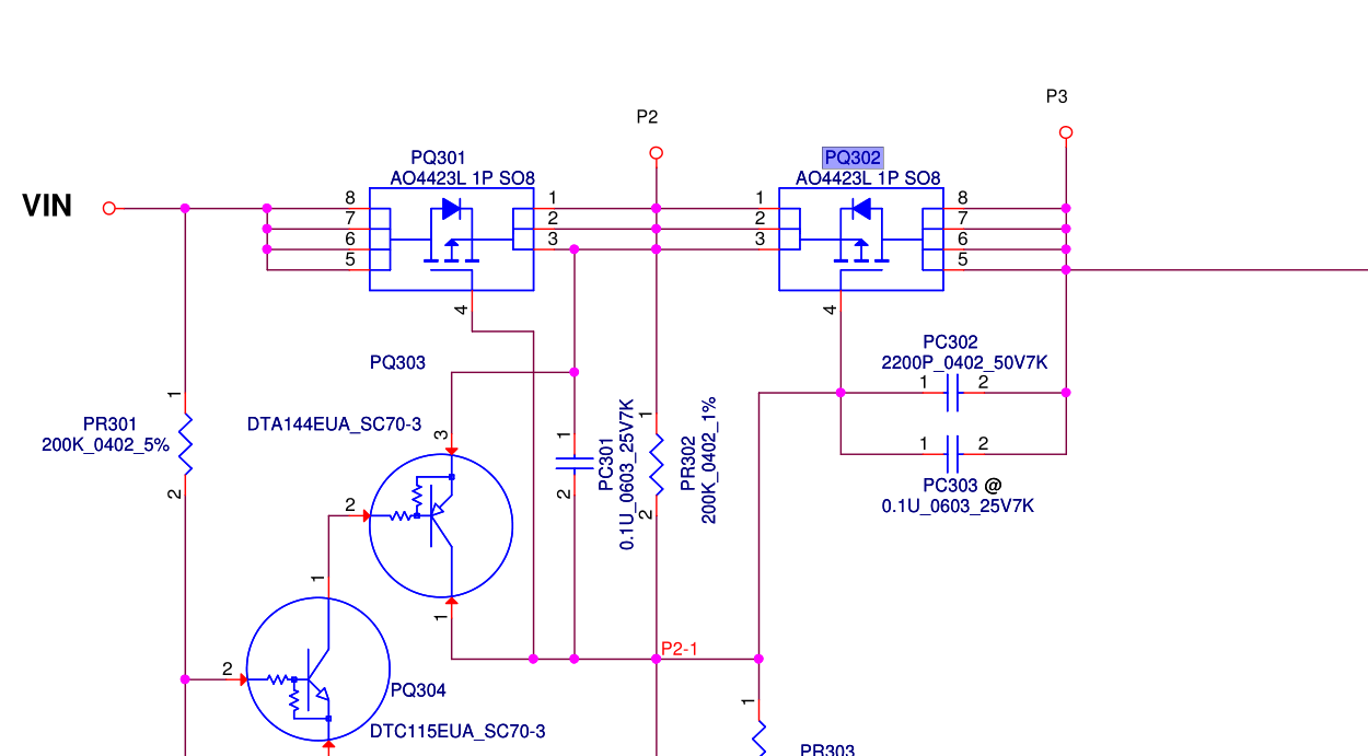

    I'm a begginer still at repairing motherboards in laptops, but I'm willing to learn.
    Its the second time I got a laptop that doesnt draw any power. For this laptop Lenovo Y510p VIQY1 NM-A032: No visual damage, no liquid damage, just doesnt turn on. No shorts on all chokes. Voltage is coming in 20V, then after second power IC after VIN (PQ302) it goes down, to 8V. I have schematics, boardview, multimeter, own regulated power supply, soldering iron and hot air station, and some free time.
    Quick question nr. 1: does the B+ Voltage rail, should have any voltage without the battery? Its the same rail for battery charging?
  • mon2
    • Dec 2019
    • 14664
    Re: B+ Voltage rail; Lenovo Y510p VIQY1 NM-A032
    Remove all power.
    Meter in resistance mode (lowest scale).
    Check the resistance of the mosfet pins to check for possible damage:
    source (1-2-3) & drain (5-6-7-8)
    source (1-2-3) & gate (4)
    gate(4) & drain (5-6-7-8)
    Post each reading, in order for PQ301 and then PQ302.
    Then, check the resistance to ground of pins 5-6-7-8 (drain) of PQ302.
    That is, red meter lead to either 5-6-7-8 pins; black meter to ground.
    What is the resistance to ground of the P3 rail ?
      Measurements: pins on the left red probe, pins on right black probe:
      PQ 301:
      source (1-2-3) & drain (5-6-7-8): 0,48MOhms
      source (1-2-3) & gate (4): 125kOhms
      gate(4) & drain (5-6-7-8): 0,7MOhms
      PQ 302:
      source (1-2-3) & drain (5-6-7-8): 12kOhms
      gate(4) & drain (5-6-7-8): 0,5MOhms and rising to 0,9MOhms
      Ive tested PQ301 and PQ302 resistance to ground earlier, and some readings were strange. This are the readings:
      PQ301:
      Pins: 1-3: 60kOhms and rising, 96 and slowly rising; 2nd measure: 0,5MOhms
      4: 0,6MOhms 2nd measure: 118kOhms
      5-8: 135 kOhms
      Maybe im switching gates measuring so fast (no voltage is connected to the motherboard)
      PQ302:
      Pins: 1-3: 0,4MOhms
      4: 0,6MOhms
      5-8: 5kOhms rising to 10kOhms; 2nd measure 0,5MOhms falling to 0,4MOhms; this time I was measuring only 1 pin (pin 8), and 2 different measurements were showing up.
      To answer your last question resistance P3 to ground is 5-10kohms or 0,4MOhms
            PQ302 has too low of a resistance and should be replaced.
            These mosfets are not expensive so recommend to also replace PQ301.
            What are the markings on each part ?
            Is it AO4423L ?
            There are many valid replacements for this mosfet.
            https://www.aliexpress.com/premium/A...psort=1&page=1
            If you wish to source from a local supplier, post back to see if we can find a drop in replacement from TI or similar.

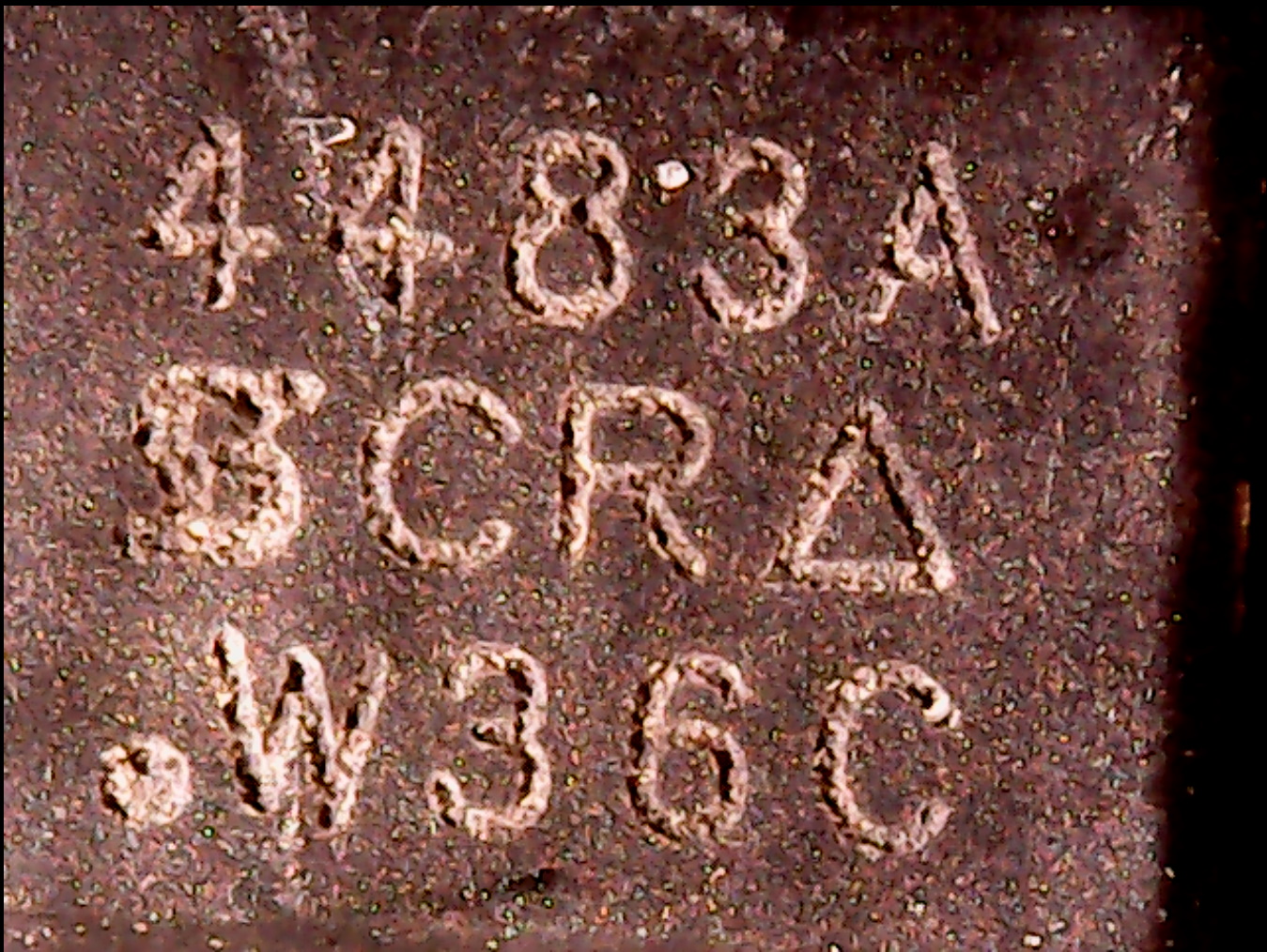

              Well it turns out that the PQ301 is 4423, AO company, but the PQ302 is 4483A with a B logo, or is it crossed S? And a triangle at the right - screenshot in the attachement.
              Strange, why would they use different mosfets than on the schematic?
              Should i replace both of them for the same mosfet model? 4423 is best for this application?
              I've found TC4423AVOA MICROCHIP TECHNOLOGY, at my local supplier, but its a little bit more expensive, than other mosfets that I've already ordered, and after reading datasheet for it, I think its a dual mosfet (DRMOS?).
              Couldn't find anything 8pin 30V 17A or higher... Maybe I'm searching this the wrong way. If I could ask you, for finding me a replacement for this IC, I would be grateful:-) my local supplier has this website, with all the ICs: www.tme.eu
              I could also desolder them and check the resistance to ground, if You think it would help. Also I've noticed that Resistor PR301 is lower than it should be (when measured on board it has around 138kOhms measuring on both sides, not to ground). When applying 20V, after PR301 there is 6,8V. I doubt that 6V is used on a motherboard:-)
                The picture is si4483a mosfet.
                  Hi.
                  1) The Microchip part is not the same as the mosfets showing in the schematic so ignore that option.
                  2) The schematic shows AO4423L for both PQ301 & PQ302 so suggest this as one option - use the same for both landing pads.
                  3) Other valid options are to replace with a part such as the following:
                  < the following looks to be a better part than the original >
                  https://www.mouser.ca/ProductDetail/...ySH5KPIg%3D%3D
                  p/n SI4459BDY-T1-GE3
                  P-Channel 30 V (D-S) MOSFET
                  Supports upto 27A

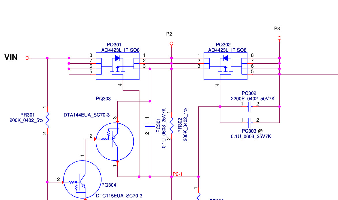

                            Yes, B+ should be ~VIN from external DC adapter, when the adapter is used. This is the priority. External adapter is selected even if the battery is attached.
                            BATT+ is a lower voltage than VIN and is used to charge the battery but the BATT+ voltage is defined by switching ON/OFF the mosfets @ PQ311 & PQ312.
                            The battery mosfet @ PQ310 will be open when the VIN from the external DC adapter is not present (ACDET signal is used to detect if the adapter is present). In this case, the BATT+ voltage will be used to power the B+ rail.
                            For these tests, remove the battery if it is attached.
                            Then take voltage measurements of the mosfet pins @ PQ301 & PQ302.
                            Also measure the voltages (carefully so no pins are shorted with the meter) of PU301.
                            Post your readings.
                                See a few faults starting with:
                                3 CMPOUT: 0V
                                4 CMPIN: 0,185V
                                Can you confirm these readings again ? Both should be the same reading or very very close to each other. Use the lowest scale on DC volts scale for your meter.

                                          Both N-Channel Mosfets: nothing odd
                                          P-Channel MOSFET number 1:
                                          source - drain : 117 kOhm
                                          source - gate: 96 Ohm
                                          gate - drain: 117 kOhm
                                          P-Channel MOSFET...
