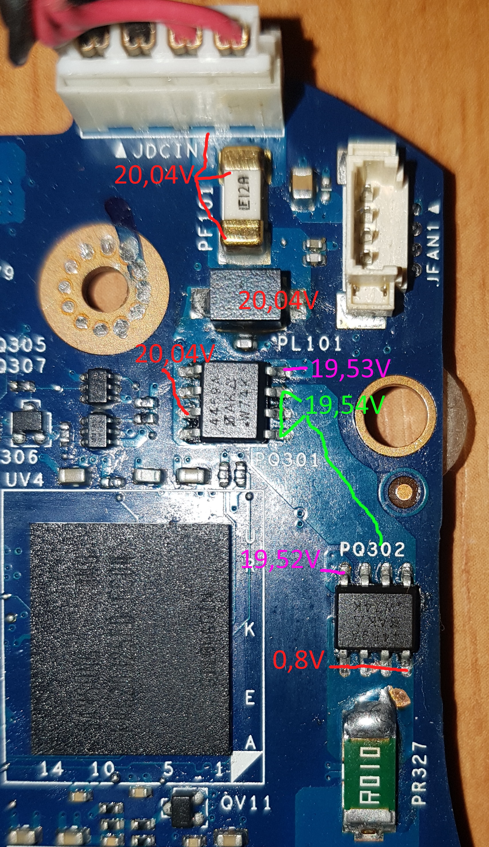

      Re: B+ Voltage rail; Lenovo Y510p VIQY1 NM-A032
      Both gates PQ301 and PQ302 are 19,5V.
      PQ301 input: 20V, output 19,5V;
      PQ302: input: 19,5V, output 0,8V.

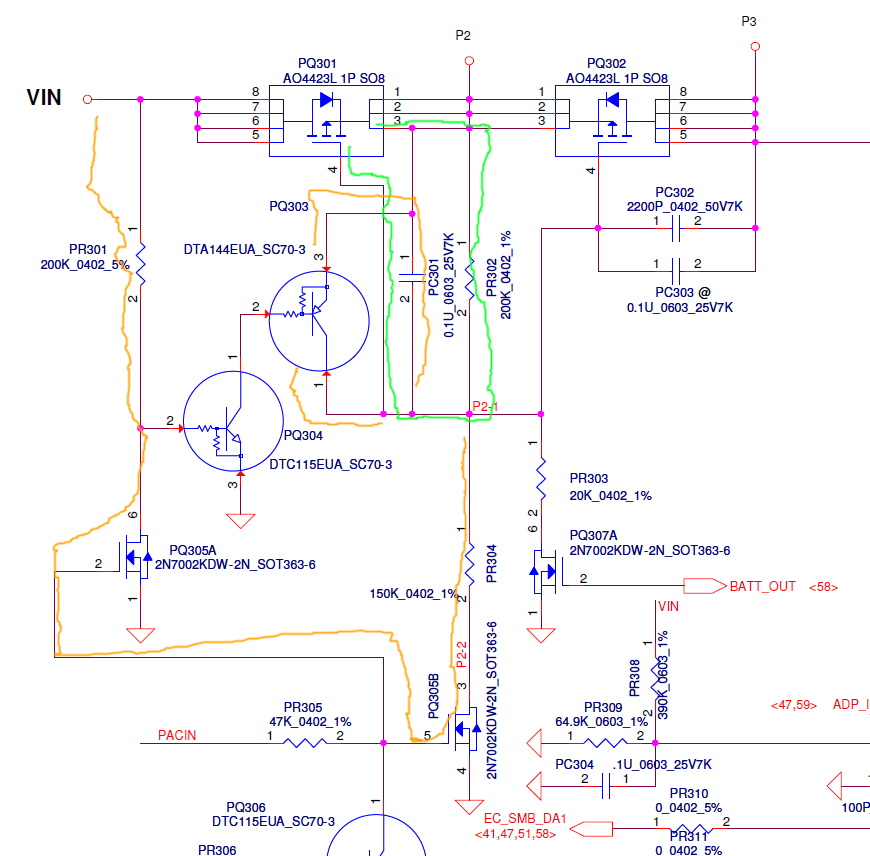

          Both PQ301 & PQ302 are P-channel mosfets.
          With P-channel mosfets, the GATE must be lower than the voltage being passed between source & drain. If you are measuring 19v @ the gate pin # 4, then the mosfet should be OFF.
          PQ302 appears to be OFF and this is expected.
          PQ301 appears to be full ON - incorrect for P-channel.
          Confirm the voltages on PQ301 again - source; drain; gate.
          Was this part replaced and soldered on in the same orientation ?
          It appears to be leaking if source & drain are at the same voltage yet GATE = 19v.
          Check with removing all power. Wait a minute to allow for discharge of the caps.
          Meter in resistance mode - check the resistance across the pins like before:
          source (1-2-3) & drain (5-6-7-8)
          source (1-2-3) & gate (4)
          gate (4) & drain (5-6-7-8)
          Post the readings.
            Picture with voltage measurements in attachment.
            The second schematic screenshot shows the gate for PQ301. If I have 19,5V on gate there, then something attached to it should give 19,5V right? Either Green line, Yellow line, or from the mosfet itself (which shoudln't happen given the resistances from before right?)
            • mon2
              • Dec 2019
              • 14664
              No. This is a P-channel mosfet so the gate has to be sufficiently negative or lower than the voltage INPUT to enable the mosfet.
              You have ~20 V as input and ~19v5 as the output with the gate @ 19v5 which is not low enough on the gate pin to turn on this mosfet.
              Do you have another P-channel mosfet you can use to replace PQ301 ?

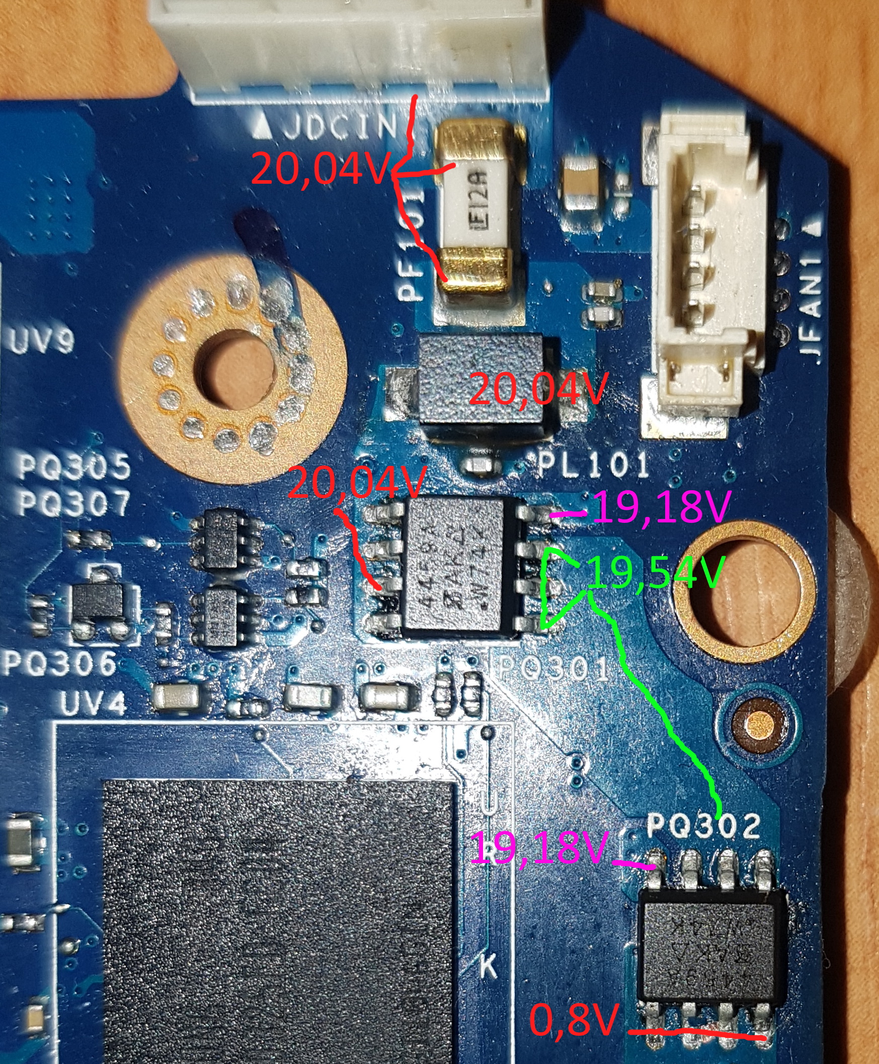

                        • ITworkshop
                          • Feb 2022
                          • 32
                          • Poland
                          #32
                          After desoldering PQ303 and PQ304, small difference in voltage at the gates - 19,18V not 19,5V - screenshot in attachment.
                          So do You think the culprit could be the PU301?

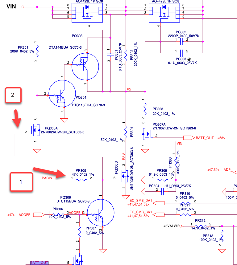

                          • mon2
                            • Dec 2019
                            • 14664
                            #33
                            Post the measurements for points # 1 & # 2 of the attached.
                            • ITworkshop
                              • Feb 2022
                              • 32
                              • Poland
                              #34
                              1: PQ305 pin 2 and 5 (the same): 0V; resistance to ground 10,9 kOhms
                              2: PR305 2nd leg: 0V; resistance to ground 57,3 kOhms
