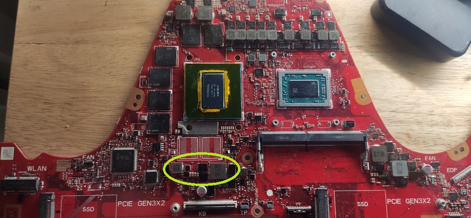

    Hello! No schematics available online for this one sadly.
    Laptop not turning on, no charging light
    I don't understand why my 19v wont show on the output of the first mosfet.
    Should I jump wire only the first mosfet or you guys have any suggestions?
    Any help is appreciated!

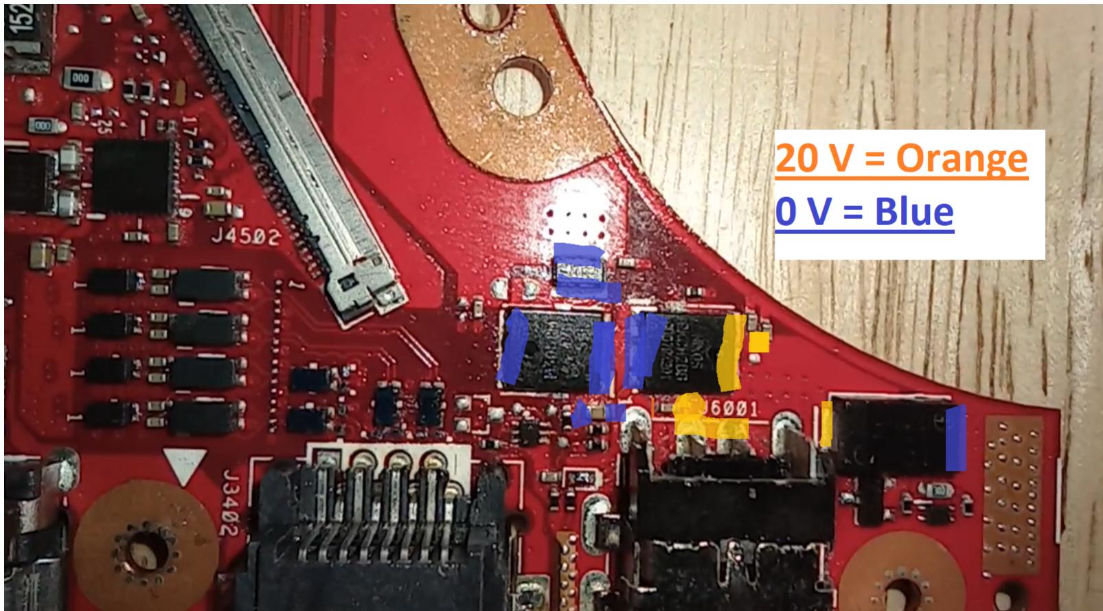

      Laptop has been dead for a year, decided to try to fix cause why not.
      Original charger is being used.
      1st mosfet is PKCH2BB, 2nd is M3058M
      Charger IC is bq24780s (Is this right?)
      Voltage in the picture are the only ones that have values.
      How can I possibly find the mosfet for the charging IC?
      I also attached a picture of the front of the board maybe its here? the charging IC is literally at the back slightly below of the these mosfets.
      If you need anything more measured just let me know

              These are the resistance values measured
              1st mosfet =
              Source: 51.9 kΩ
              Gate: 7.5 MΩ
              Drain: 52 kΩ
              2nd mosfet =
              Source: 51.9 kΩ
              Gate: 7.4 MΩ
              Drain: 0.001 Ω
              Measured 0.001 Ω after the resistor with blue mark.
              Both mosfet Source are connected, and all the components that are connected to the First mosfet drain has all the same resistance.
              also diode mode on the drain side of second mosfet reads 0.00v.
              any thoughts?

                  as you can see you have a short on main power rail, short to gnd. Thats why your mosfet is not opening...to prevent damage to motherboard.
                  The problem is that main power rail is a huge rail...powering everything on the motherboad so it is very difficult to find where is the short.
                  On gaming laptops it is usually the power mosfets on gpu or cpu line...but it could be a capacitor also.
                  Double check the resistence in milohms on main power rail? is it exactly 0,001 ohm?
                  also, make a visual inspection on the whole motherboard to see anything burned maybe or cracked.

                      My bad its actually 0,1 Ω. I can't see any obvious discoloration from passive components to ICs. Tested some sus caps but they are not shorted at all.

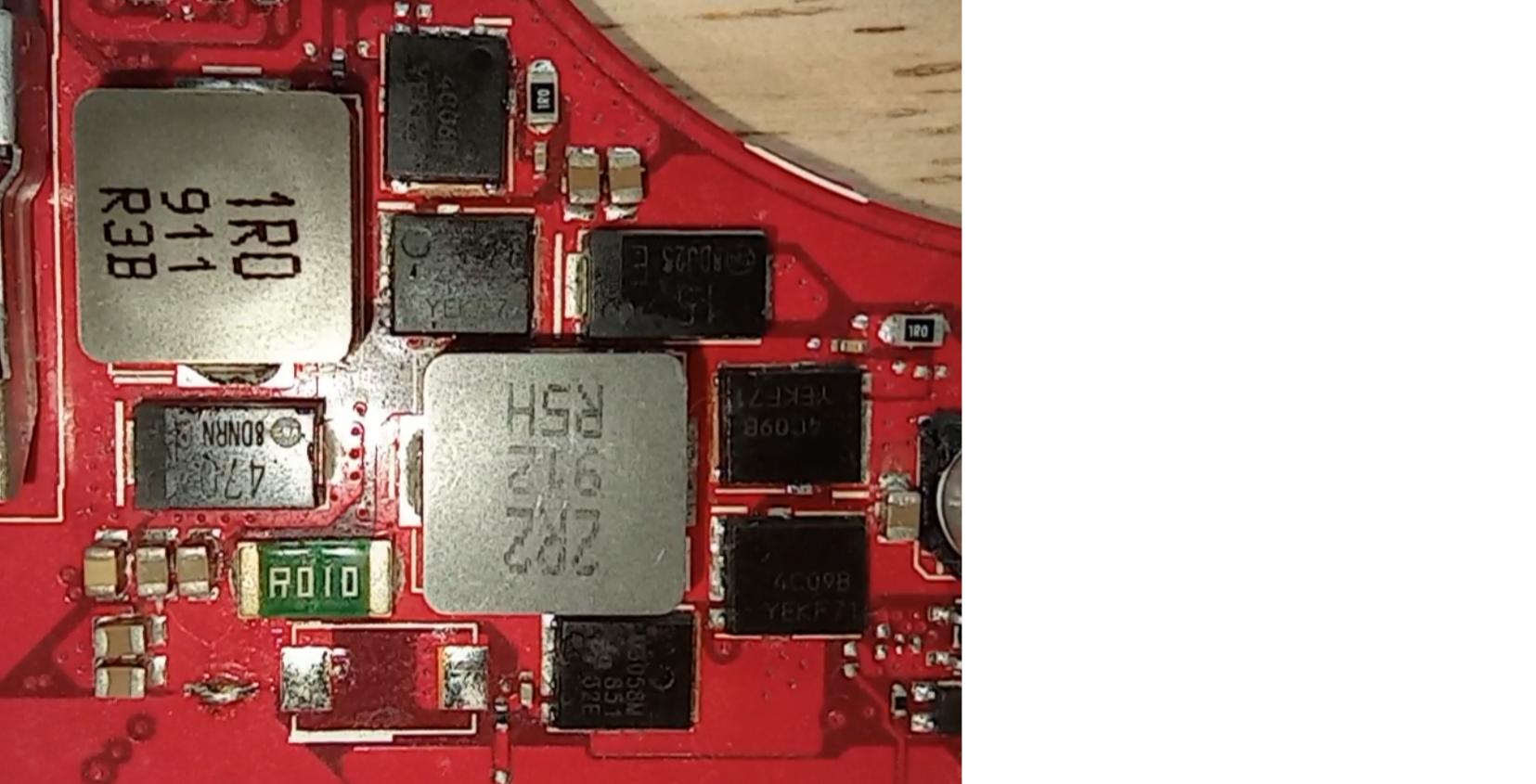

                        I have also tested resistance to ground on some coils and found out that these two coils are both under 1Ω.. Can I narrow down that the short is somewhere here or near?

                                  Yo guys, am back so firstly I replaced a shorted mosfet and my CLR on the main power rail after the second mosfet is only reading 4.2v
                                  Any thoughts on my next step after?
