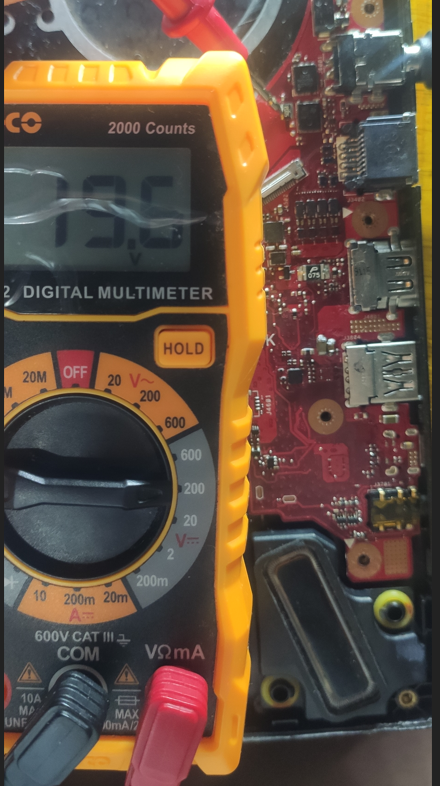

    First Input mosfet:
    Drain: 20v
    Source: 0v
    Gate: 0v
    Second Input mosfet:
    Source: 0v
    Gate: 0v
    Drain: 4.3v

                    #29
                    Re: ASUS ROG GA502D missing 19v
                    So after replacing the IC again. I now have 20v on my power rail
                    But still laptop won't turn on with or without the battery connected.
                    What are the next steps after this then? is this a bad fault?

                            #33
                            Here its
                            1st mosfet =
                            Drain: 20.2 V
                            Source: 20.1 V
                            Gate: 26 V
                            2nd mosfet =
                            Source: 20.1 V
                            Gate: 26 V
                            Drain: 20.1 V

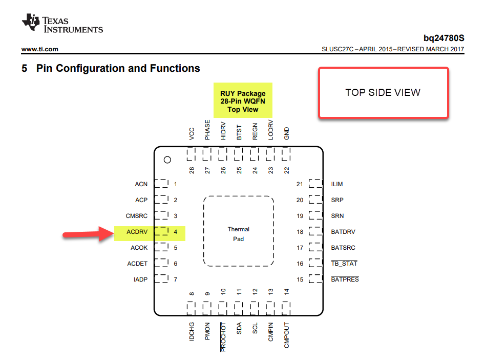

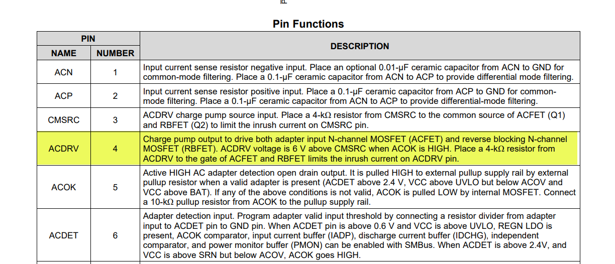

                                  The new list still does not show the proper voltage for ACDRV. However, the gate voltage is correct so the charger IC is spitting out the proper boosted voltage to turn on the mosfet.
                                  Carefully check again as the list is important for a proper review.
                                  Specifically, you must have ACDRV pin # 4 @ 26v since this is reaching the gates of the mosfet. It is the charger IC that will take in the DCIN voltage and the boost it up to the required ~26v to turn on the N-channel mosfets.

                                    The track of pin#4 goes immediately inside the board
                                    • mon2
                                      • Dec 2019
                                      • 13995
                                      #38
                                      That is fine but when using your meter, red lead on pin # 4 of the charger IC and black lead to ground - are you able to read the same voltage as on the GATE of the mosfet ?
                                      Just trying to establish that you are properly measuring the voltages on the charger IC.
                                      There are many 0v readings on the charger IC and do not believe the readings are accurate.
                                      Use the red meter directly on the pin of the charger IC - I think you should be able to find a close solder / shiny PCB pad to take these measurements.
