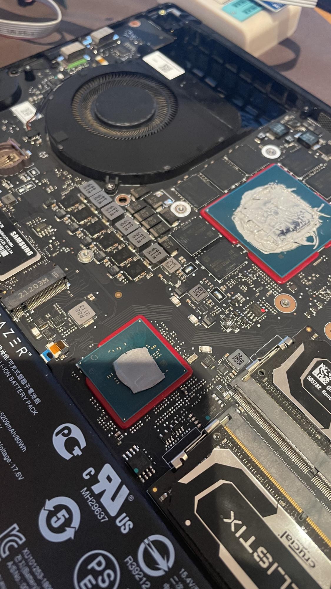

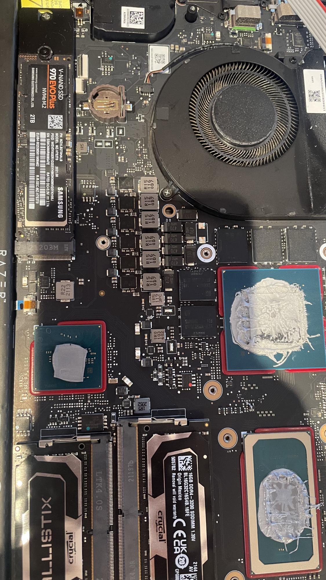

    Hi guys, i just got a brand new razer blade 15 rz09-0409cec3 that turns on keyboard light, fans but no display at all. I managed to get bios bin file from razer but im not sure if this chip is THE bios chip. It is a Gigadevice 25q64cig (Uee704 Aj2103) or something like that. I believe that is the bios chip, I uploaded photos from all of them in case i am wrong. https://drive.google.com/drive/folde...9M?usp=sharing If its ok i will remove it, read it with ch341A , backup and share bios file here so you can check what is wrong. I will try to flahs bios bin file from razer too. Will upload all together once im sure its the correct one. Wich program do you recommend to read it ?
    Thank u a lot!

    i have this laptop on my bench few weeks ago. bad bios update. after flash dump from vendor. all ok

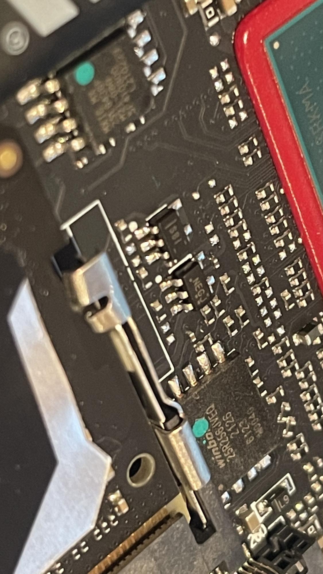

          Hey - I’m trying to figure out the same thing. Which chip is it for the 16mb bios file?
          • eeenojhshe
            • Oct 2022
            • 5
            Re: RAZER BLADE advanced 2022 rtx 3080 no post/display rz09-0409cec3
            The only ic I haven't been able to dump is the Winbond W25R256JVEQ so I guess that must be it? It's almost flush with the motherboard though and is impossible to get clips on.
            If that is the bios chip - any tips on how to read/ write without desoldering?
            • Sephir0th
              • Oct 2020
              • 1282
              Dunno what's the question here. The datasheet of the Chips will give the answers. Top marking of the flash in question is W25R256JVEQ, so 256 / 8 = 32MB. It is WSON package so you have to put wires, or even better, to solder it on a suitable programming board.

                  The best solution is to carefully remove the flash chip, solder it onto a small smd to dip bridge board. Then perform your reflashing.
                  Do you have a flash programmer? Which one?
                  Be careful to confirm the peak VCC pin voltage of your tool and the target flash device before proceeding. Else you can kill the flash memory device.
