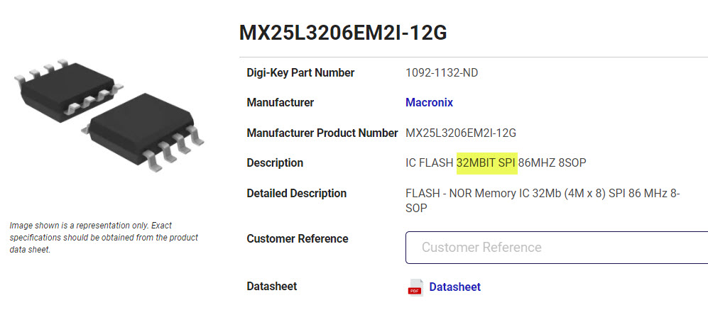

      Re: Dead acer 7750g
      This is a SPI flash device.
      So start with the vendor = 'MACRONIX' in the programmer s/w.
      Then look for SPI style -> then the part number showing on the digikey webpage.

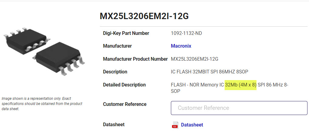

                    Use this file to reflash your memory device:
                    P5WE0121.bin 4096KB
                    See attached.
                    The density of the flash IC = 4M x 8 = 4096KB (kilobytes) which matches the above .bin file in size.
