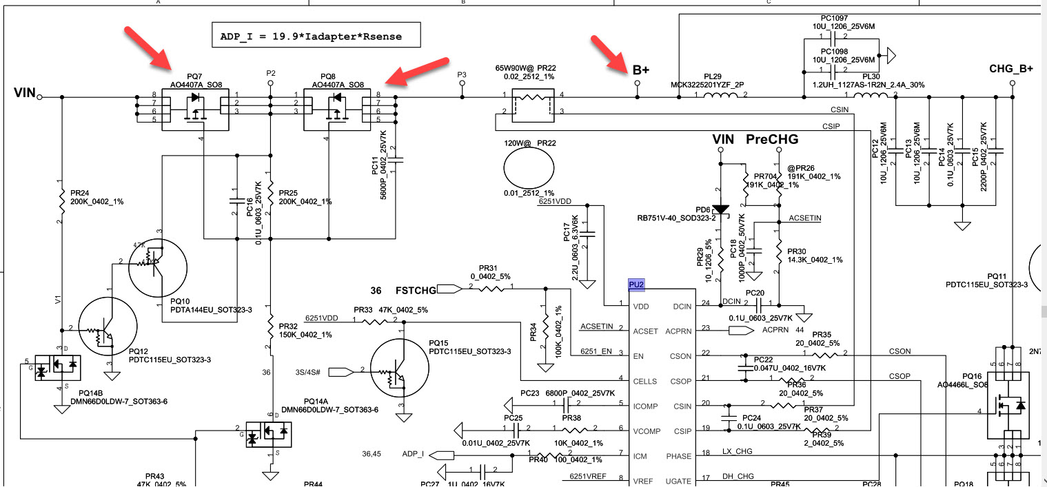

    Start with the schematic -> search for 'charger' = PU2.
    Then review the first 2 mosfets, starting with the one that mates with the external DC adapter.
    Remove all power & no battery.
    Meter in resistance mode (2k scale).
    Check if either of the first 2 mosfets is damaged by checking the resistance of:
    source & drain
    source & gate
    gate & drain
    looking for a low resistance which often means the mosfet is defective and must be replaced. If the resistance is OK then using ONLY the adapter, check how far the Vin travels onto the logic board.
    Voltage @ B+ junction ?
    Carefully measure the voltages on PU2. Post your readings.
    NB: More in depth details on this process are posted up above by @Piernov:
    https://www.badcaps.net/forum/showthread.php?t=90356
    Definitely recommended reading.

      The resistances in th mosfets are around 2-300K or 0L. The 19,39V comes out the second mosfet through the sensor resistor and go on.

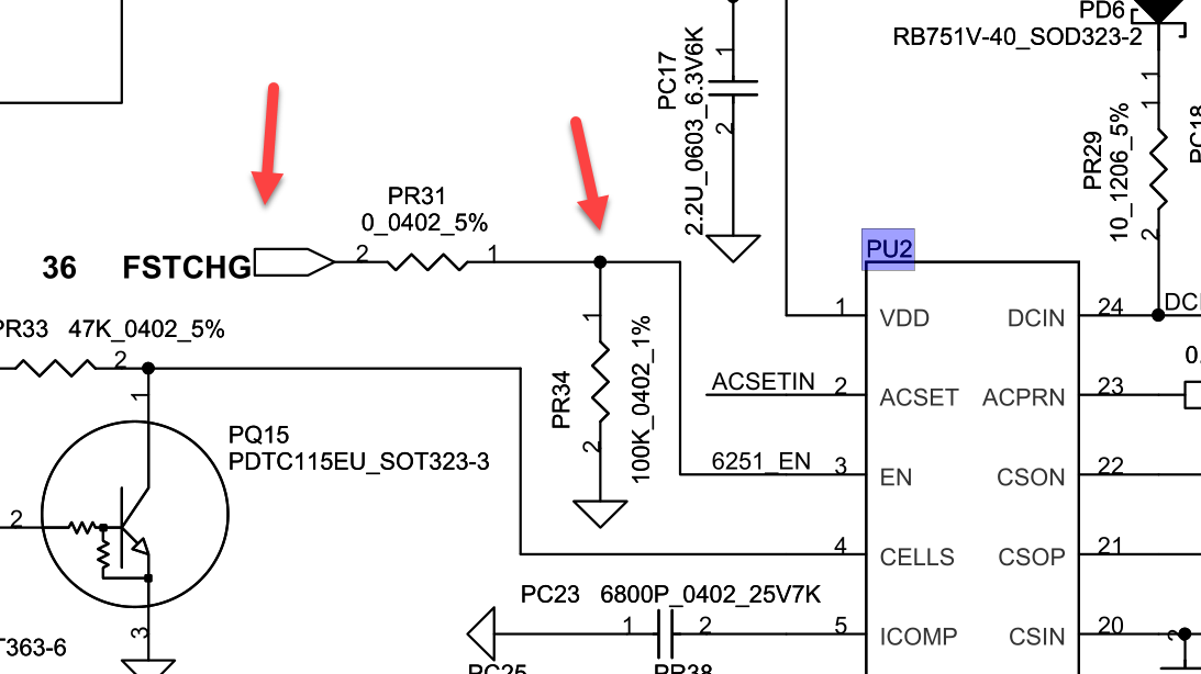

            Pin 3 reading is not correct. This is the EN (enable) pin for PU2.
            This signal is driven by KB930QF (U21) and then enters the 0 ohm resistor @ PR31.
            Confirm the voltage on pin # 2 of PR31 and then again on pin # 1 of PR31.
            Is it 0v on both legs of PR31 ?
            If yes, the KB930QF (U21) needs to be reviewed.

                Bot legs of PR31 is 0V. The U21 is the super io?

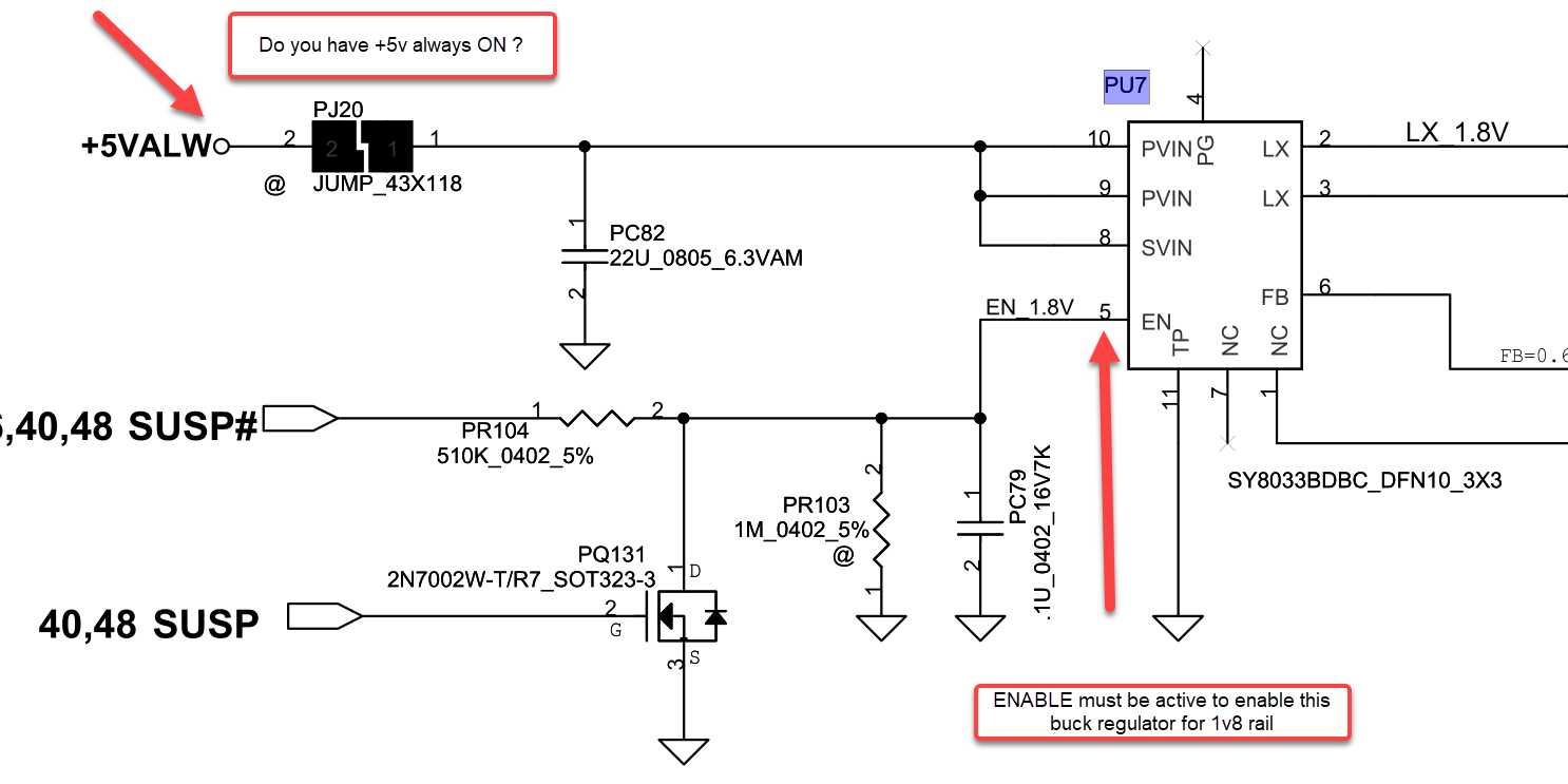

                  For PU7, see attached. It is a buck regulator that will accept a higher voltage and lower it to another required voltage. Often such regulators are based on a FB (feedback) pin which will use 2 resistors as a voltage divider to dial up the desired voltage for the output.
                  Review the ENable pin # 5 - what is the voltage reading there.
                  Expecting a logic high here to ENABLE this regulator.
                  If you see a logic high for the ENABLE and you also have a +5ALW rail present yet the regulator is not working, then review if the output rail is being shorted and causing an excessive current draw which will then cause this part to shut off, for safety.
                  For this review, remove all power, meter in resistance mode (2k scale) -> check the resistance to ground of the output coil. What is the resistance ?
                  If it is very low, then there may be a bad cap on this rail causing the excessive current draw. More after you post the readings.
                  Repeat for other rails that are not powering on.
                  If the ENABLE is NOT a logic high (~3v or higher), then the upstream circuit that operates the enable pin must be reviewed.
                  I measure the B+ at the source of the cpu mosfet and it's present but dont go through it and comes to the coil.
                  Which mosfet exactly ? Likely similar to the above - check if the enable pin is active or not. Also check the resistance to ground of the output coil (with NO power to the board).

                    The pin 5 of the pu7 is 0V so is not high i supposed. The mosfet i'm speaking about is the PQ109 and 113, and also here the gate is at 0. If I understand well this gate will be open just when i press the power button and not at power off pc ( itested in both configurations)

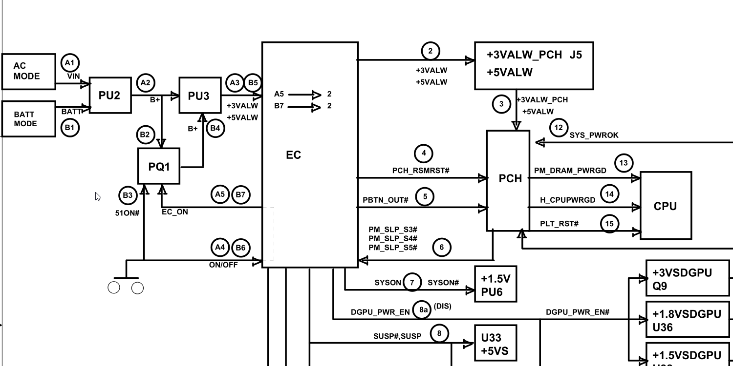

                          Do you have both rails working on PU3 ?
                          +3VALWP
                          +5VALWP
                          See attached and use it to review the order of events to power on.
                          So with ac adapter, follow the 'A' prefixed labels (A1 -> A2 -> A3, etc.).
                          We need to confirm that the voltages @ A3 are present so that the EC chip is being powered -> then will accept the ON/OFF function @ A4 step -> enable signal @ step A5 will follow.
                          Eventually the EC must spit out some logic levels. However, note that this is a common area of failures and is a programmable device (often based on an internal 8051 microcontroller). Apparently it blows its brains out once in a while and must be reflashed with the firmware. There are special programmer tools to perform this reflashing using a flat ribbon cable and the KBC (keyboard) connector. Believe it is either SPI or JTAG interface used here.
                          • giulio93

                            But at pu2 we have already problem no? the enable signal is missing. At this pu3, according to the board diagram there is not 5VALWP rail. the 3VALWP is present instead.
                            What EC stay for?

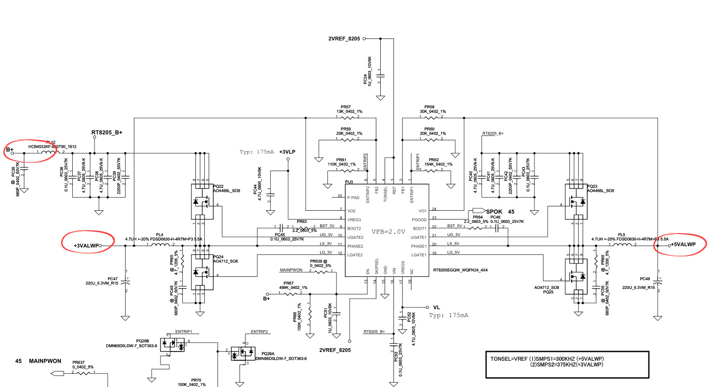

                              See attached. Perhaps I am referencing the wrong schematic from my database but PU3 = DUAL buck regulator.
                              This part will accept B+ from the adapter and create 2 of ALWAYS ON rails.
                              +3VALWP
                              +5VALWP
                              Measure the voltages on coil PL4 and also on PL5, post their values.
                              The +3VALWP must be working to power the EC controller chip @ U21.
                              Then U21 can output the enable signal of FSTCHG to enable PU2.

                                At pl4 and pl5 I have the 3.3V and the 5V. I had already checked the 3.3V on the U21 and it comes (so I supposed the super io is alimented).What should I check now?
