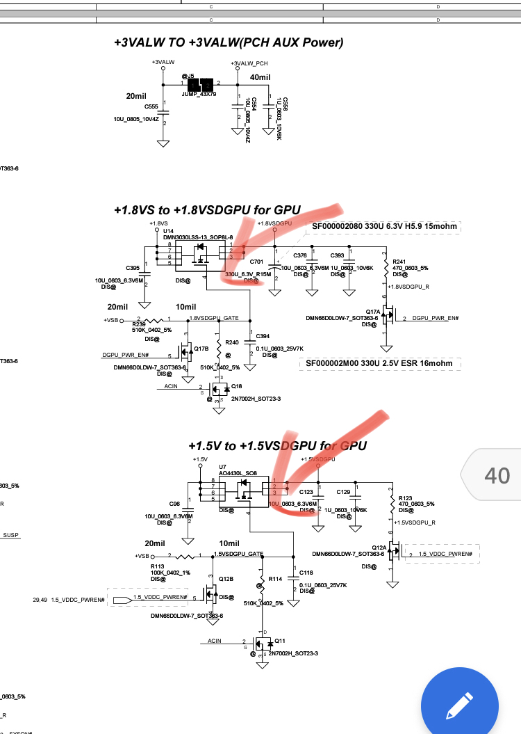

        Page 40 of Schematic you can find DC to DC & VS section 5 IC to test in put voltage and out put voltage note down
        Voltage on Q6 all pins & Ram slot pin 30 supply ? What are the missing voltage on the coils (PL) ?
        Bios that you flash is a working bin ?

            Q6
            pin power off power on
            1 0 1.52
            2 3.3 3.3
            3 0 0
            For pin30 of ram slot i mesure on the R63 and i get 1.52 when pc is power on and 0 when it's off.
            Which coils have I to check?

                Pin 1-2-3 of U7 and U14? For the bios chip do you know which ones it's the bios chip and what is the other?

                  If the question was about this the IC, In U14 I have 1.8V and on U7 I have 1.52V

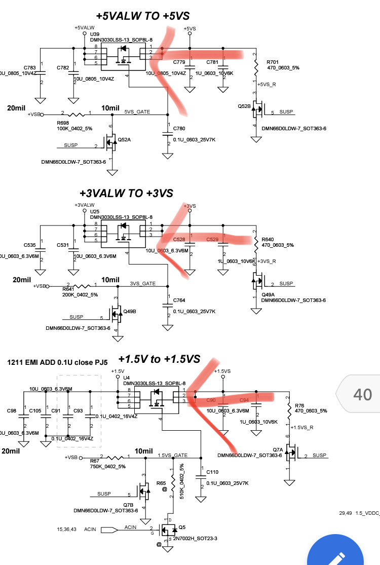

                    U39 U25 U4 U14 U7 pin 1 to 3 are connected so mesure the supply of any and note down for DC to DC & VS supply you have to mesure voltage when the MB is on , for Bios U35 BIOS IC is located near EC so that is your EC bios U40 near PCH that is your Main BIOS

                      Take a pic of the MB note down all the voltag's of the coils for example PL 23 PL19 PL 10 and upload

                          Sorry i am sure is my foult but I dont understand very well. Can you say exactly which measure I have to take? If you say me all the pins of all the components I will take all the masurments. For the bios chip i didnt programmer anything. I buy then already programme from the seller. Which bios chip manager the powering on? And what do the other one?
