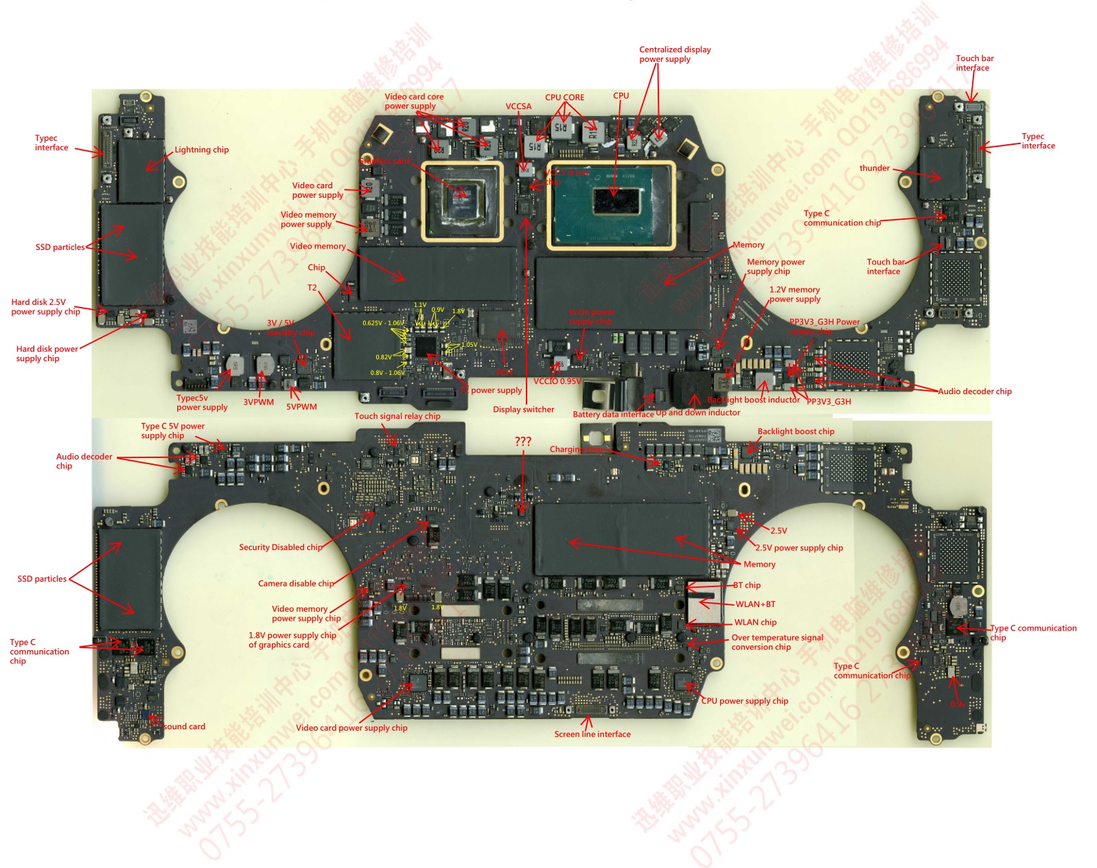

this MacBook came from another repair shop it was liquid damage not charging at all
after replacing charging ic and cleaning all water residue know it is charging and voltages for boot founded but it is not booting and storage ics is getting too hot
