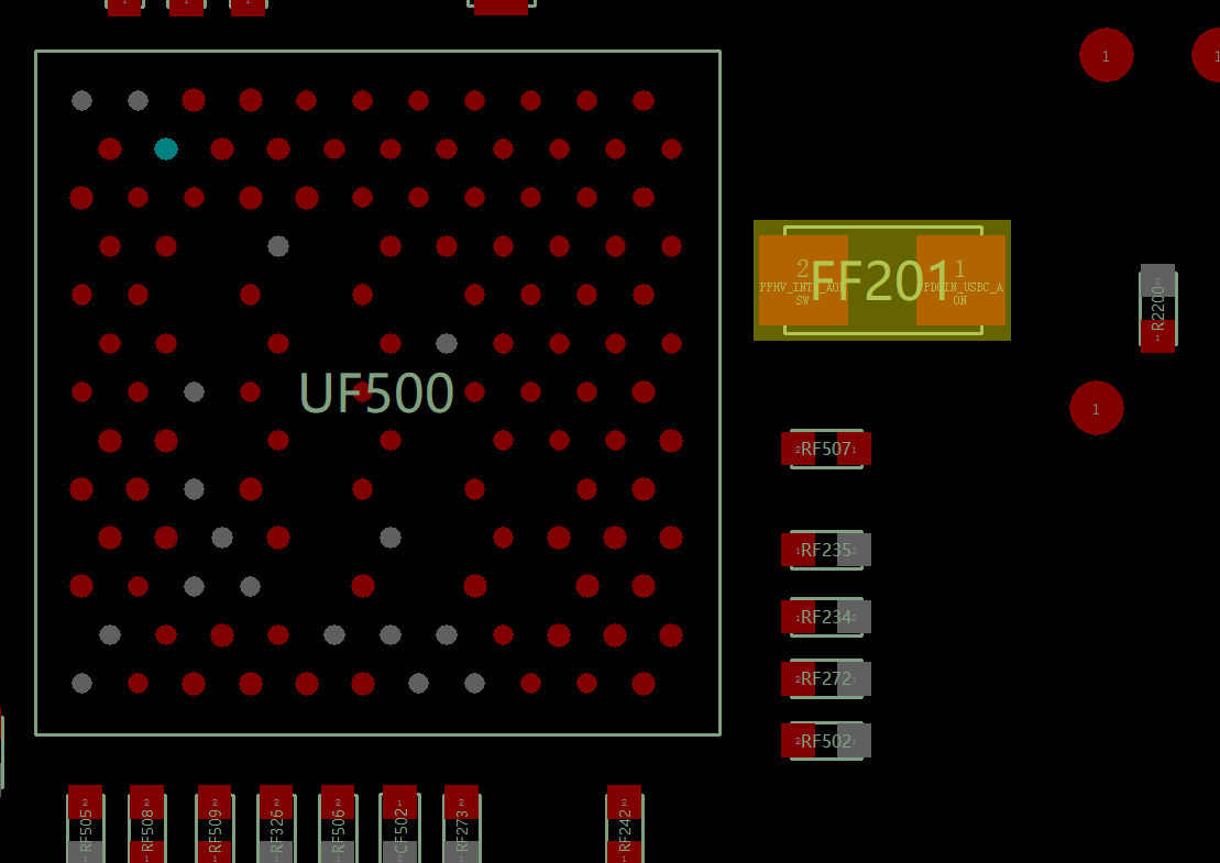

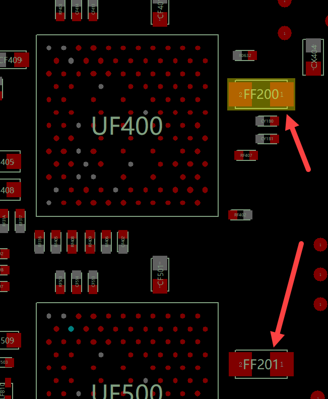

    Check and post the voltage on BOTH sides of the fuses:
    FF200
    FF201

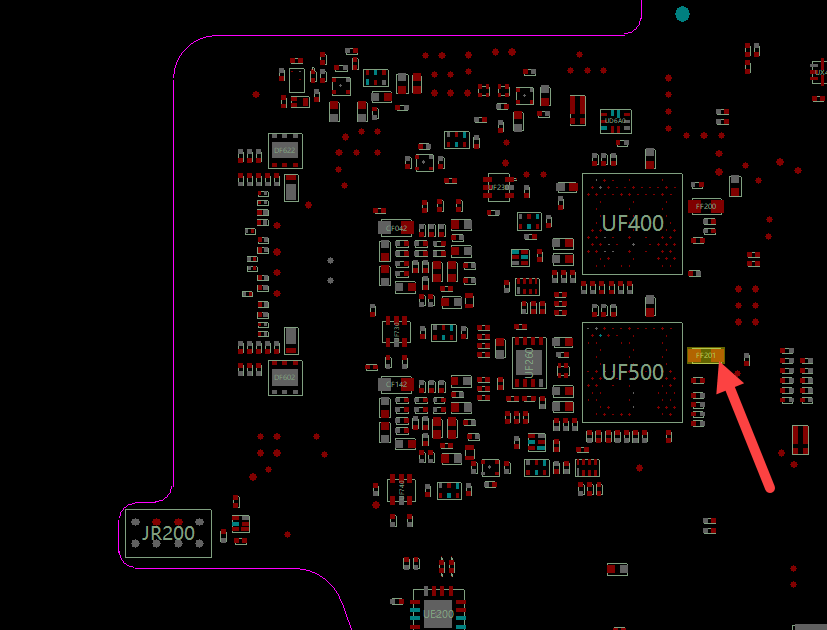

      Re: Macbook pro M1 A2338 820-02020 just 5Volts
      Ok, but I have no Boardview just BVR but can not open it. where are the Fuses? thx
      • mon2
        • Dec 2019
        • 14663
        Attached.
            all 4 points 5,176Volts

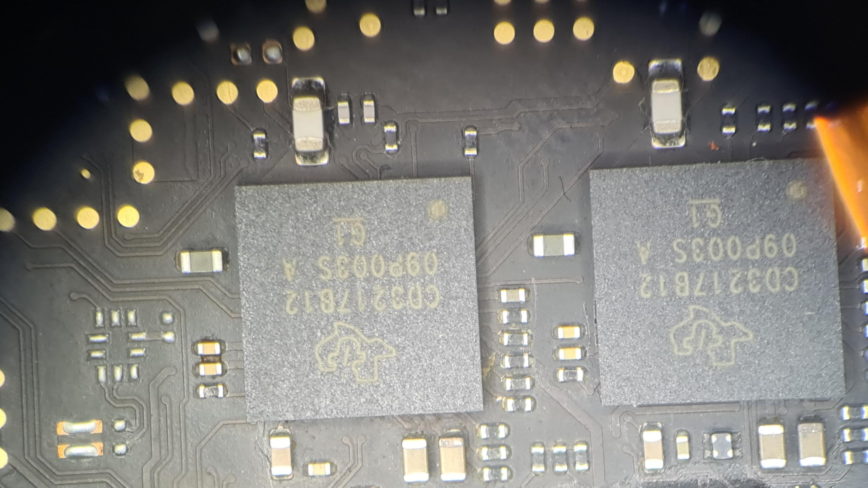

              Baby the CD32...
              • Strolch
                • Nov 2017
                • 245
                • Deutschland
                maybe

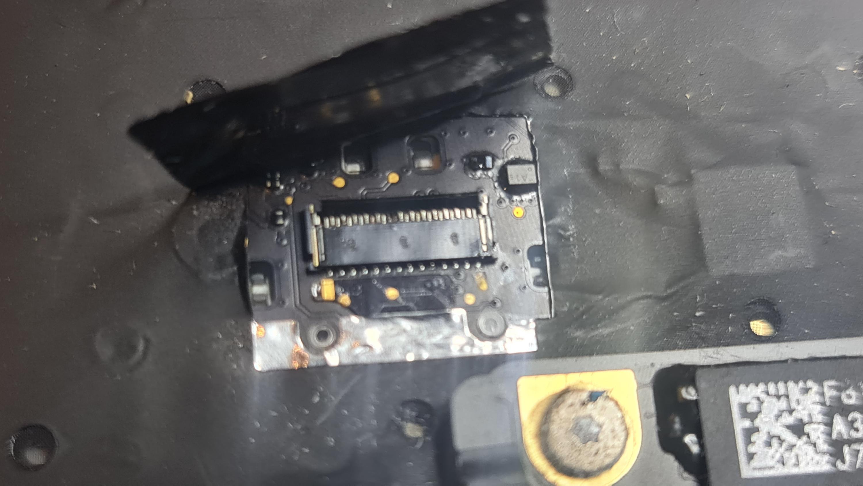

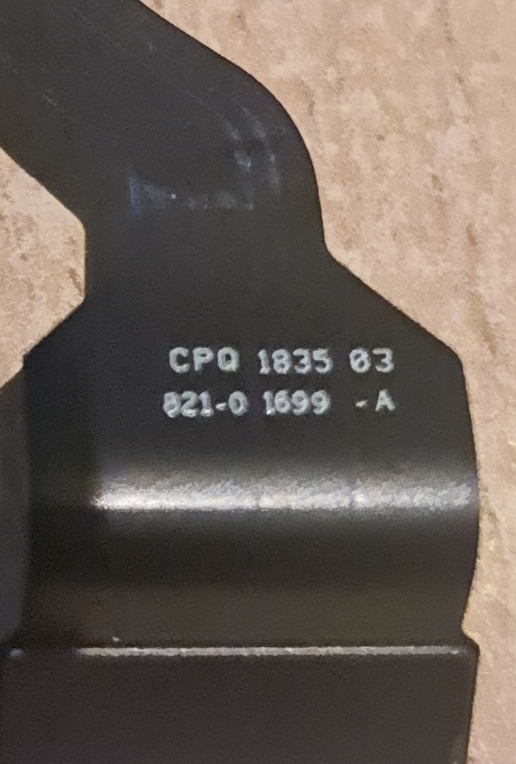

                  I need this connector
                  • mon2
                    • Dec 2019
                    • 14663
                    Hi. The connector looks good.
                    Can you review the cable that is being inserted inside this connector ?
                    Are the keyboard cable contacts the proper pitch ?
                    What is the logic board 820-xxxx # that has this connector ?

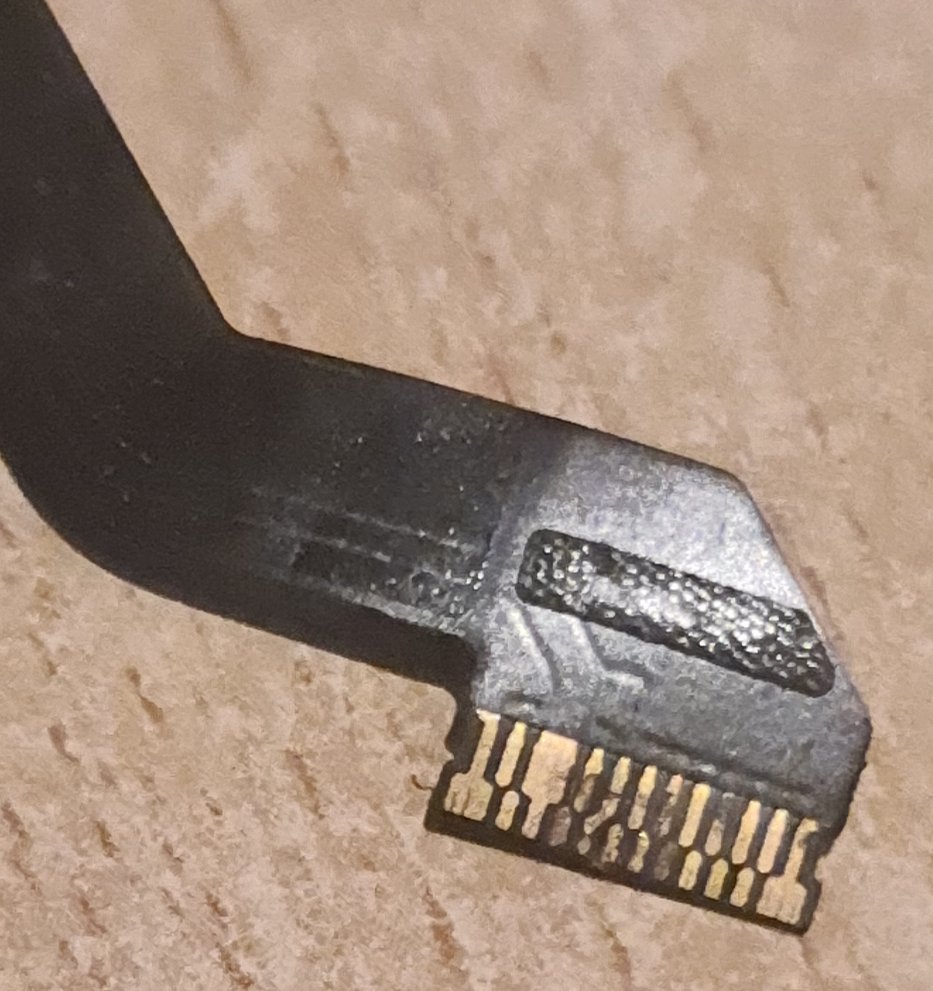

                      The cable and the connector are defective! I want to swap the connector on the keyboard but can't find it on the internet!
                      • mon2
                        • Dec 2019
                        • 14663
                        Both are available. Which logic board markings ?
                        Is it for the 820-02020 (A2338) or another ?
                          A1989 emc 3214
                            https://www.aliexpress.com/item/1005...rch-mainSearch
                            Yopolean (Dynamite?) is a good vendor. Have bought from them before a number of times. They have this cable.
                            Here are other shops:
                            https://www.aliexpress.com/wholesale...psort=1&page=1
                            For the connector that is defective - is that on the KEYBOARD or logic board ?
                            If on the keyboard, then the keyboard should be replaced.
                              on the Keyboard. Changing the keyboard isn't that great because of the rivets.
                              • mon2
                                • Dec 2019
                                • 14663
                                Yup, been there and done that. Alternative is to locate a defective keyboard or source a new one to lift off this connector. It will be a bit difficult since these style of connectors warp (melt) very easily.
                                I would suggest a blad soldering tip + lots of flux and gently lift one pad off at a time till the connector is lifted. Hot air will warp / melt and kill the connector.
