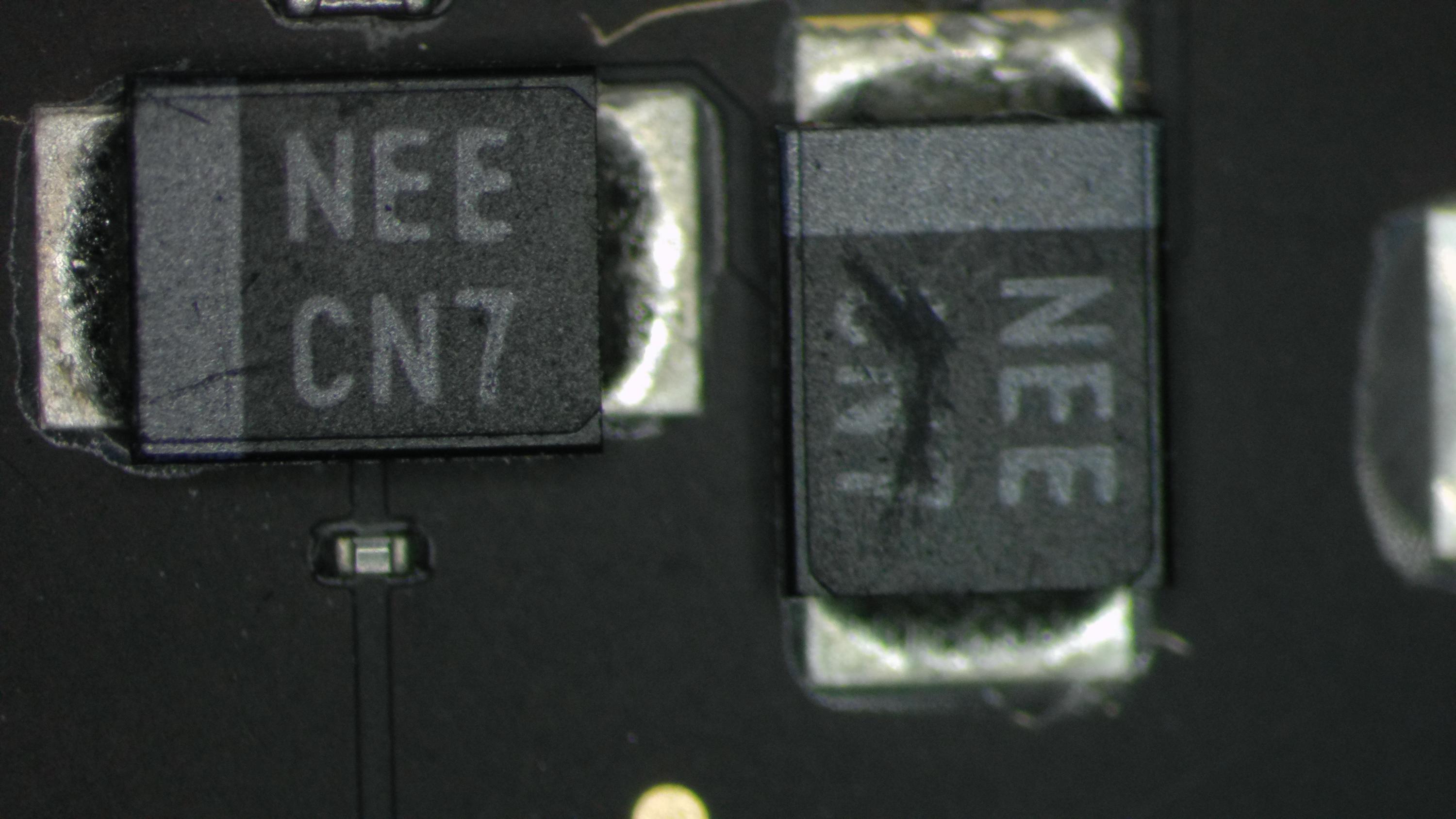

    Hi everyone!
    I have A1708 13'' Macbook Pro with 820-00840-01 board. When i connect the charger with the amp meter it goes to 20V 600-660mA and the down to 280mA and stays there. Chime sound stays repeating all the time. No backlight, yes trackpad clicking. I don´t have an usb-c usb pendrive or mouse to test cpu activity.
    PPBUS_G3H: 13.04V
    PPDCIN_G3H: 20,24V
    PP3V3_G3H: 3,14V
    Any suggestions?

        I found two capacitors with some cracks in PPBUS_G3H_CPU rail. In resistance mode it measure 5Kohm and rising. I attach a photo. Could it be related?

          Re: A1708 820-00840-01 Chime Loop
          The resistance are ok but crack is never good for anyone
          Remove the caps off the logic board and test again.
          PP3V3_G3H: 3,14V
          This rail looks to be low. Can you confirm it again ?
          Then remove all power -> meter in resistance mode -> check & post the resistance to ground for this rail.
            Sorry mon2, I made a mistake when i wrote it. PP3V3_G3H is 3,41V. Is 4,5KOhm to ground. I´m going to remove the caps now.
              I remove the caps and tried it again. It´s doing the same.
