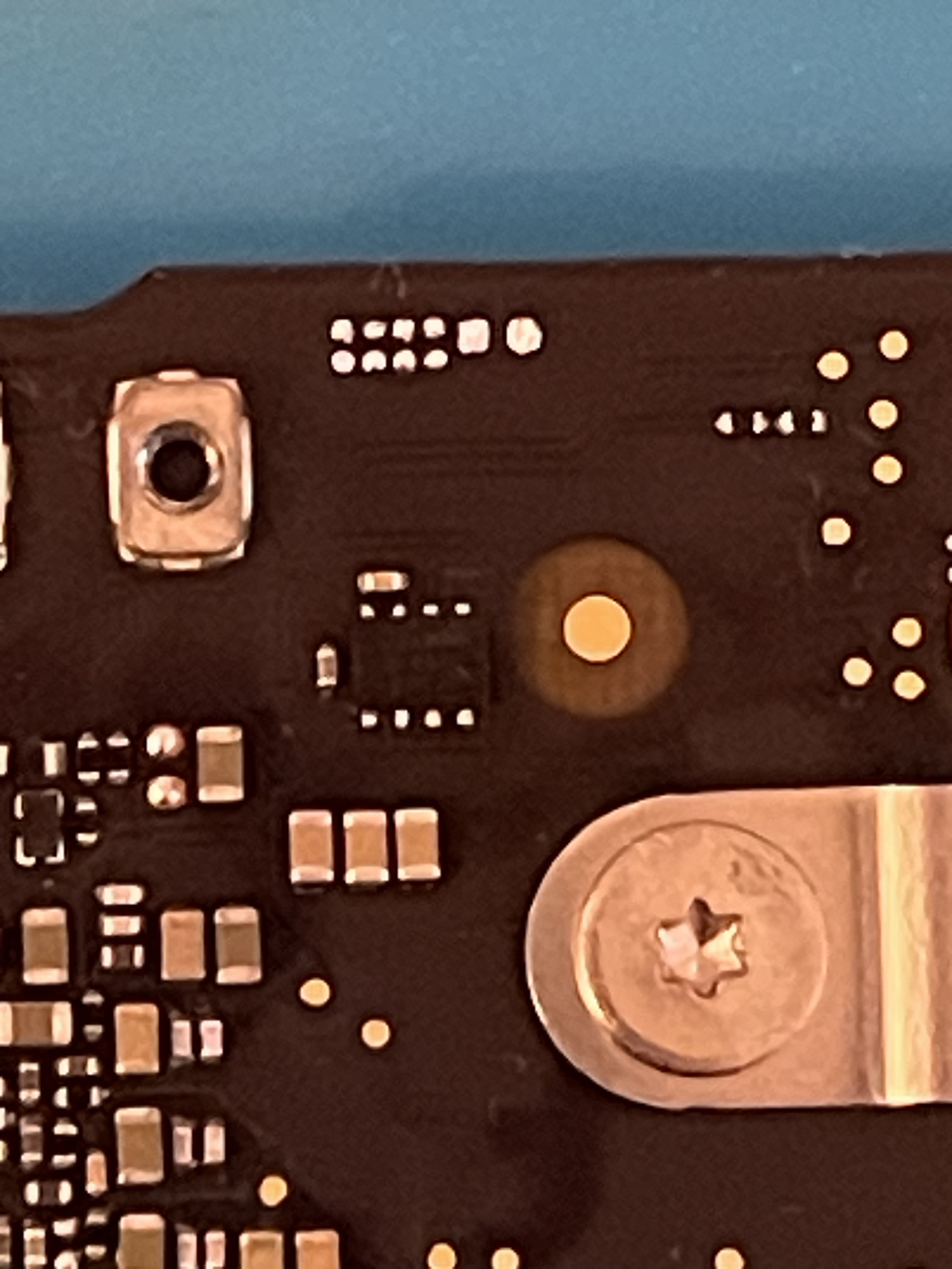

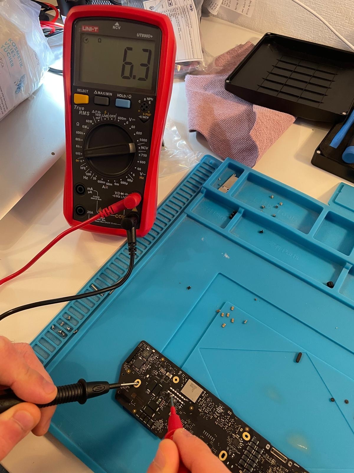

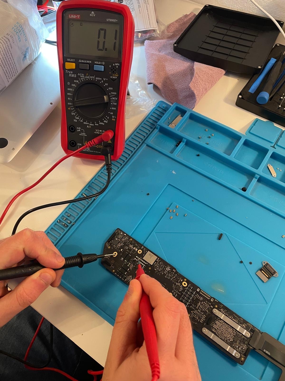

    Review the first pic in post #80 of this thread.
    Move the red meter probe to the other side of the caps. What is the resistance?
    • corintosh
      • Dec 2024
      • 29
      #102
      I hope the pictures show everything well enough. Flipping the side and measuring there gives the exact same values.

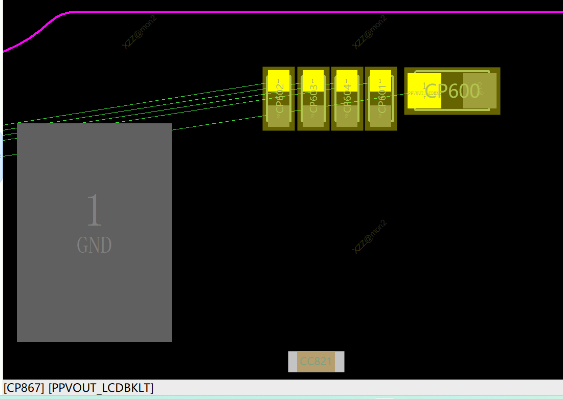

        Can you share the pic for the CP600 block of parts?
        • corintosh
          • Dec 2024
          • 29
          #104
          I should have included more info, it is already part of the ones I already uploaded. They are at the top.

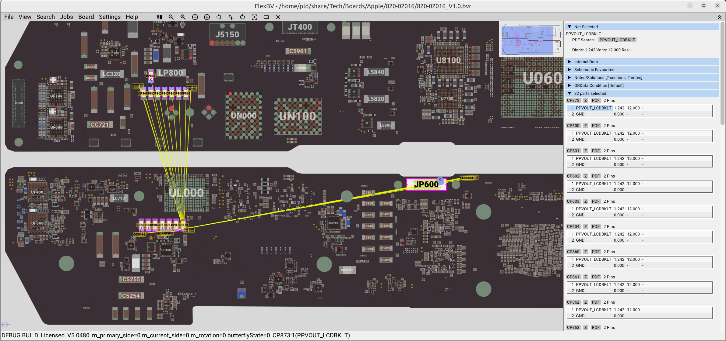

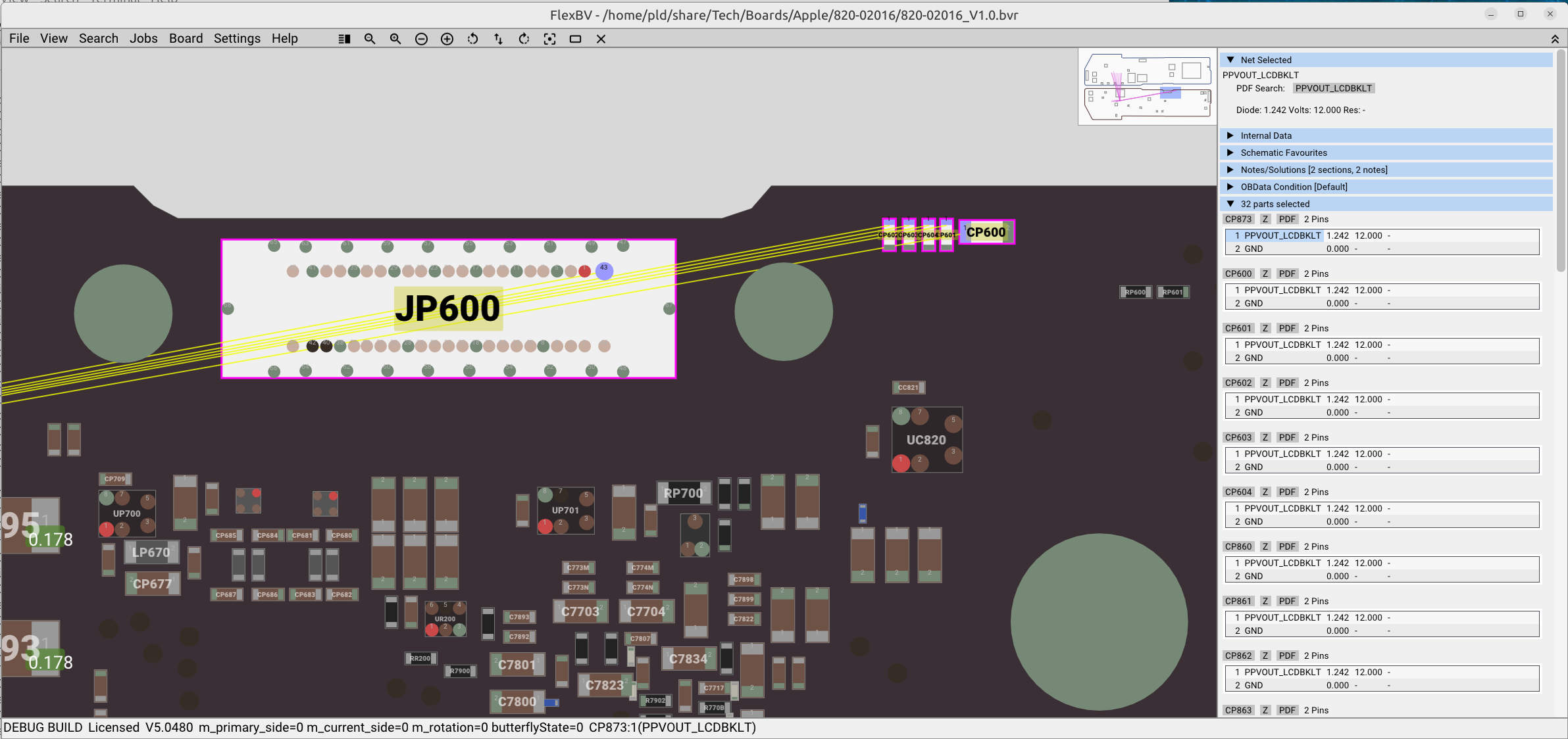

              There's more caps off to the side of the screen connector and near the main storage caps that you've already removed.
              Do you have the boardview & schematic and a boardviewing program? This is FlexBV5 ( https://pldaniels.com/flexbv5 ) which has a free edition which may help you out here.

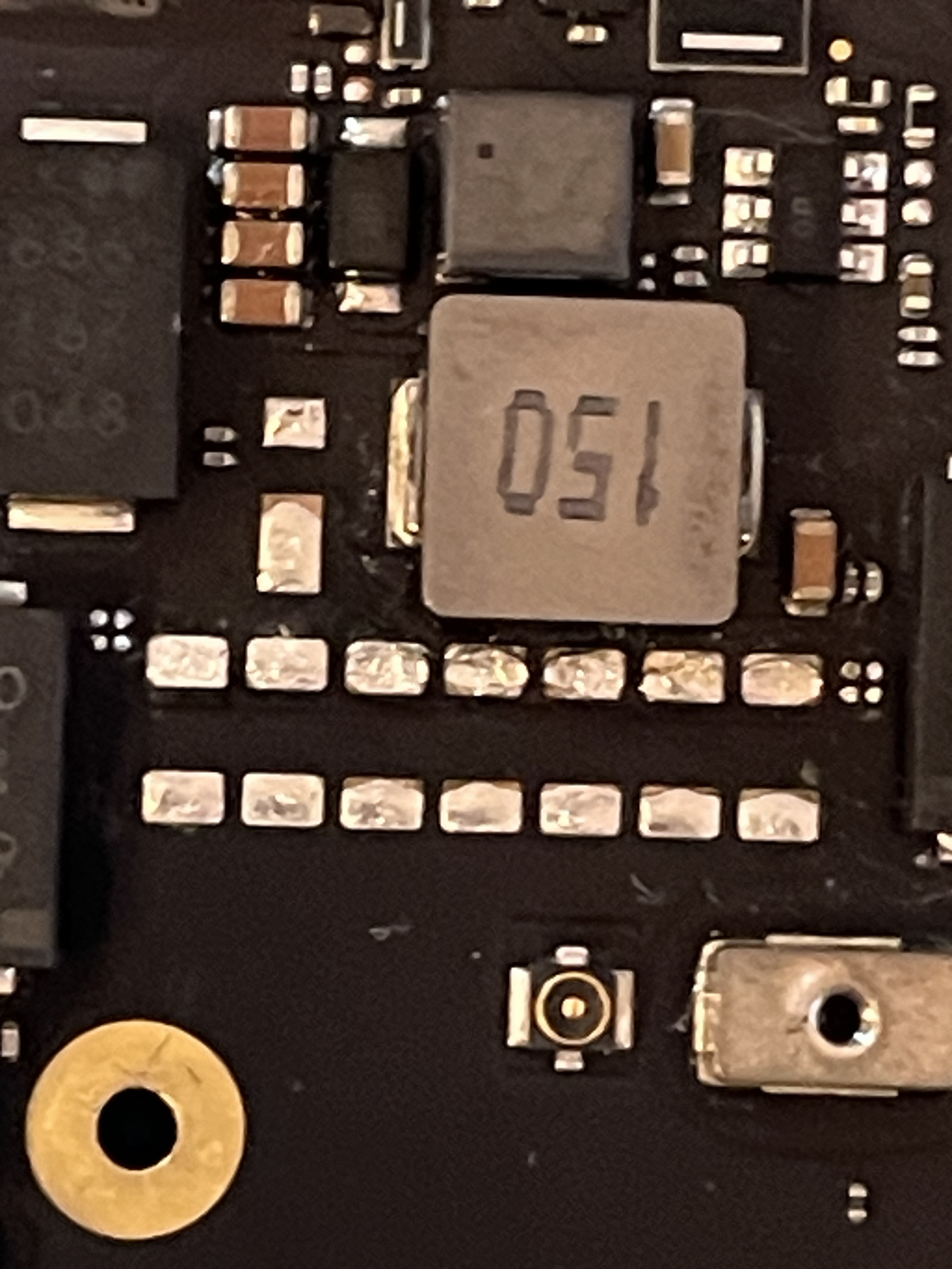

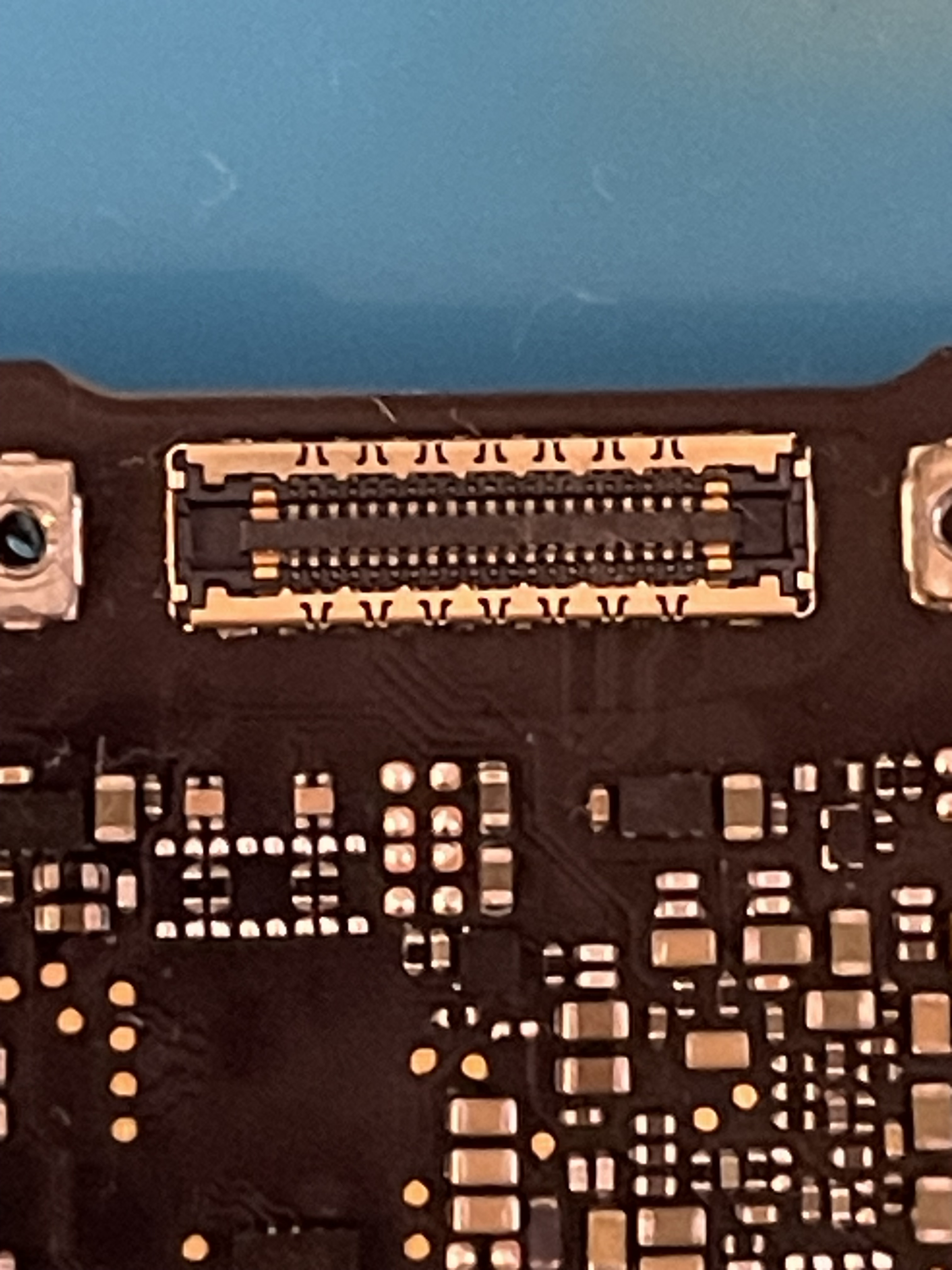

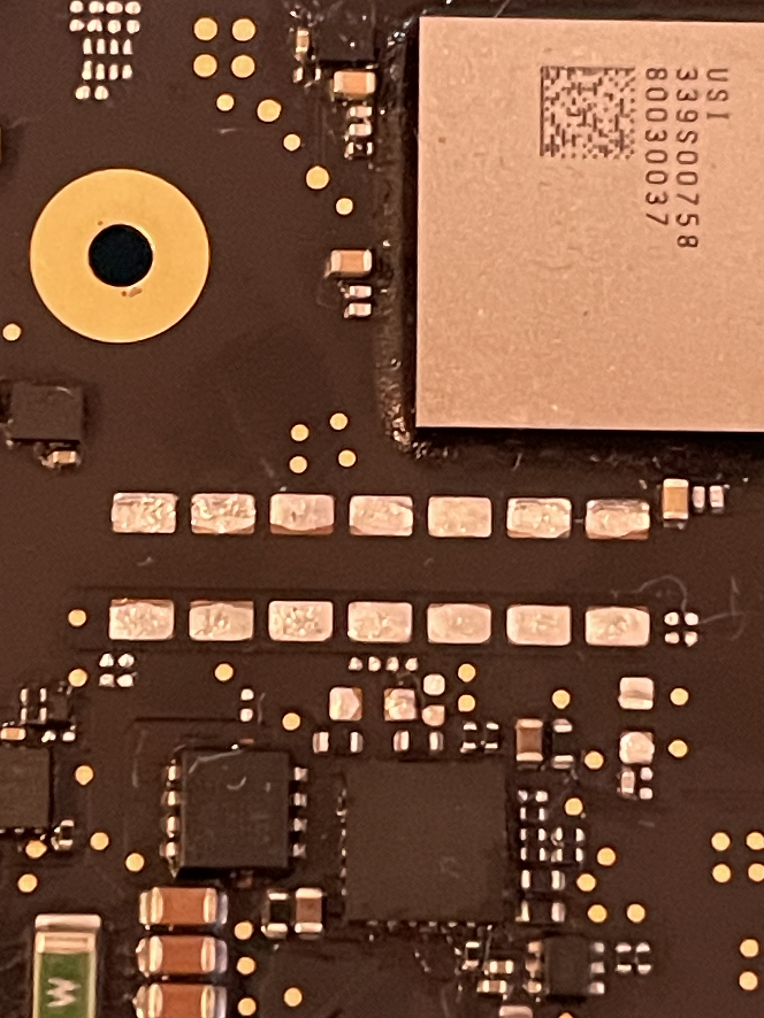

                Thanks, I do already use flex and the schematic for my board. I removed all caps that flex showed to be part of the lcd backlight out. This includes the ones next to the screen connector and the 4 on each side next to the main storage caps.
                I included photos of the board with the caps taken off of all the regions.
                If it is time to stop trying other things I will likely sell it for parts. I don‘t think it is worth to buy a replacement logic board as I probably would have to replace married parts.

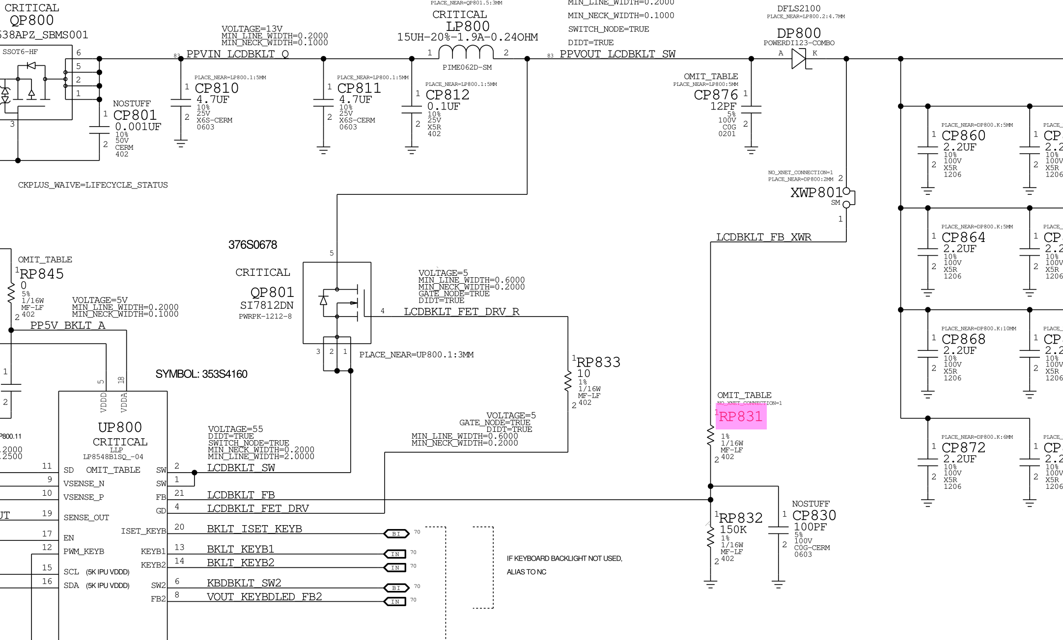

                  Did you also remove RP831 ? It's a resistor that takes the voltage back across XWP801 (internal link) to the controller. If you remove that and the short remains, then I'd say you've got a bad board likely. If the short disappears then look at the FB line parts and the controller
Name:	Screenshot at 2025-01-08 00-40-24.png
