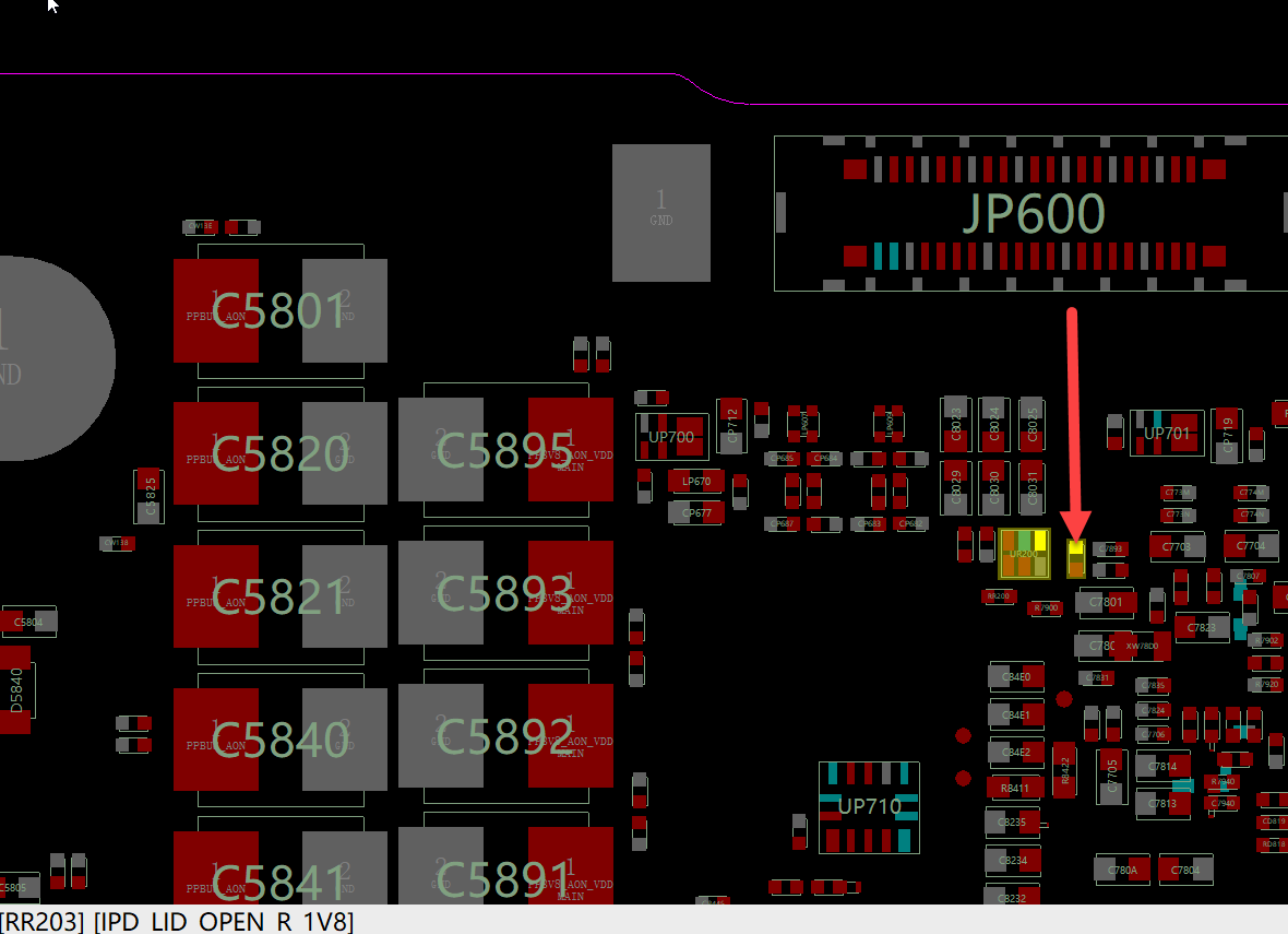

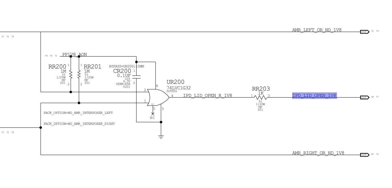

        Post the voltage reading for IPD_LID_OPEN_1V8.
          I'm really sorry, but I can't find where is located

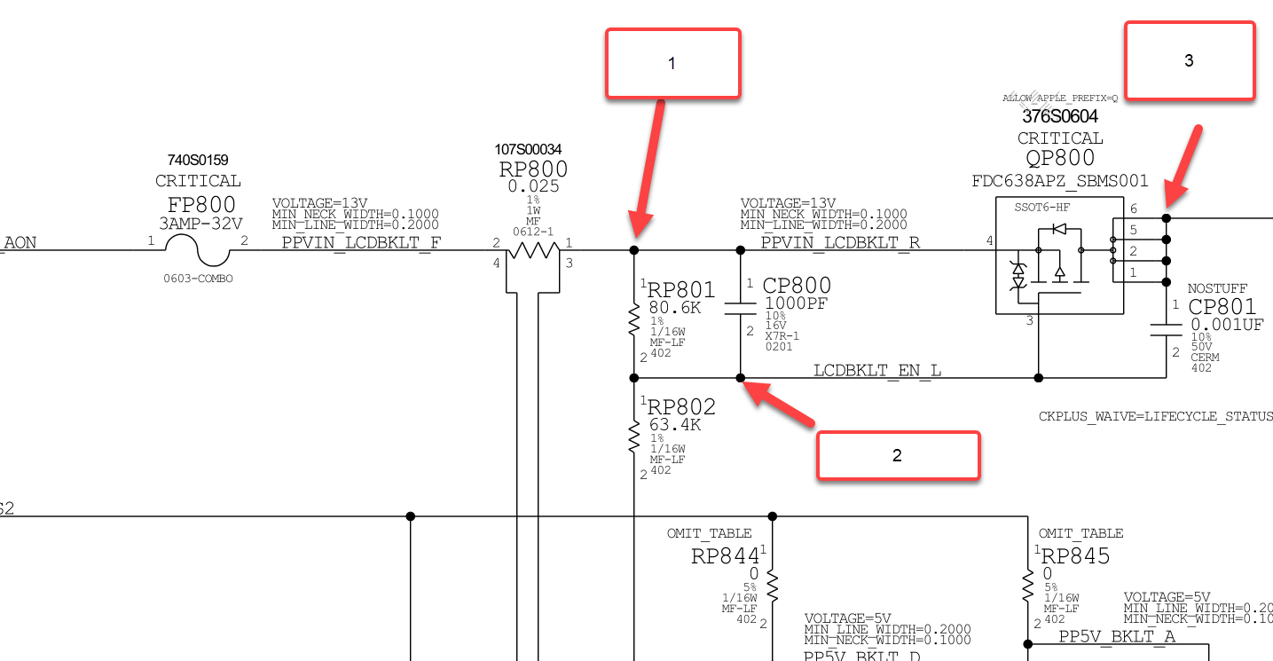

            Re: A2337 new M1 MacBook Air problem Logic Board related, no video backlight 820-0201

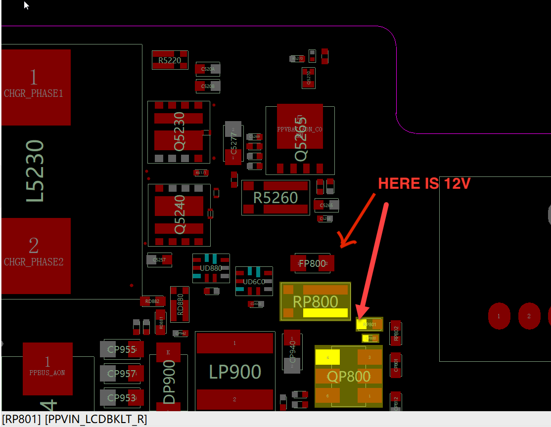

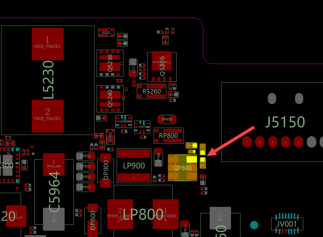

            See attached. This signal is used to enable / disable the backlight based on the position of the top lid.

              IPD_LID_OPEN_1V8 Measure 1.80V . That should be correct right?
                Yes. This is a good reading. This means that the LID sensor is working and the logic believes the lid is in 'open' state. This signal enters U8100 IC which is the same chip that should enable the backlight.
                The backlight may be enabled briefly if it believes the backlight circuit is drawing too much current. That is, perhaps the ENABLE is turned to HIGH but then a current sensor reports that too much current is being drawn for whatever reason and then quickly shuts it off so we are observing a logic LOW or OFF state with the meter.

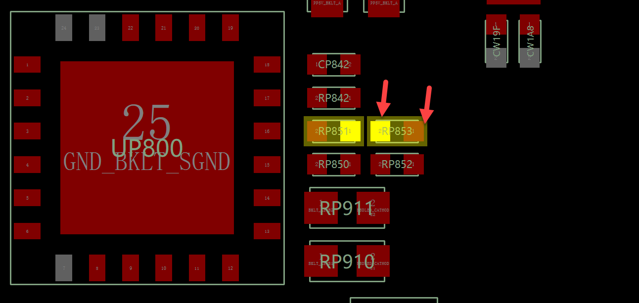

                Place your meter in resistance mode @ 2k scale. No power to the logic board.
                Check and post the resistance for the following:
                red meter probe on one side of RP853; black meter probe on the other side of the same resistor. You should have a reading close to 1k8 = 1,800 ohms.
                If you do not see this value then switch to the next higher scale and test again.
                This is only to confirm if the meter is properly reading the resistance.
                After the above, place your meter in DC voltage mode (30V or higher).
                Check and post the voltage readings for the RP801 & LCDBKLT_EN_L.
                The LCDBKLT_EN_L signal has to be a lower voltage than what is being passed through from source & drain to ENABLE the mosfet @ QP800.
                That is, the switching BOOST regulator @ UP800 pulls the line @ pin 11 (BKLT_SD) LOW to turn on the mosfet QP800 to pass through the voltage from PPBUS_AON.

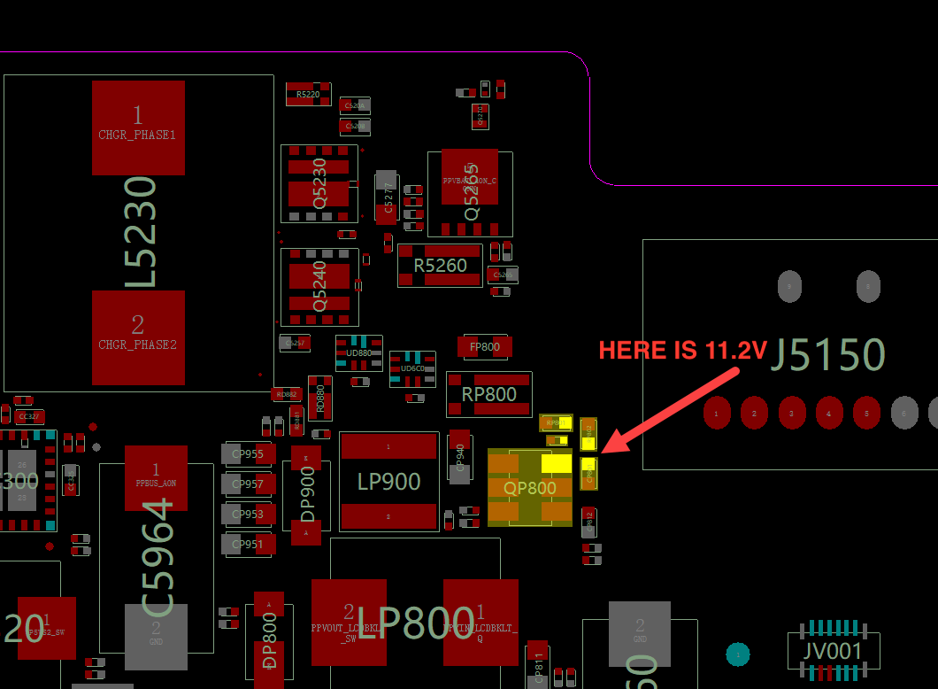

                  here it is:
                  Resistence to ground @RP853 = 1.780 ohms
                  @RP801 = 11.9V
                  LCDBKLT_EN_L = 11.2V (measured in RP802 and CP801) (CP801 is no stuff, right?)
                  Is that difference enought to enable backlight?
                  I also check @DP800 and is 0.3V in PAD A and 0V in pad Z

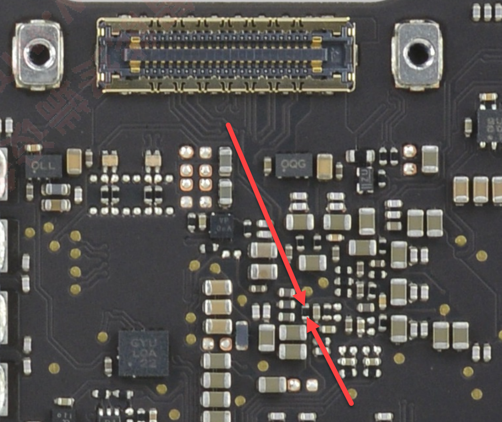

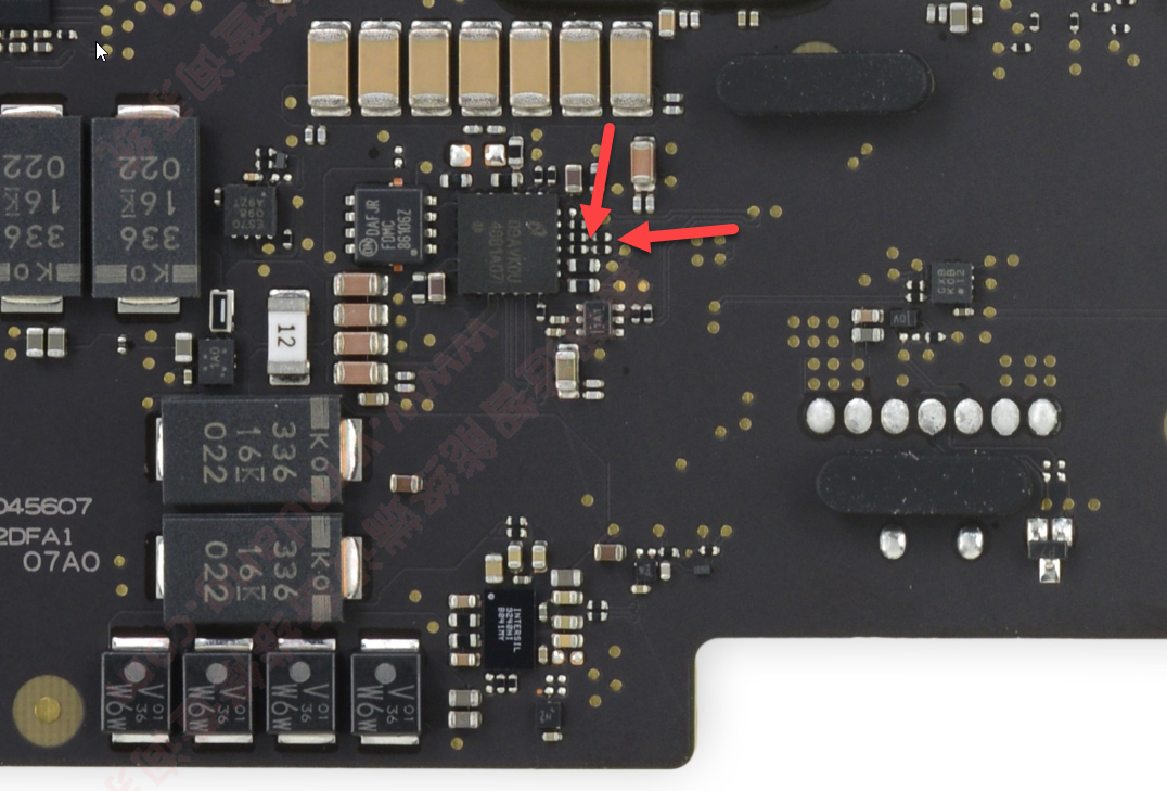

                  I noticed that RP845 show a little sign on it, see attached. Reading is 5.17V on both side
                  Inspecting display connector seems all right
                    @RP853 = 1.780 ohms
                    Ok. Since you are in the 2k scale, this really means the resistance is 1k78 = 1,780 ohms. This is a good reading.
                    Can you review again the resistance to ground using the same 2k scale for:
                    RP842 - check each pad of this part.
                    Red meter probe on the pad; black meter probe to ground.
                    @RP801 = 11.9V
                    Good.
                    Is that difference enough to enable backlight?
                    No, afraid not. This is due to the switching regulator being disabled through pin # 17 which is with a low voltage. This low voltage passes through RP842.
                    At this stage, not sure why the enable pin is low. I think RP842 is off the logic board so the part is not mated with the driver chip U8100.
                    While we could force the mosfet to turn ON, this does not help till the IC @ UP800 is ENABLED via pin # 17 (UP800).

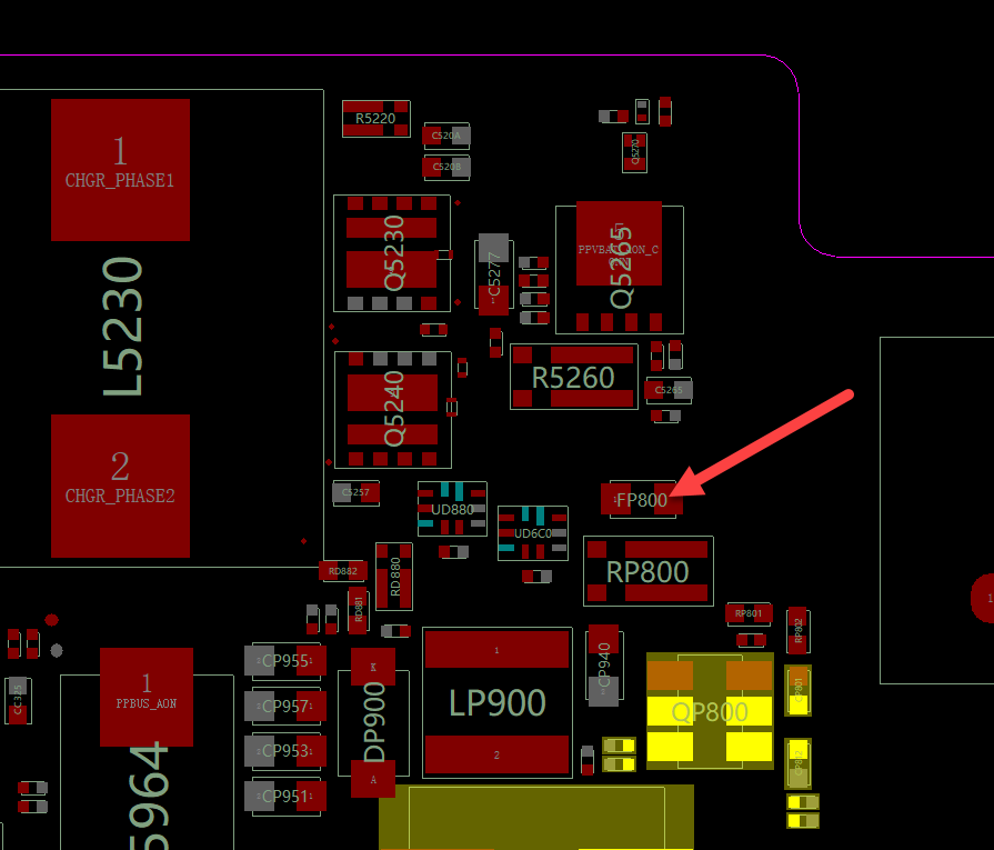

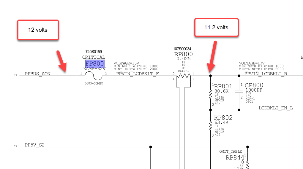

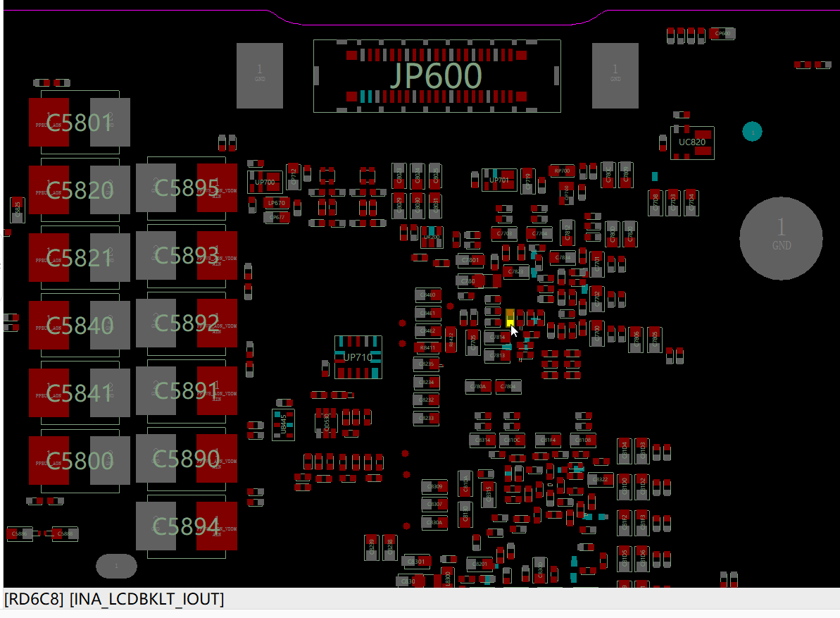

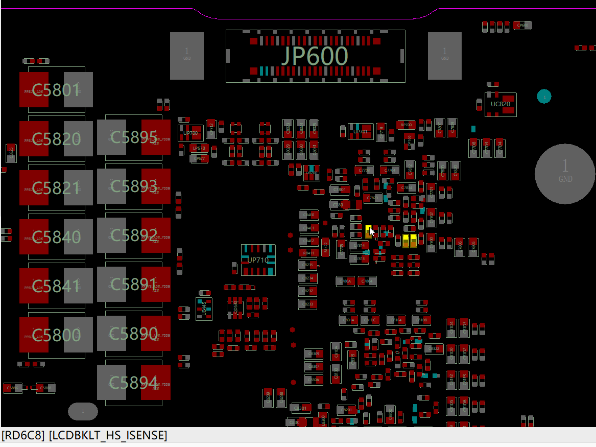

                    What is the voltage @ FP800? You have measured this one before but interested to know the exact voltage that ENTERS the current sense resistor @ RP800 and we know that 11.2 is on the exit. If the difference is too high, this could be causing the trigger of 'too much of a voltage drop = high load' so shut down the IC @ UP800.
                    With your meter in DC 20V scale, measure with great care as the parts are nested inside a dense area on the logic board:
                    the voltage on both sides of RD6C8.
                      Actually RP842 is on the board! I resoldered it back yesterday.
                      Repeating resistence to ground measurement for RP842 give me same results, 'OL' for both sides even if I use the max scale on multimeter.
                      measures for @ FP800 fuse is 12V both sides
                      @ RD6C8 = 0V , both sides
                        Can you confirm that the voltage is exactly 12V at the FP800 fuse ?
                        Downstream the voltage @ RP801 = 11.2 volts ?
                          #32
                          Yes! I confirm 12V both sides of FP800 fuse, and 11.2V on @RP801
                          I just used two different multimeter to confirm it, same results. Variability is 0.01V
                            #33

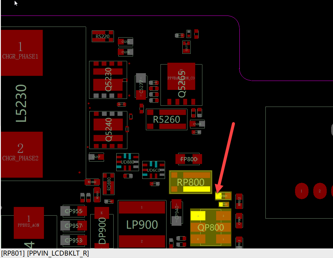

                            Remove all power. Meter in resistance mode.
                            Check & post the resistance to ground @ RP801 (same location as where you read 11v2).
                              #34
                              Resistance to ground @ RP801 = 180.8 ohms (200k scale, if I use lower one 20k or 2k I get ‘OL’)

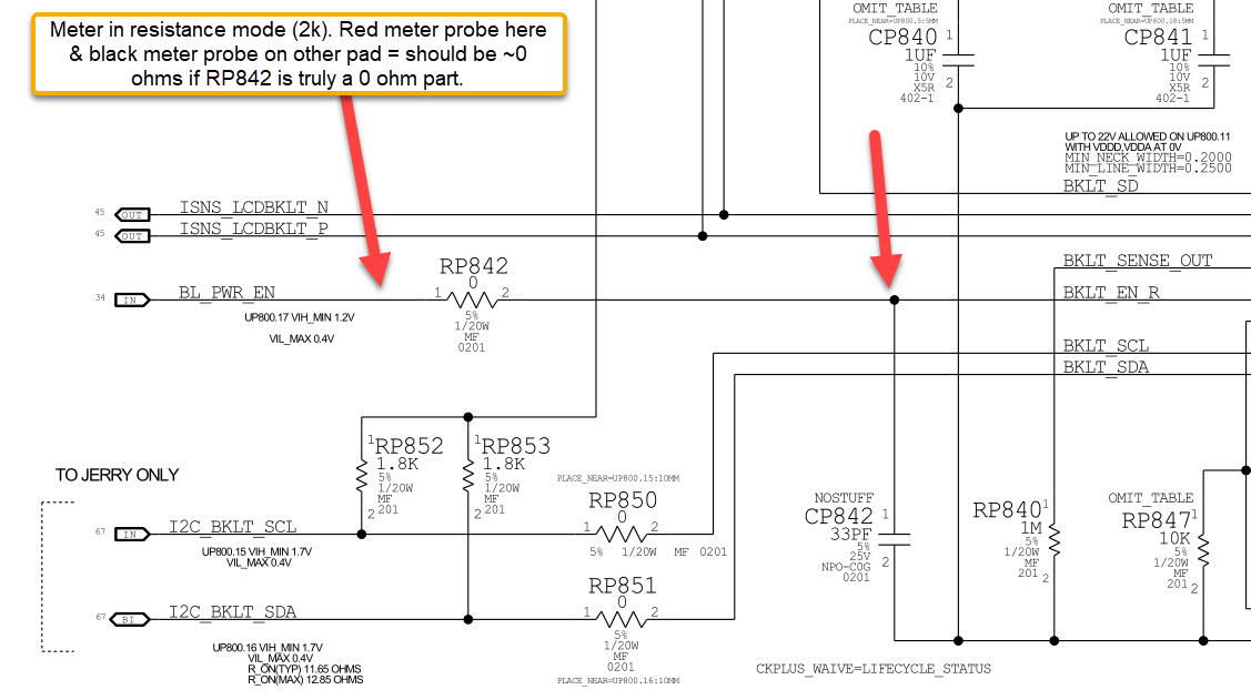

                                In the mean time I re-read measure, but this time whit the good LCD connected to the board, and I got:
                                RP842 = 1.8V pin 1 and 0V pin2 (It should be both pin 1.8V?)
                                CP842 = 1.8V pin 1 and 0V pin2

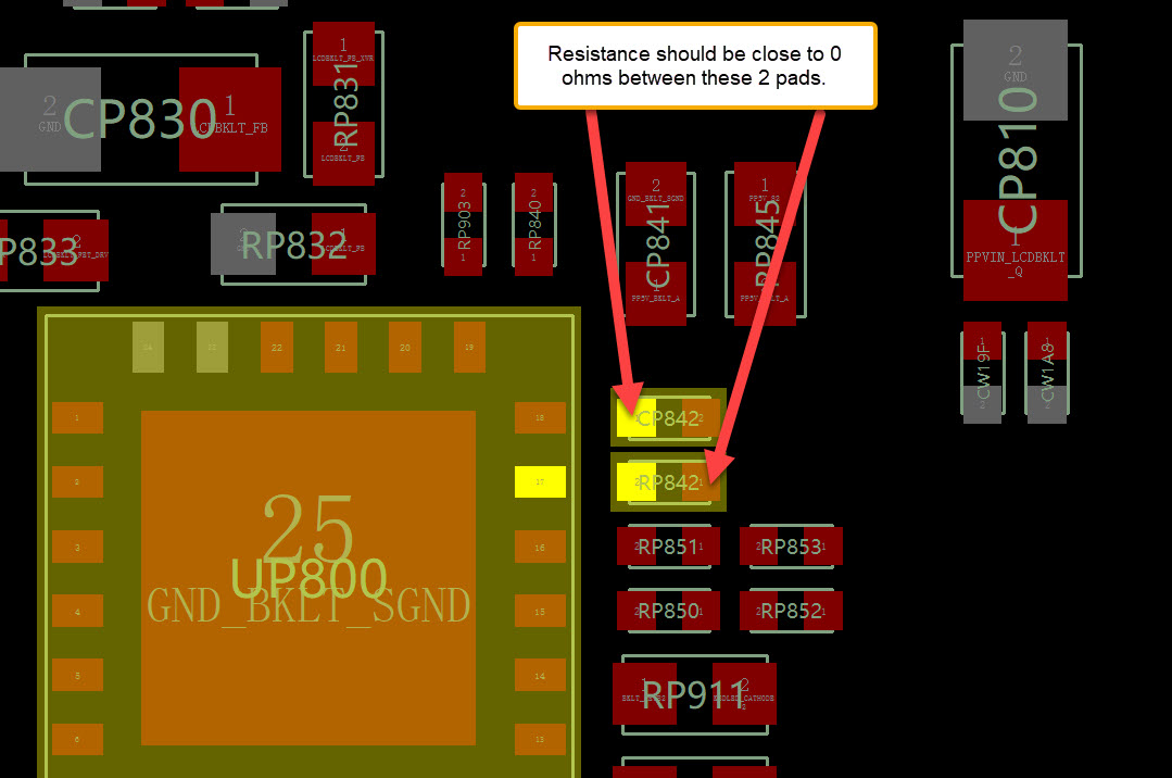

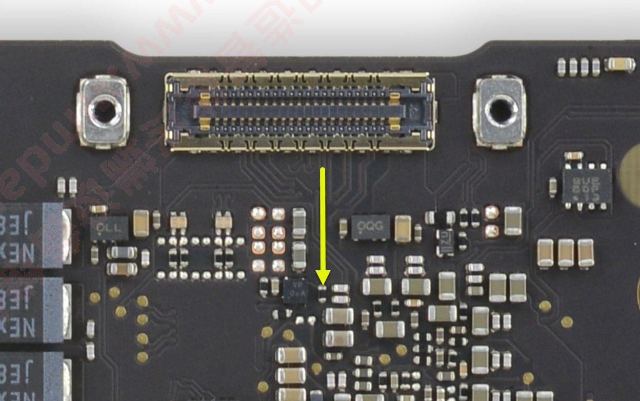

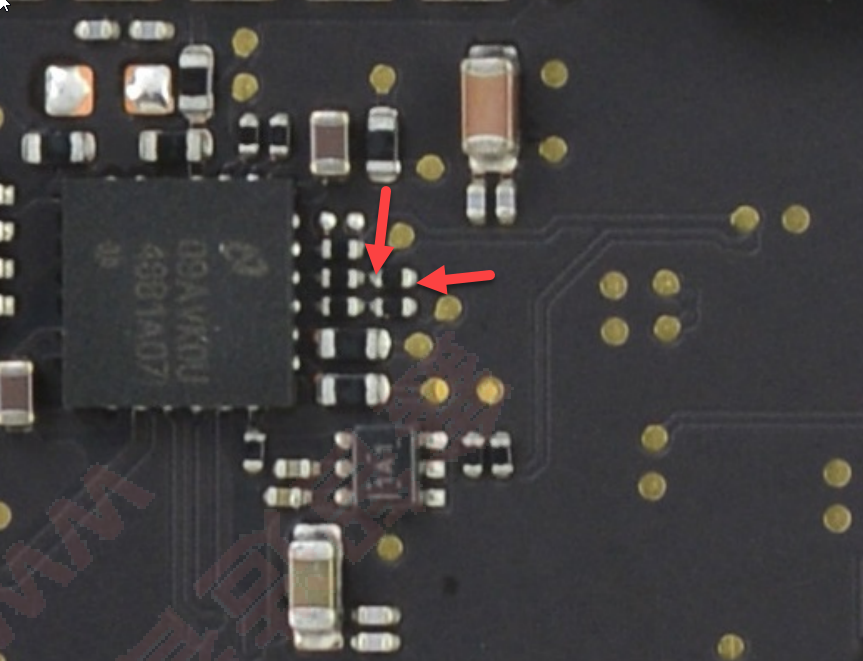

                                  Hi. RP842, pin # 1 @ 1v8 is a very good sign. Continue to use this LCD panel.
                                  See attached.
                                  Confirm the voltage on pad # 2 of RP842. It must also be 1v8 unless RP842 is not soldered properly or is damaged.
                                  Consider to use the meter in resistance mode and remove all power -> check the resistance across RP842 component only (just tip to tip). This has to be close to 0 ohms.
                                  What is the reading ?
                                  Then move to measure from the pad of RP842 and then the pad where CP842 is located. Again, this should be close to 0 ohms unless RP842 is broken or not soldered properly.

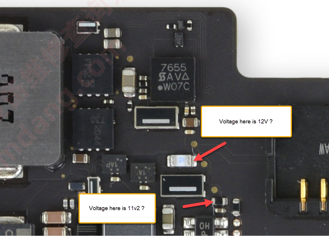

                                  Also recheck the voltage drop that is of concern. At the fuse is 12V but after the fuse is 11v2 ? See attached to confirm you are measuring at these sites.
                                    check the resistance across RP842 component only (just tip to tip) 0.00 ohms
                                    RP842 pin 1 and CP842 pin 1 = 0.00 ohms
                                    RP842 pin 1 and CP842 pin 1 = 480 ohms (2k scale)
                                    No sorry for misunderstanding! In the two parts you indicated to me voltage is 12V! fuse is 12V and RP801 is 12V, my fault.
                                    11.3V is for YELLOW PIN in attached schematics RP802 and CP801 (NOT RP801), in RED PIN RP802 = 10,60V
                                      Ok. The voltage drop makes sense. These are good readings.
                                      Confused about the following:
                                      * ok - good reading
                                      * ok - good reading
                                      * the reading changed to 480 ohms ?? Measured from where to where ?
                                      If you short your meter probes together, the reading should be close to 0 ohms. This is what is expected between RP842, pin # 1 to CP842, pin # 1.
                                      First confirm the resistance (no power to the logic board) is indeed about 0 ohms. Only then proceed to apply power to check that 3v3 is present on either side of RP842. Since RP842 mates with CP842 (pin # 1), you can measure @ CP842, pin #1. This voltage is important.
                                      If the resistance is NOT 0 ohms then RP842 is not soldered properly or is defective.
                                      Can you confirm again ? Respectively, when RP842 shows 3v3 on pin #1, this same voltage must carry through onto CP842 since it is a wire conductor between these 2 points. With the 3v3 voltage to the switching power supply, it will serve as the proper ENABLE signal.
                                        Again sorry for confusing pin, I was doing faster.
                                        This is right
                                        RP842 pin 2 and CP842 pin 2= 480 ohms (2k scale)
                                        the resistance across RP842 component only (just tip to tip) is 0.00 ohms
                                        I re-soldered RP842, that mean is defective I guess. Can I put It upside down or is better to just put a jumper?
                                          #40
                                          Yes, RP842 is only a 0 ohm resistor. So you can remove it and apply a blob of solder to act like a short circuit.
                                          The voltage on one side of RP842 must be the same as on the other side since this is just a short circut.
                                          Once you are 100% sure of the soldering between these 2 pads only, apply power and the 3v3 voltage should reach the switching power IC (UP800) to ENABLE it.
