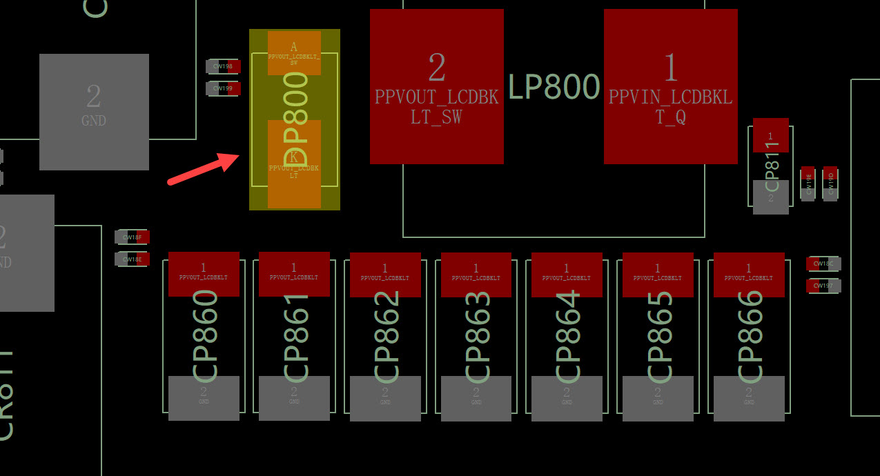

    Originally posted by mon2
    Yes, RP842 is only a 0 ohm resistor. So you can remove it and apply a blob of solder to act like a short circuit.
    I've shorted the two pin, and now with LCD connected to the board I have 1.80v in RP842 in both side, but I guess the switching power IC (UP800) is not ENABLED as backlight still don't work.
    It can depends on missing components I removed in the CAMERA circuit?

      #42
      Re: A2337 new M1 MacBook Air problem Logic Board related, no video backlight 820-0201
      Do place the filter back on for the camera to complete the circuit. A filter is to clean up the voltage rail but for this testing, you can use a solder blob.
      At this time, believe that your backlight IC should be replaced. The upstream enable signal is present and is trying to enable the IC but the IC is not performing its BOOST function to offer the 25V++ for the backlight signal.

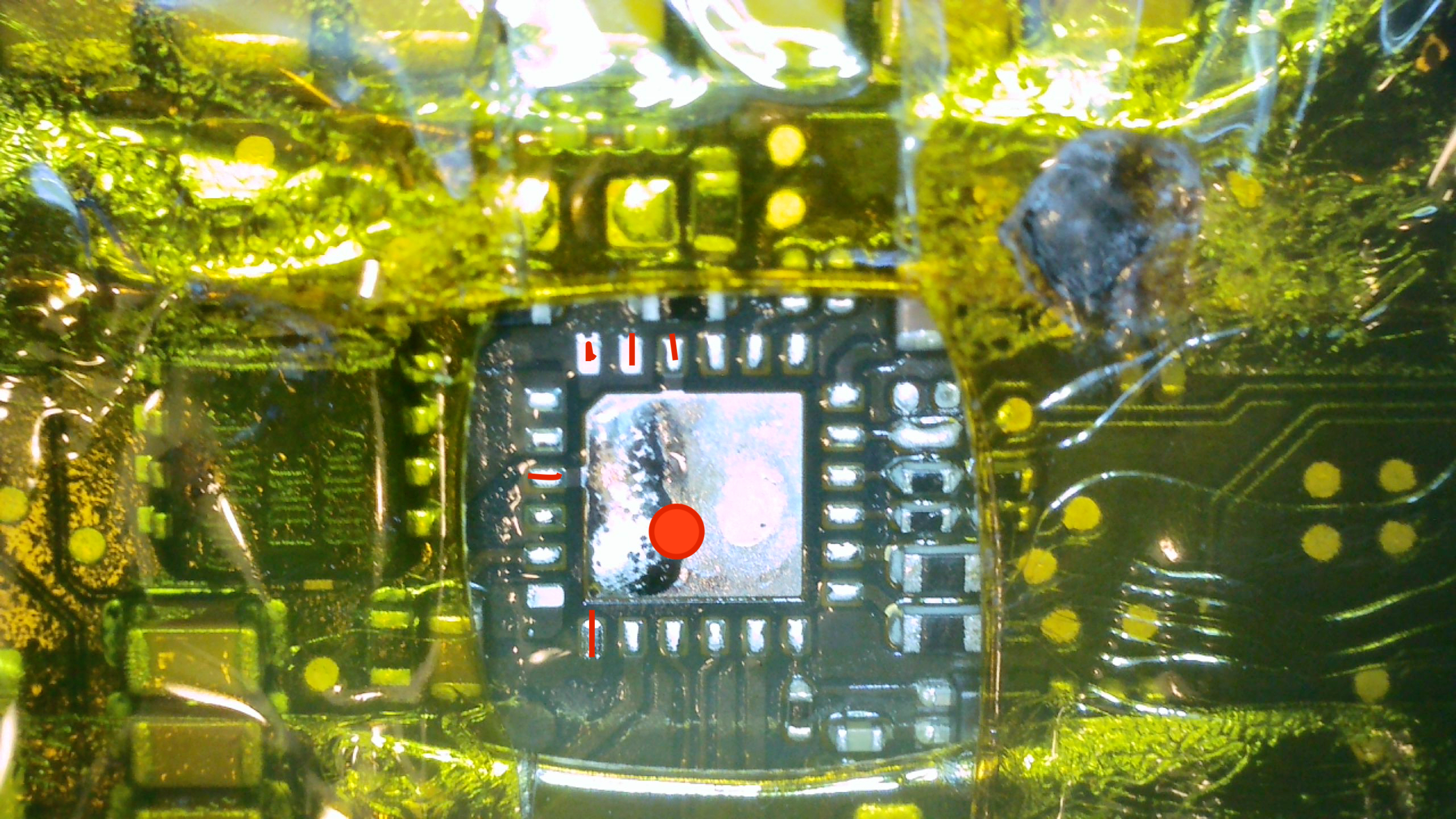

        #43
        Actually I miss also LP670. Do you know where I can find this backlight IC ?

          #44
          1) LP670 - is available from Arrow / Digikey / Mouser Electronics.
          (update link for Arrow for a suitable part @ LP670):
          https://www.arrow.com/en/products/bl...-manufacturing
          Do you or someone you know have a VAT # ? If yes, then it should be possible to drop ship these to you from Arrow.com. Without a VAT #, unable to ship these to you from Arrow.
          2) The backlight IC is available from Aliexpress:
          LP8548B1SQ-04
          https://www.aliexpress.com/item/3285...rch-mainSearch
          * this is a store we have used in the past with good ratings
          * recommend to pick up at least 2 of these parts as they are not available through mainstream distribution
          NB: Just checked and apparently Ebay (Napoli) has some seller who is carrying this part as well - found through Google
          3) Are you comfortable with the replacement of this QFN packaged IC ? If not, recommend to work with a local repair shop of cellphones or similar. Should only take 15-30 mins (max) to replace this IC.
          Need kapton tape to protect the surrounding parts so they do not fly away. Flux the site and hot air tool to remove and replace. Tweezers to remove / apply the parts.

            #45
            Thank you very much for all the advice and walkthrough explanations. I’ve just ordered this IC backlight. I’ll let you know when arrives.

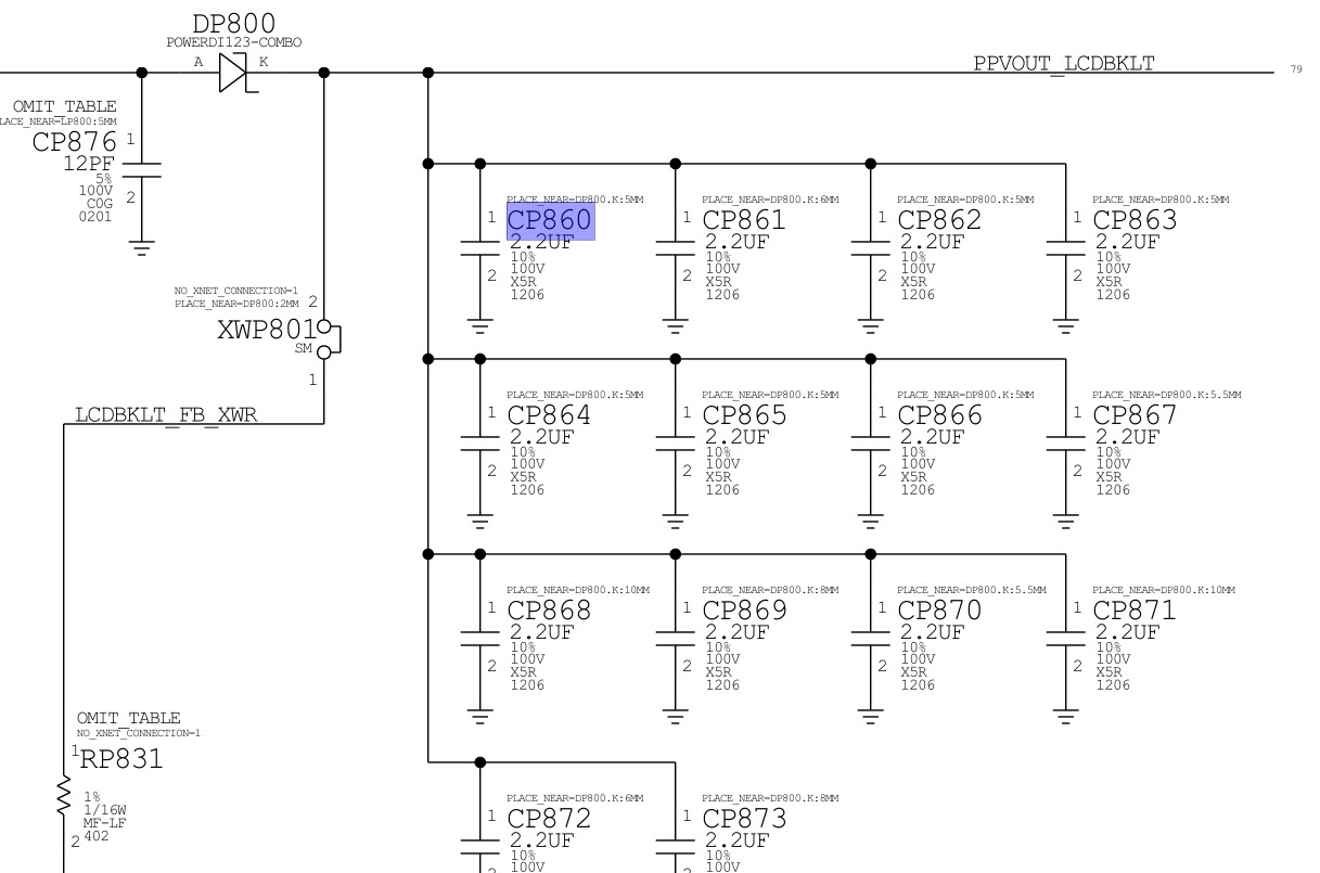

              #46
              If you suspect a capacitor to be shorted to ground, check the resistance on that rail.
              Remove all power anytime you are measuring the resistance of a component.
              Red meter lead on one capacitor pin; Black meter lead to ground.
              If the RED lead is on the ground side of the capacitor then expect ~0 ohms since this will be direct connection to the black meter lead which is also ground potential.
              A shorted cap will show very low resistance but low voltage rails are often with low resistance, by design. Best to measure and post any such locations for a deeper review.
              Do look for off color caps / caps with cracks, etc. that may indicate a damaged component. If you are suspecting such a defect, hot air off the part and then check the resistance again for that cluster of caps.

                #47
                Hello. I've replaced components on camera circuita and now it is perfectly working as expected.
                I've replaced also the IC backlight, but unfortunately still no backlight.
                When IC was off the board I checked the continuity in the pads looking for short, I've reported what I found on the attached image. I put red color on the pads that show me 0.00 ohms resistance, all the other was 'OL'
                PS: now CP860 cluster caps show solid 0.00 ohms resistance. Do you think my be worth change also other surrounding of prevosuly damaged components of the camera circuit?

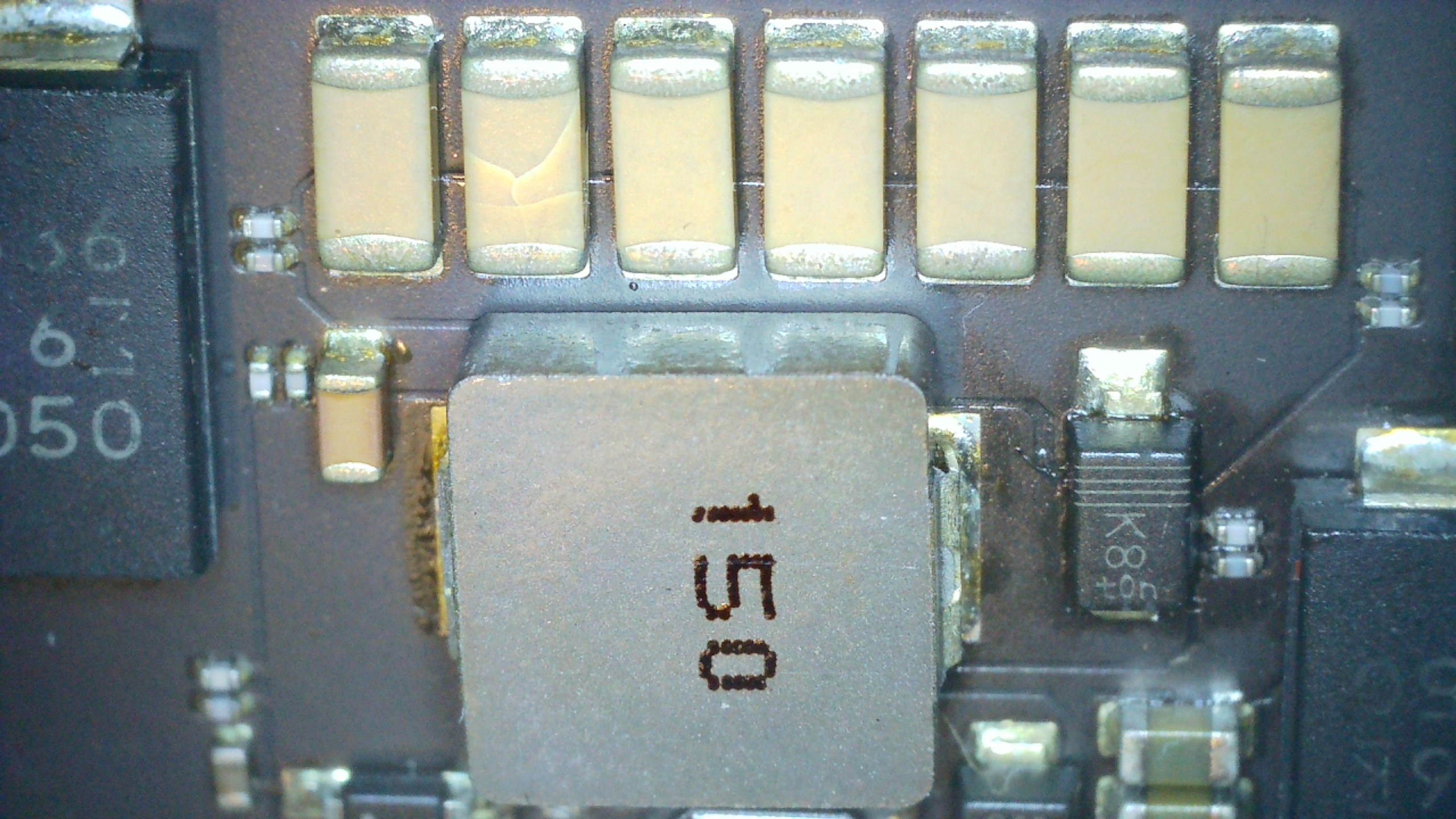

                  #48
                  1) The red marked pads that are showing 0 ohms to ground are correct. Each is a ground connection to the underside metal belly pad (heatsink pad). No fault here.
                  2) To debug the short on the bulk caps for this boost power rail, use the hot air to lift up one leg of diode D800 (see attached on the location).
                  Once you have lifted up this one side (either side of the diode is ok), do not apply power to the logic board but check the resistance to ground once again for the bulk caps. Do not connect a LCD panel during these tests.
                  We need to be sure the fault is not in the LCD panel so it will remain disconnected.
                  With this procedure, the shorted component is narrowed down to this cluster of caps.
                  Post the resistance for the same cap cluster with the diode out of circuit.

                    #49
                    Look what I've found! Cap removed, short gone. It was not craked before today, maybe multiple heating give this last breath
                    it's a 2.2uf 10% 100v capacitor right? Unfortunately my donor board does not have one.
                    The backlight screen works installed in other machine, so it's not bad for sure

                      #50
                      That looks like the bad actor on the board. Remove it and check the resistance again. Biting my nails in anticipation of some good news. We could all use it by now

                        #51
                        resistance to ground CP860 = 168.5 ohms (200K scale).
                        • mon2
                          • Dec 2019
                          • 14662
                          #52
                          That is ok since you are in the 200k scale so the reading is actually 168.5Kohms = 168,500 ohms. Much much better than the 0 ohms from before.
                          Be sure of this value - check it a few times. Then place back the diode if it was removed.
                          Then check the resistance again to be sure it is a high resistance.
                          Then attach the LCD (no power!!!) - check the resistance again on this cap cluster.
                          Finally, power up to check the results of the backlight operation.
